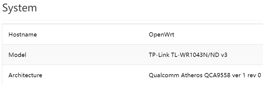

the Qualcomm router was Linksys WRT1900AC
My Wii U connects just fine to this:
Also according to https://wiki.dd-wrt.com/wiki/index.php/Linksys_WRT1900AC your router has a Marvell chipset and not an Qualcomm/Atheros one. Marvell is known for drivers full of bugs and even worse, there's no more support so they'll never get fixed:

So please stop giving bad advices when you clearly have no idea what you're talking about.
