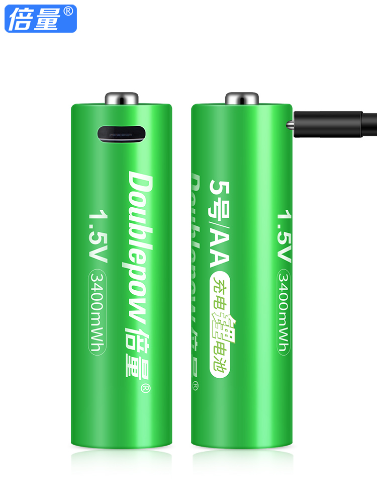

I Have been using these and very satisfied with their performance
It can be charged with regular micro-usb cables (those used to charge android phones) and its capacity is high at 3400mWh. Given with the low self discharge rate of lithium batteries, just keep a set of spare and you can be worry free.
The stable 1.5v output make them compatible with all devices that use AA batteries. My shaver for example, won't run on NiMH batteries but runs well with these and it stays strong within the life of the batteries ( It loses power gradually even with alkaline batteries).. I have never checked the real capacity (its from China) but its been running for weeks on my shaver already.
BTW, Jugee is from China too!
