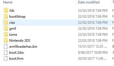

post a screenshot of the ROOT of your SD card
Sorry about the delay. See attached screen shot with everything on it now.
Well this is a great start, the first time something different has happened. However all i get is a black screen, either with start or select or nothing pressed. If i pull the sd i can get back into luna
