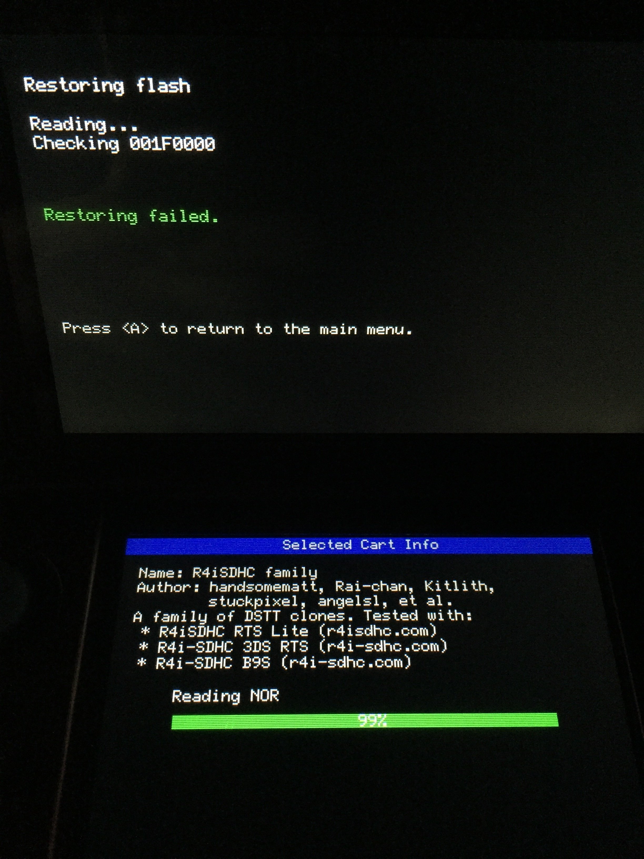

I have a similar problem, although its the reflashing firmware that Im having trouble with. It always says restore failed. Maybe Im not using the right one for this card? Any help would be appreciated.

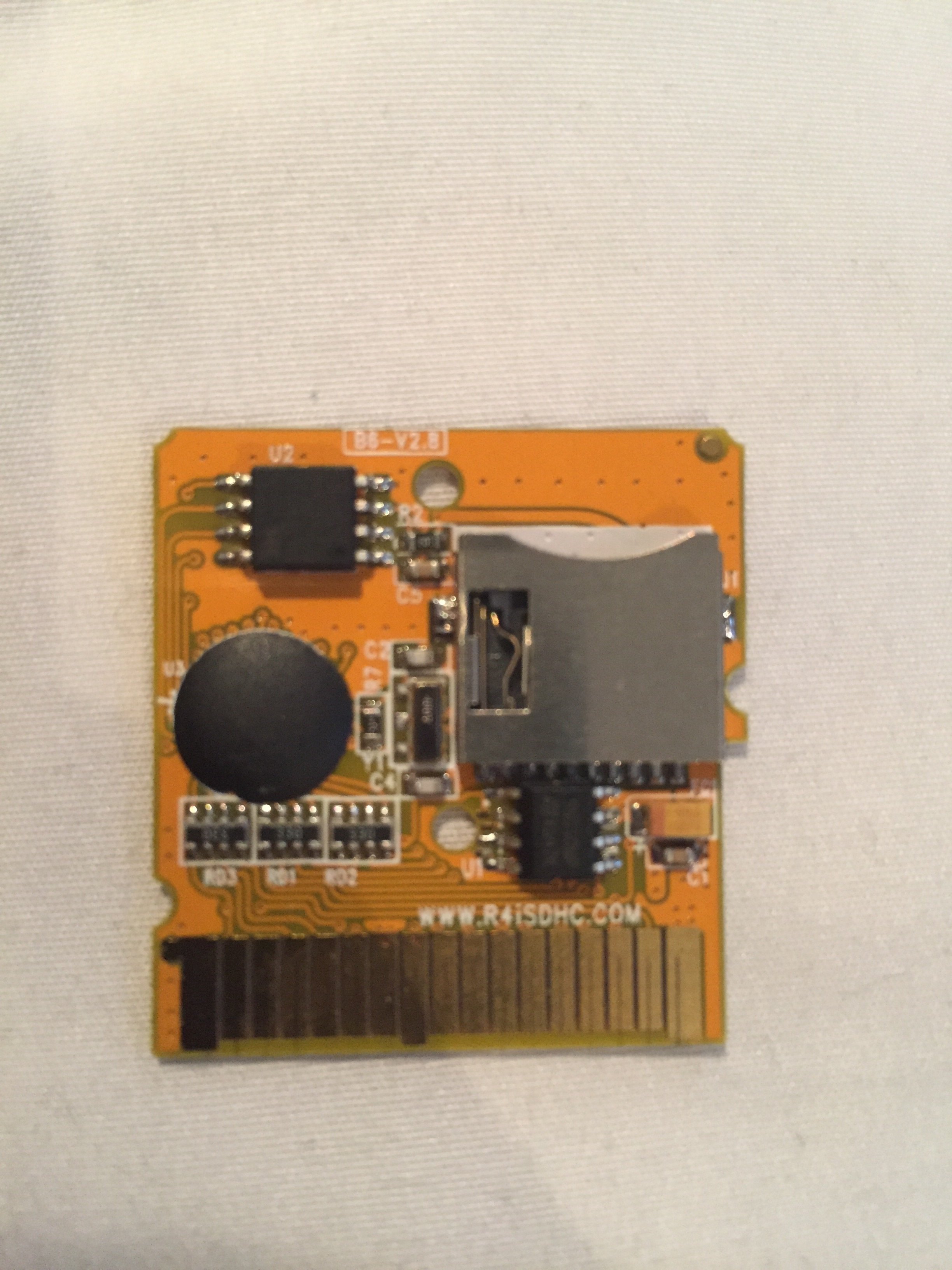

I thought I did but its not on the micro sd card from my r4 card or my system card that I can find. If its not fixable I will just order a newer one, this one was fairly inexpensive. Would be cool to fix though
Heres a picture of the inside of the card it it helps

Did you happen to make a backup before flashing it for NTRboot?
I made a copy of everything that was on my SD card before flashing it for NTRBOOT. Is that what you mean? And I've tried to just copy those files onto a sd card and put it in the flashcard. But have the same problem.
Also the guide says to install Luma3D but how do I know it's installed?
He means a backup of the original firmware on the R4 card itself, not the microsd card in the R4.
Im having a similar problem, but mine fails halfway through reflashing the backup I downloaded. Mines either the wrong firmware or I bricked my card. Although Im still able to flash ntrboot to it again so Im kinda lost.

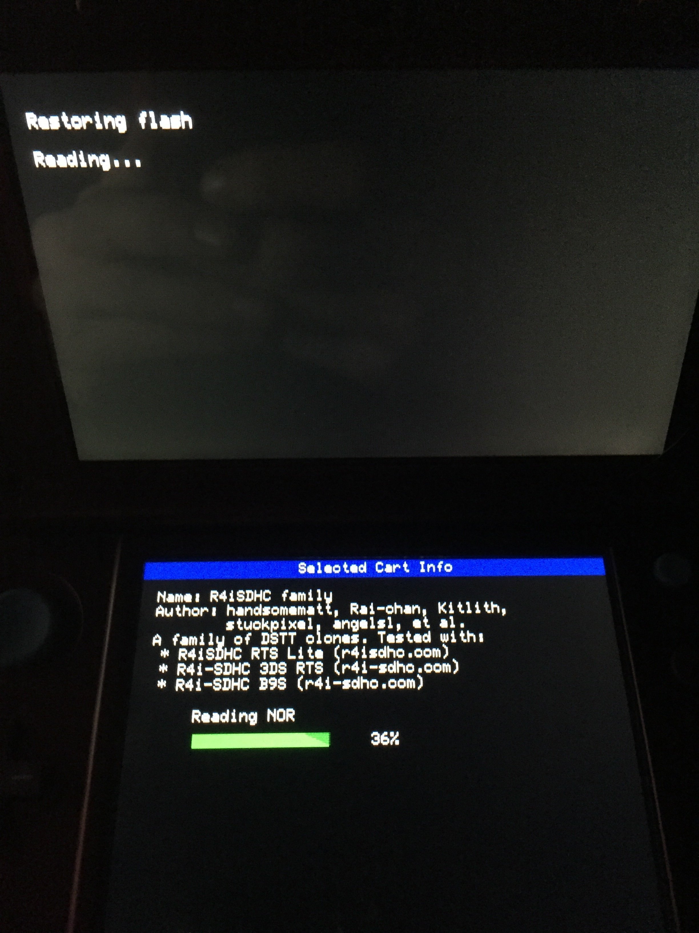

Trying it now, fingers crossed X.X
No go :(

So I realized my mistake. I was putting the flashrom backup and flasher files on my flashcard sd card. I tried it on the 3DS's sd card and was able to properly get the red screen and to restore. But now when I try to go to my flashcard, it goes white screen, then blue screen on top and black on bottom. Should I try with different hardware revisions? Will it hurt if I restore again? Is there something wrong with my flashcard?
Another update:
I realized that I had to get "WOOD R4 V1.64" from the manufacture website and the files had to over-write the "V1.51C Kernel" files in the flashcard sd card. Now everything works and my NDS files boot up just fine. I think I'm all done for now. Thanks for the help.
