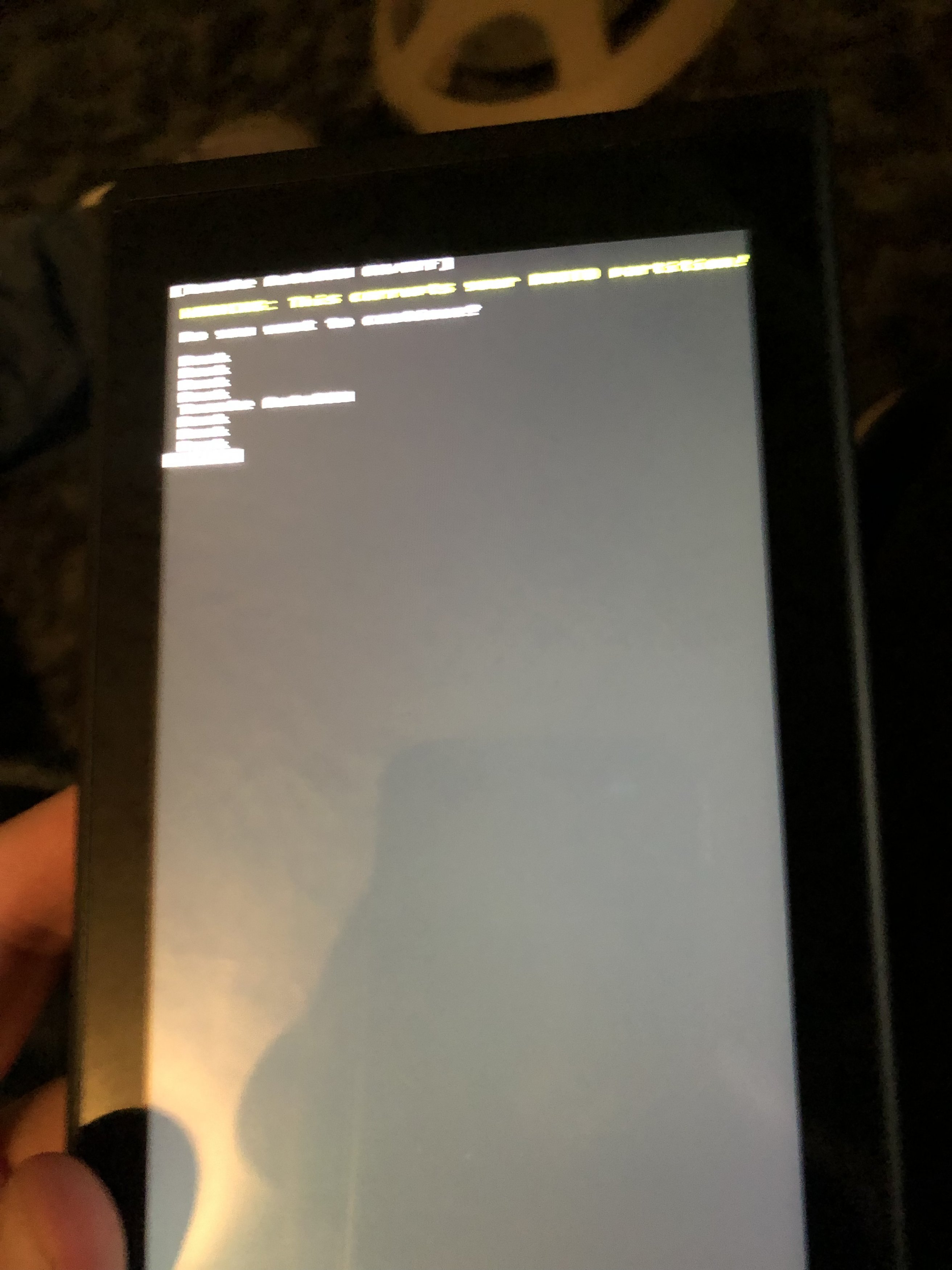

I didn't even know the Switch had a back screen. :huh: You should probably post pics of your problem. I doubt people will be able to help you with just your descriptions.
suck on here i cant get out of it
