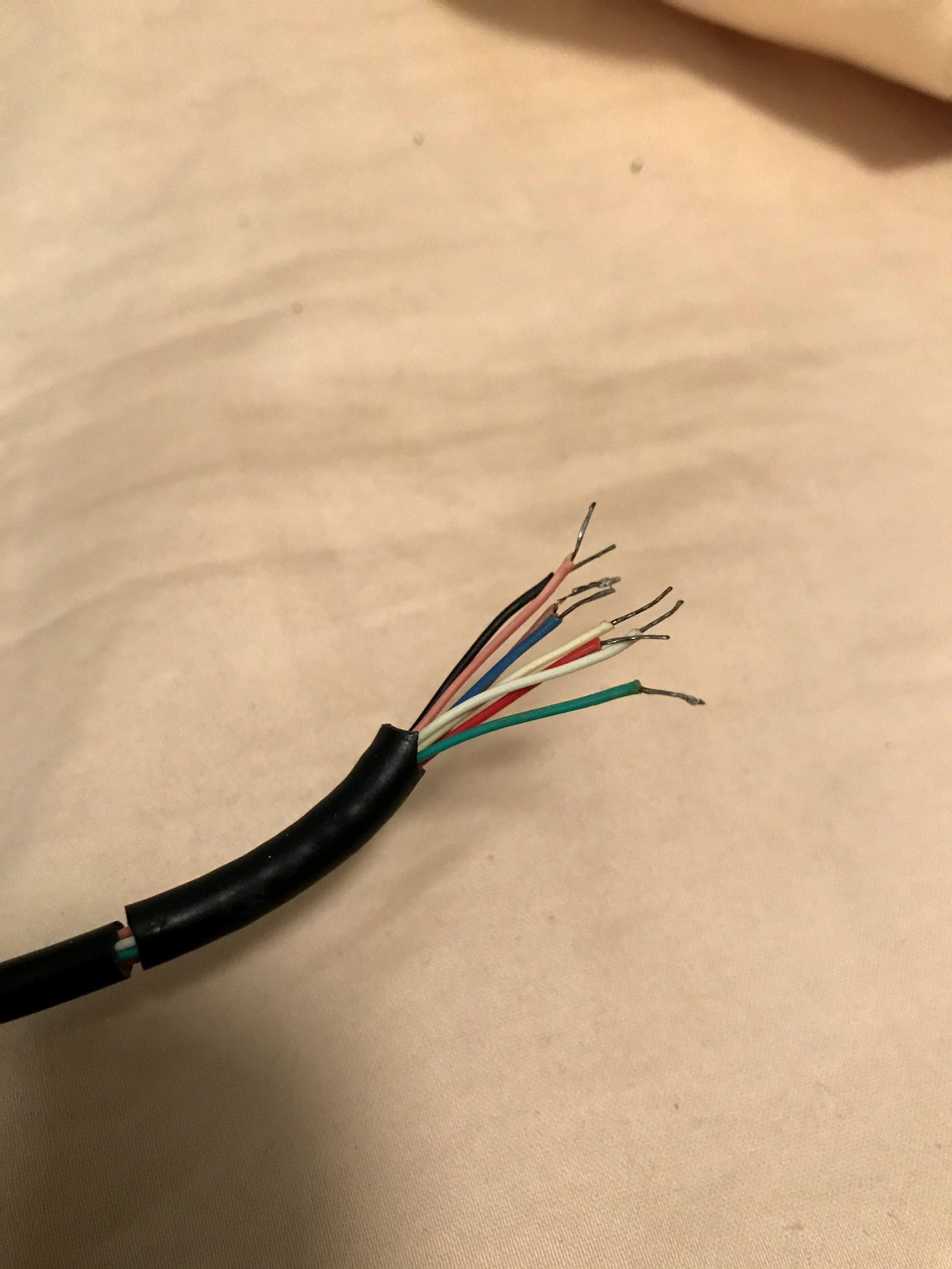

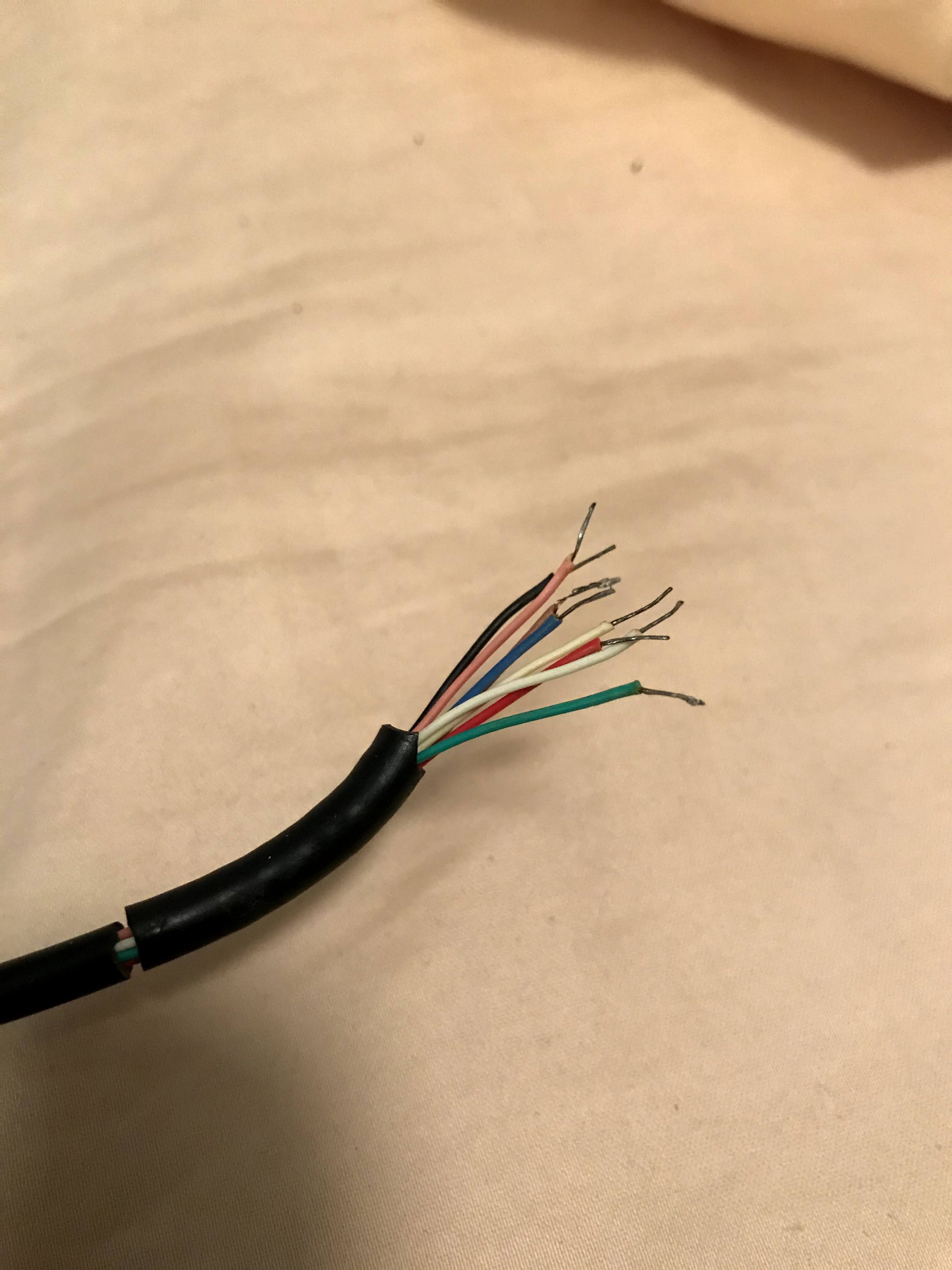

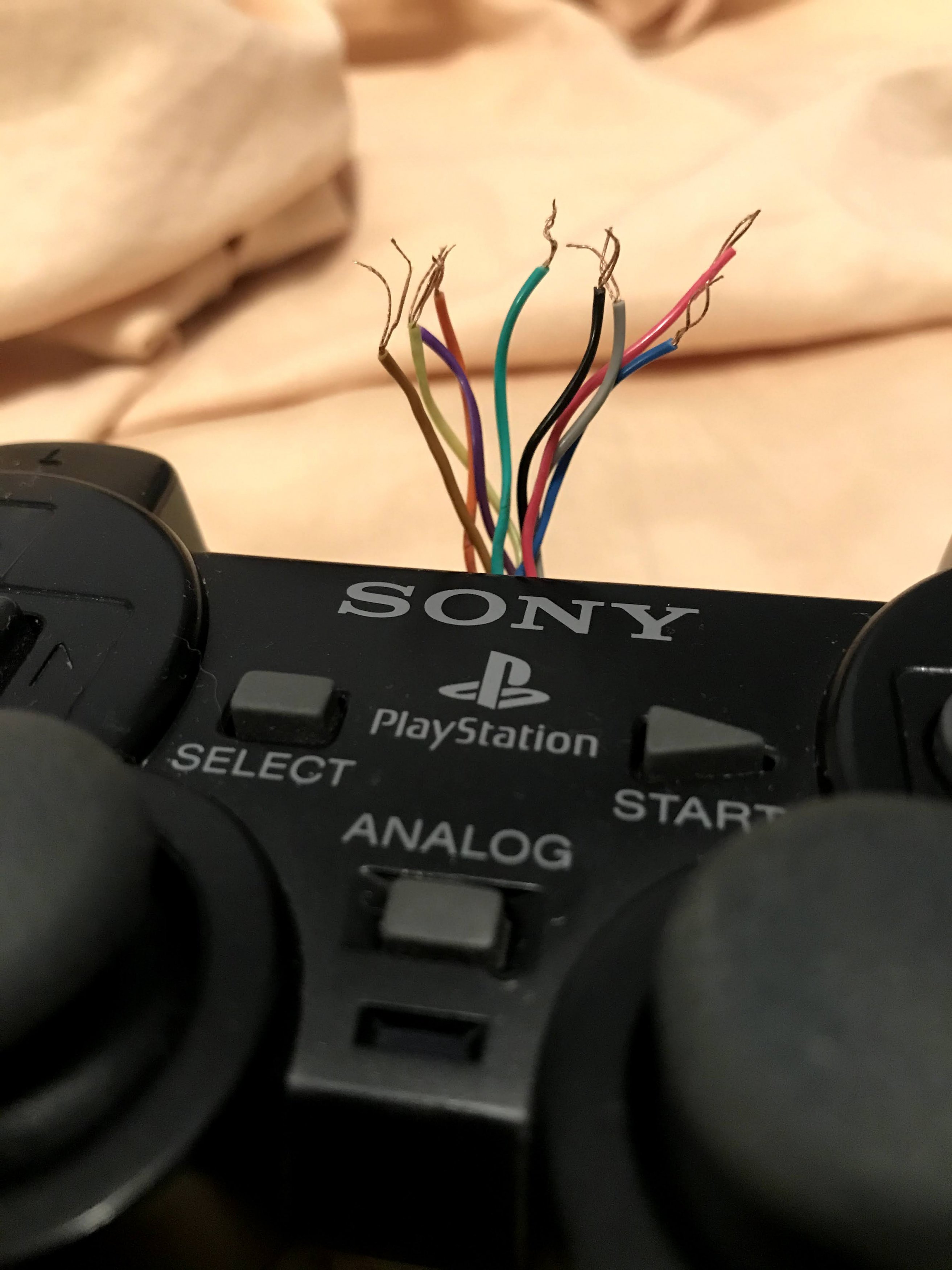

So I got this DualShock 2 controller with a damaged cable, so I ordered a new replacement cable to replace it. The thing is, it only has 8 cables while the original controller has 9, and also, not all colors match. Is there some kind of guide on where to solder the colors that don't match, especially since it only has 8 colors as any other third party controller?
Edit: Here are some photos:
The original controller's colors:
The replacement cable's colors. Notice the very faint yellow next to white, also one color that's very hard to tell behind blue:
Upon further inspection, the one color that is missing is purple. Is this cable worth using to solder it to the controller? Thanks in advance.
https://store.curiousinventor.com/guides/PS2
Apparently, there's a wire that's not being used.
The white.
Check the pinout.
Do you still have the other parts? (old cable)
If so, check continuity with a multimeter, so you can label which cable goes with what pin. Then, just translate that to the new cable, done.

also, colors don't really matter, it is possible that the thied party controller used a different color for each wire, yoou bwmetter check each wire with the pin in the control plug.
