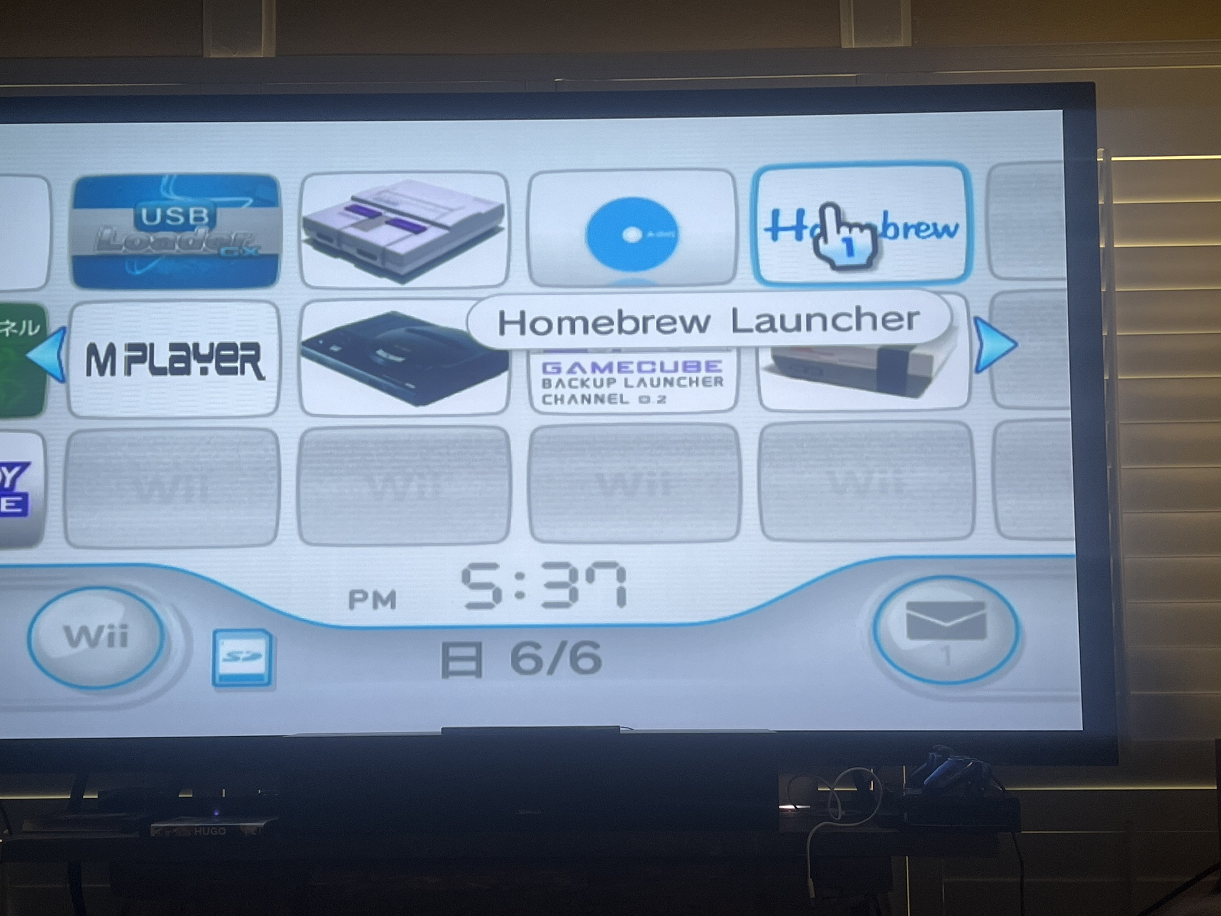

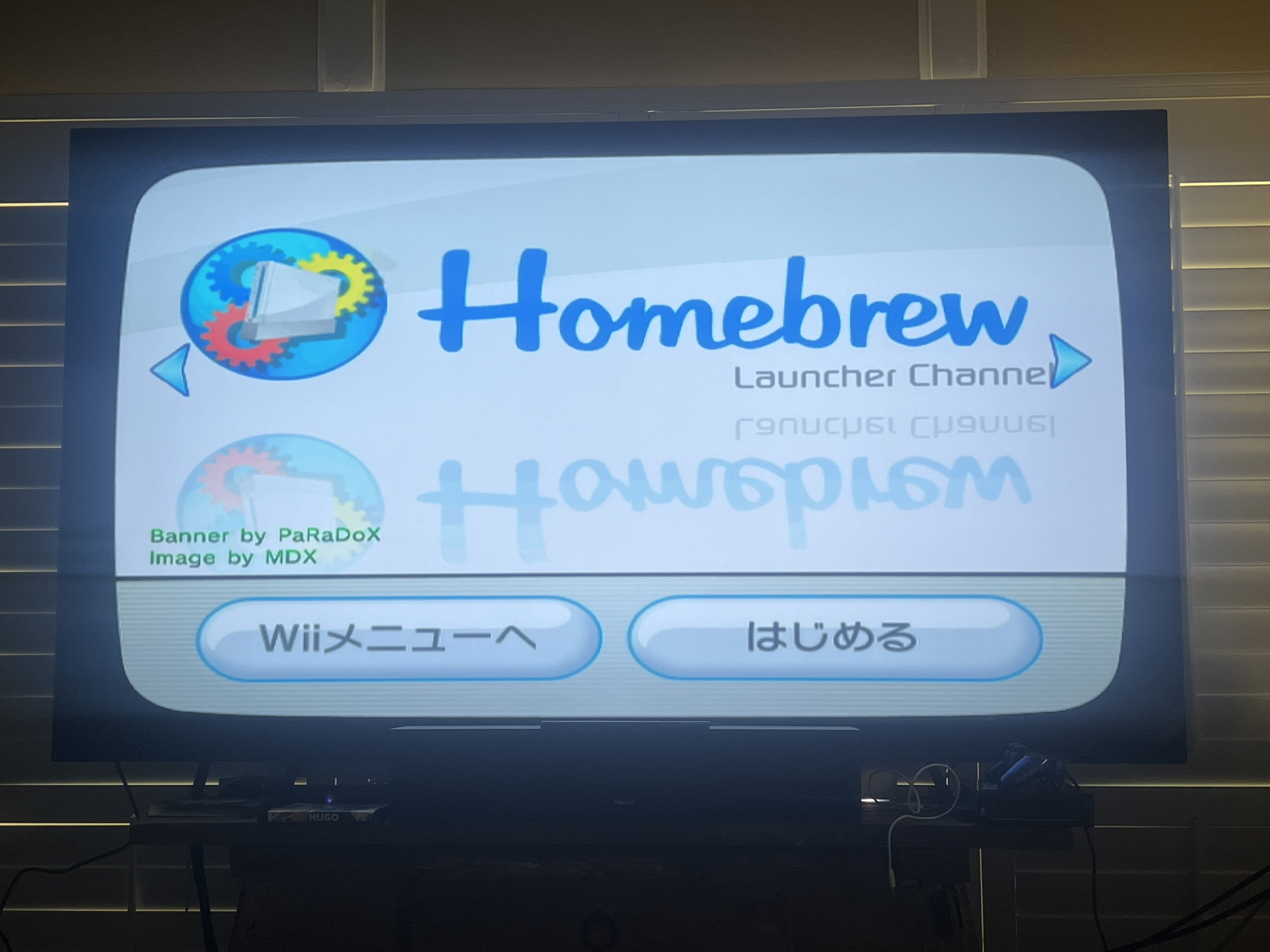

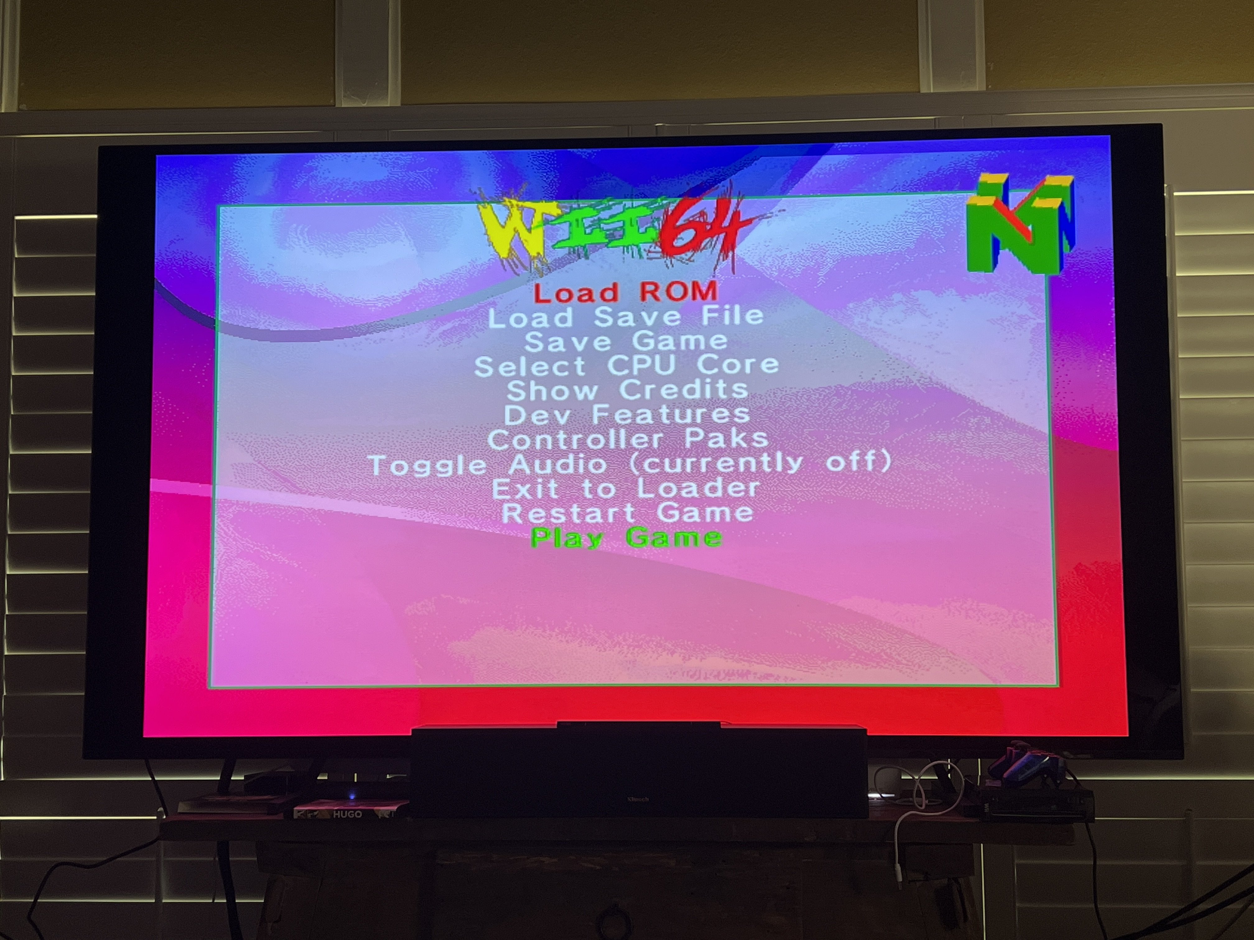

So I got a Japanese Wii from someone that they had taken to someone to mod for them. I have no clue what that person before me was smoking because the homebrew channel launches directly into a version of Wii64 that crashes the console if you do anything.
I tried going to the settings to do a fresh install of the homebrew channel but it gave me a pop up in English saying that it couldn’t connect to an address and to try making sure my internet connection is active. I have worked on a ton of Japanese Wiis in the past and never once gotten this error before. I saw another thread on here from about a decade away suggesting it was a botched attempted at region changing the Wii and to fix it with any region changer. Great fix but like I said, the genius before me didn’t leave the homebrew channel on it so I’m kinda left high and dry. I should also mention all the other text on the console is in Japanese besides the labels for the wad channel the previous person installed
Is there anything I can do to fix this or do I just have to tell him that it’s a lost cause?
??? What ???
Is that some kind of forwarder instead of the HB Channel? Any Wii64 directory containing a boot.dol you could replace with another file?
I’m as lost as you on that one buddy. I honestly have zero clue how in the world someone messes up a console this badly. I’ve seen some messed up consoles, but this is a new level.

All those custom channels in the picture, are any of them forwarders? In which case it may be rather easy to run the hackmii installer by replacing the right file on the SD (whether it'll work afterwards is a separate question)

It looks like u have a lot of forwarder channels installed, like the fceugx one will probably load whatever u save to usb or sd:/apps/fceugx/boot.dol (or boot.elf), or the gx one should load whatever is installer to apps/usbloader_gx/boot.dol or boot.elf
It's possible the last guy hardcoded the apps into the channels and they're no longer forwarders. Easiest way to check that would be make sure the sd and usb are disconnected and launch the channels, if they return you to the system menu the they are almost certainly a forwarder of some sort, and then it's just a matter of saving the apps u need to the location the forwarder is pointing to and launching them that way
