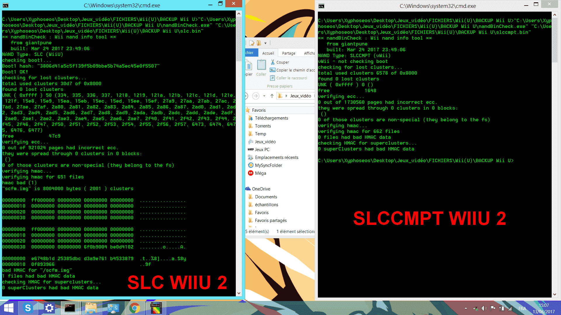

Many thanks for these tools. Is there some documentation somewhere (other than looking in the source) regarding nandbincheck and how to interpret its output?
I've used your homebrew NAND dumper to dump the NANDs for my Wii U and ran nandbincheck over the slc.bin and slccmpt.bin for interest. This is from a Wii U that is working fine as far as I know. I would like to know if the following output is normal. I ran the NAND dump homebrew a couple of times, a day or two apart, to compare.
I know you've said that the bad HMAC on scfm.img is fine, but what about on fw.img? What do the "UNK" entries mean and why are they so different between the two dumps? What is going on with the vWii errors?
First dump, SLC:
** nandBinCheck : Wii nand info tool **
   from giantpune
   built: Mar 24 2017 23:49:06
NAND Type: SLC (WiiU)
checking boot1...
Boot1 hash: "3806d41a5c5f139f5b09bbe5b74a5ec45e0f5507"
Boot1 OK!
checking for lost clusters...
total used clusters 3094 of 0x8000
found 0 lost clusters
UNK ( 0xffff ) c1 (738, 739, 73a, 73b, 73c, 73d, 73e, 73f, 9c0, 9c1, 9c2, 9c3, 9
c4, 9c5, 9c6, 9c7, 1248, 1249, 124a, 124b, 124c, 124d, 124e, 124f, 12f8, 12f9, 1
2fa, 12fb, 12fc, 12fd, 12fe, 12ff, 13b0, 13b1, 13b2, 13b3, 13b4, 13b5, 13b6, 13b
7, 13b8, 13b9, 13ba, 13bb, 13bc, 13bd, 13be, 13bf, 13c0, 13c1, 13c2, 13c3, 13c4,
 13c5, 13c6, 13c7, 13c8, 13c9, 13ca, 13cb, 13cc, 13cd, 13ce, 13cf, 13d0, 13d1, 1
3d2, 13d3, 13d4, 13d5, 13d6, 13d7, 13d8, 13d9, 13da, 13db, 13dc, 13dd, 13de, 13d
f, 14f0, 14f1, 14f2, 14f3, 14f4, 14f5, 14f6, 14f7, 14f8, 14f9, 14fa, 14fb, 14fc,
 14fd, 14fe, 14ff, 17a0, 17a1, 17a2, 17a3, 17a4, 17a5, 17a6, 17a7, 1878, 1879, 1
87a, 187b, 187c, 187d, 187e, 187f, 18d8, 18d9, 18da, 18db, 18dc, 18dd, 18de, 18d
f, 196f, 197d, 197e, 197f, 1998, 1999, 199a, 199b, 199c, 199d, 199e, 199f, 19a0,
 19a1, 19a2, 19a3, 19a4, 19a5, 19a6, 19a7, 19a8, 19a9, 19aa, 19ab, 19ac, 19ad, 1
9ae, 19af, 19c0, 19c1, 19c2, 19c3, 19c4, 19c5, 19c6, 19c7, 19c8, 19c9, 19ca, 19c
b, 19cc, 19cd, 19ce, 19cf, 19d0, 19d1, 19d2, 19d3, 19d4, 19d5, 19d6, 19d7, 19d8,
 19d9, 19da, 19db, 19dc, 19dd, 19de, 19df, 1a00, 1a01, 1a02, 1a03, 1a04, 1a05, 1
a06, 1a07, 5e5b, 5e5c, 5e5d, 5e5e, 5e5f)
free            479b
verifying ecc...
1 out of 921408 pages had incorrect ecc.
they were spread through 1 clusters in 1 blocks:
 (2302)
1 of those clusters are non-special (they belong to the fs)
verifying hmac...
verifying hmac for 608 files
hmac bad (1)
"fw.img" is adc200 bytes ( 2b8 ) clusters
00000000  ffadf577 03f2813c 022055db a7901111  ...w...<. U.....
00000010  6f72658f d0adf577 03f2813c 022055db  ore....w...<. U.
00000020  a7000000 00000000 00000000 00000000  ................
00000030  640f9b00 0209fd06 85067a09 180ce703  d.........z.....
00000000  ff901111 6f72658f d0000000 00000000  ....ore.........
00000010  00000000 00000000 00000000 00000000  ................
00000020  00000000 00000000 00000000 00000000  ................
00000030  b00bb00b 1800e70f 2a092a09 a702580d  ........*.*...X.
00000000  ebd68614 971c86cd 4c524fa7 3da7dba3  ........LRO.=...
00000010  e69b1279                             ...y
bad HMAC for "/sys/title/00050010/100040ff/code/fw.img"
hmac bad (1)
"scfm.img" is 8004000 bytes ( 2001 ) clusters
00000000  ff000000 00000000 00000000 00000000  ................
00000030  00000000 00000000 00000000 00000000  ................
00000030  00000000 00000000 9601690e 9b0d6402  ..........i...d.
00000000  d77444c0 6e1d28fb e45bd324 3ff6b662  .tD.n.(..[.$?..b
00000010  cbc0345e                             ..4^
bad HMAC for "/scfm.img"
2 files had bad HMAC data
checking HMAC for superclusters...
0 superClusters had bad HMAC data

Who can help me, I don't know if this dump of the slc wiiu 1 and 2 and slccmpt wiiu 1 and 2 or good...
@Felek666
