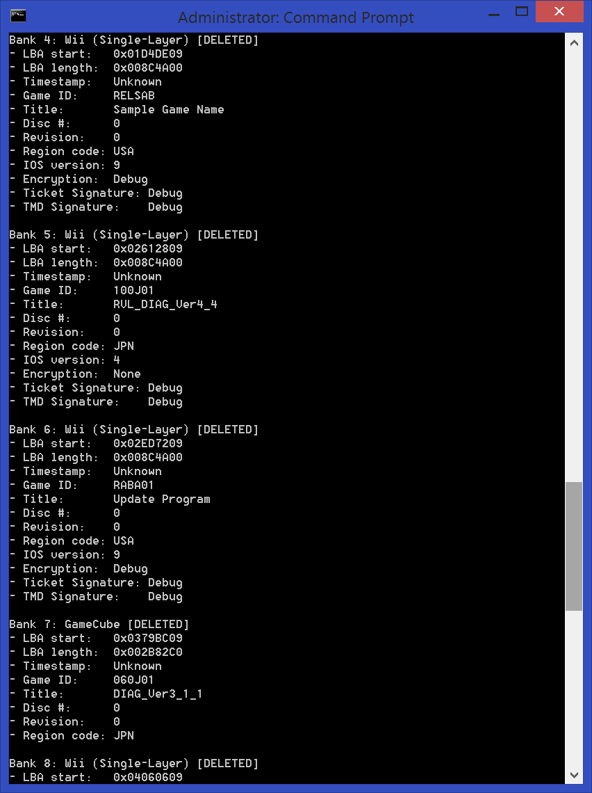

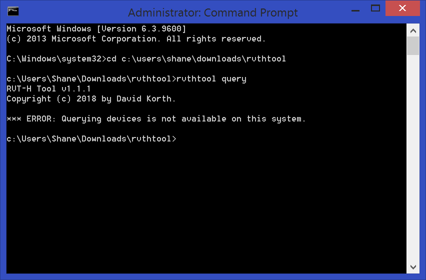

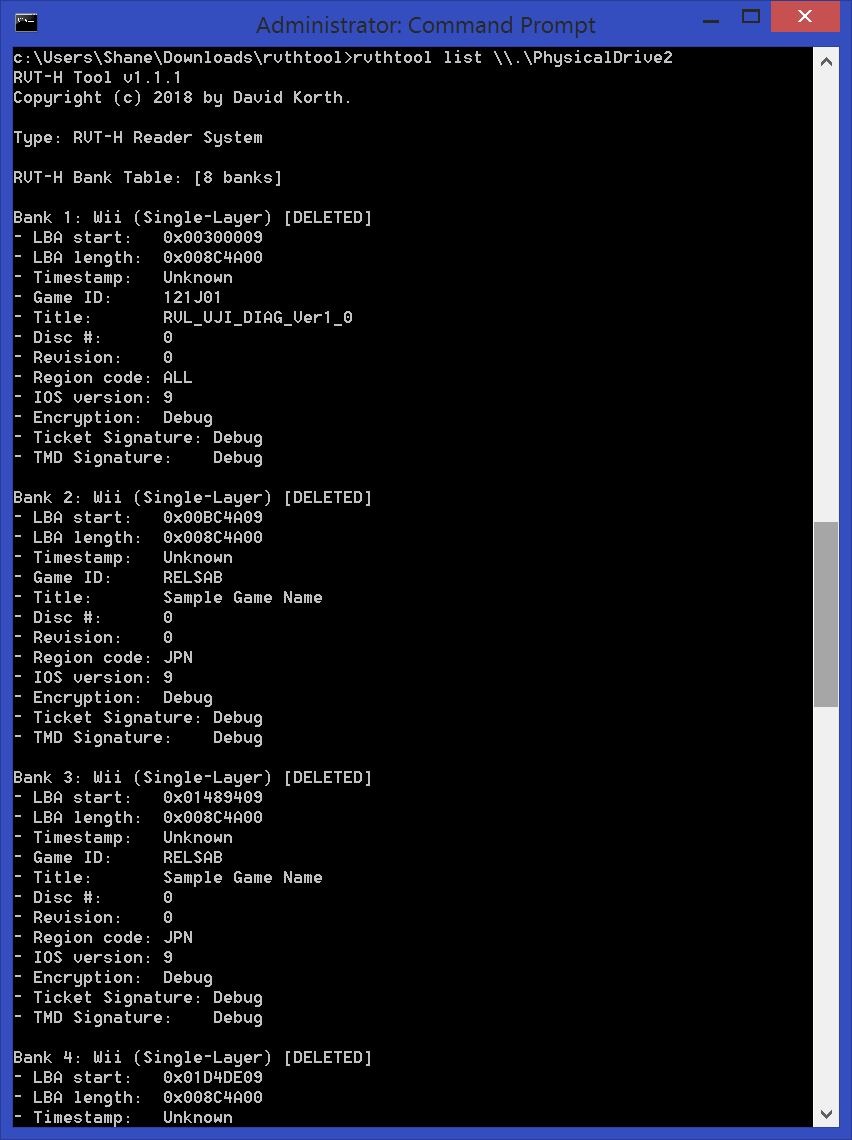

shano4321
Mar 25, 2019
40
48
Australia
Hi and thanks for creating this tool! Just want to check my steps to get it running. I've just received an RVT-H and am on a Win 8.1 64bit PC. I installed the 64 bit MSVC 2017 runtime and downloaded version rvthtool_1.1.1-win64. I've connected the RVT-H to the PC via USB and power on the RVT-H; I can confirm in disk manager a 'Disk 2' of 37.26gb capacity appears. I enter command prompt (run as administrator) and localise to the folder with rvthtool then run 'rvthtool query' but just get "ERROR: Querying devices is not available on this system."
Any help would be greatly appreciated :)
shano4321
Mar 25, 2019
40
48
Australia
Oops just read the --help and realised it's not available in this Windows version
