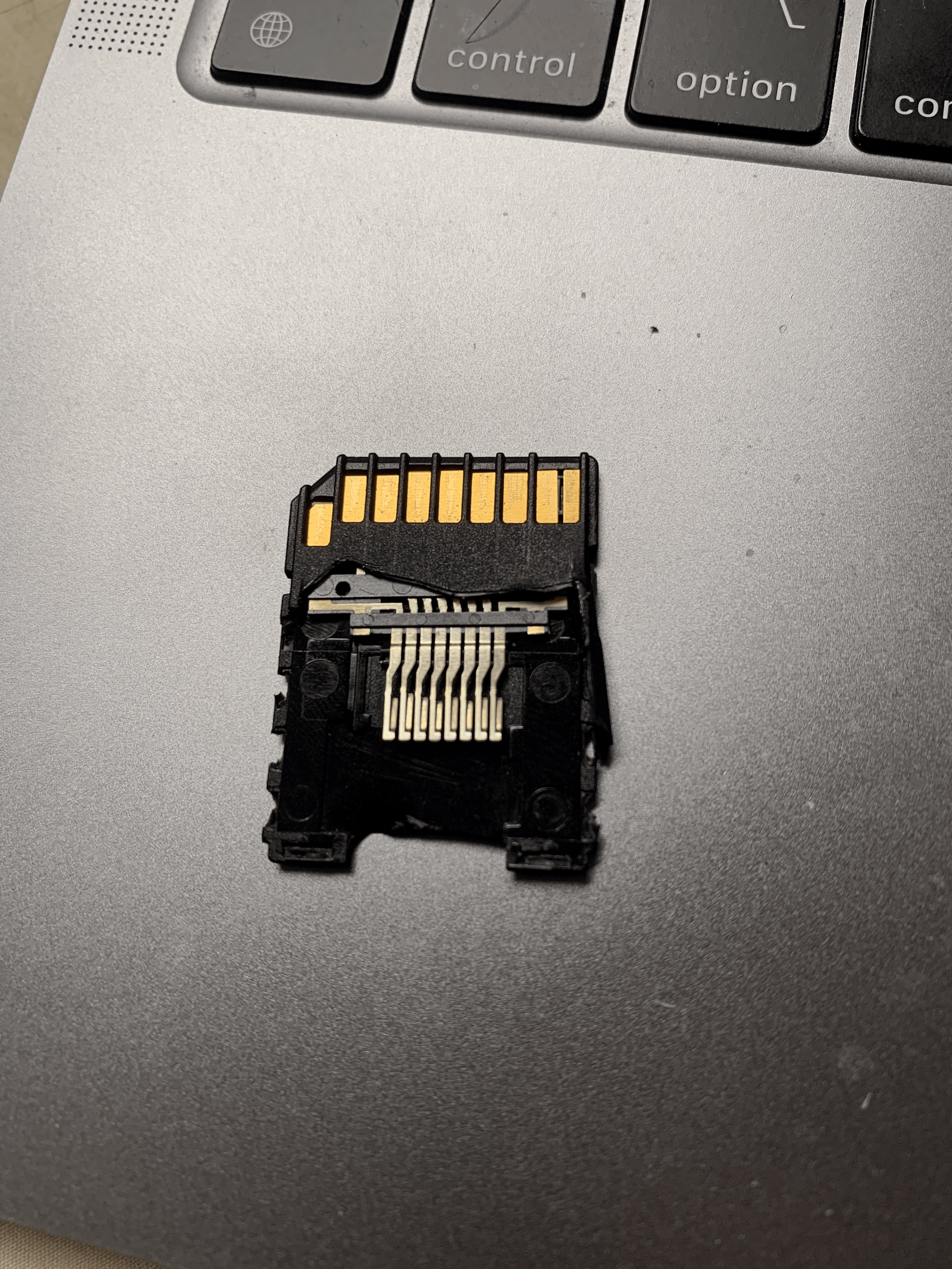

I have (mostly?) everything I need to proceed with the NAND-Aid. I don't have a dedicated emmc to sd breakout board (at least something like Voultar's upcoming SD Tool, I'm unsure if that's what it's properly called but searching up breakout board gave me siimilar results), but I do have a micro sd to sd card adapter, which I think could be wired up from the NAND-Aid to be read from the PC. I included an image of the state it is in just to ensure that it is fine being like that. I'm unsure if there is anything else that can work to get the hardware dump, though I heard raspberry pi's can work, but I only have a Pico, which I think cannot work.
I'll probably start to do the actual process of installing it tomorrow. If there is anything I should know before proceeding, let me know.

Yes, you can build an adapter out of the micro SD Adapter. I also did that once. The Pico wont work.
Alright, perfect. My presumption is that I'd just have to solder the wires from the NAND-Aid pads to the exposed contacts of the adapter in order of the general pinout for micro sd cards?
yes. Some adapters expect a pull up on DAT3, but I would first try without it. In theroy one DAT line (DAT0) should be enough
