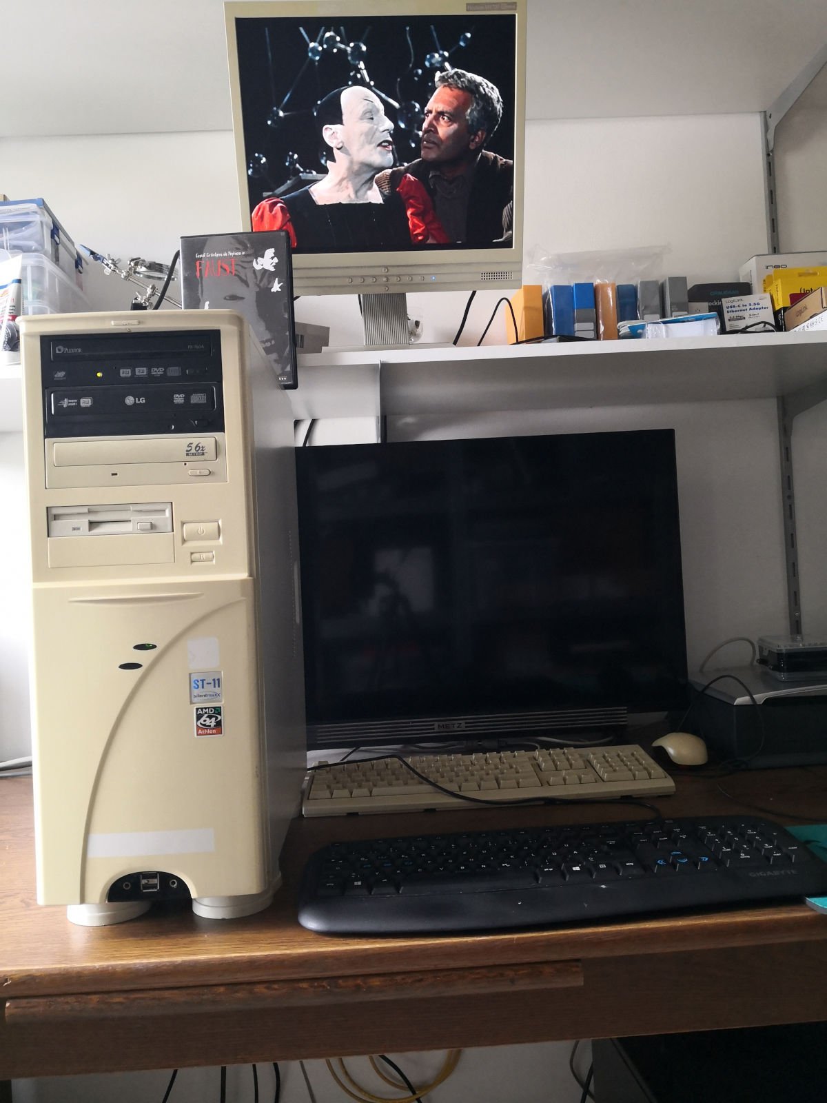

Welcome to another long blog entry written by LittleSinchen. I’m not quite satisfied with the entry I already posted on a PC with Asus A8V motherboard. In my previous entry I said that this PC is completely unsuitable for daily usage because of one major issue: Missing full disk encryption (FDE from now on). I have been using FDE since about 2006 or 2007. Back then I had an Athlon X2 6000+ – a real power hog CPU with 125W TDP. This beast of a CPU with high clock frequency and two cores had serious trouble handling FDE (and I did in conjunction with VirtualBox running Windows Vista and later Windows 7 64 bit version with openSUSE as host OS). Using a single core Athlon instead? No chance!
… and I couldn’t just accept my own verdict. Having read from other GBAtemp members that they are forced to use a Windows 8.1 laptop with 4GB of RAM and a slightly damaged screen… or even a PlayStation Vita as their means of accessing the internet I had to reconsider. Other members being forced to use unsuitable devices is a great motivation for looking into this deeper (and posting it here instead of my new blog).

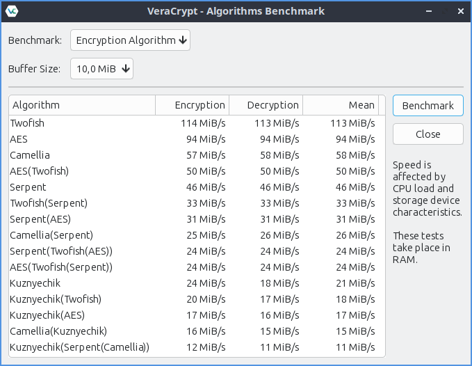

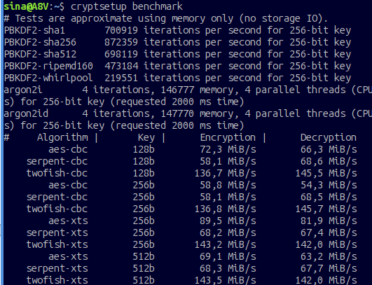

This HDD offers too little storage room and /home is speed limited by encryption. A situation demanding more storage space. A kind of scratchpad. A place for replaceable and non-personal data (like downloaded Linux images, software packages or video lessons… whatever). Goal: maximum performance and storage while maintaining the rule of using only heavily outdated hardware.
Two 320GB 2.5” laptop HDDs are suitable when used in dangerous RAID 0 configuration.
As you can see below my partitioning of the main HDD is minimalist. 100GB root partition (plenty of room for the OS), rest for /home – no swap and nothing else.
/dev/sda1 * 2048 209717247 209715200 100G 83 Linux
/dev/sda2 209717248 976773119 767055872 365,8G 83 Linux
Setting this up after default installation requires basic Linux knowledge and command line usage:
/dev/sda1 98G 11G 82G 12% /
/dev/md0 596G 12G 585G 2% /unencrypted
/dev/mapper/Daten 359G 751M 340G 1% /home

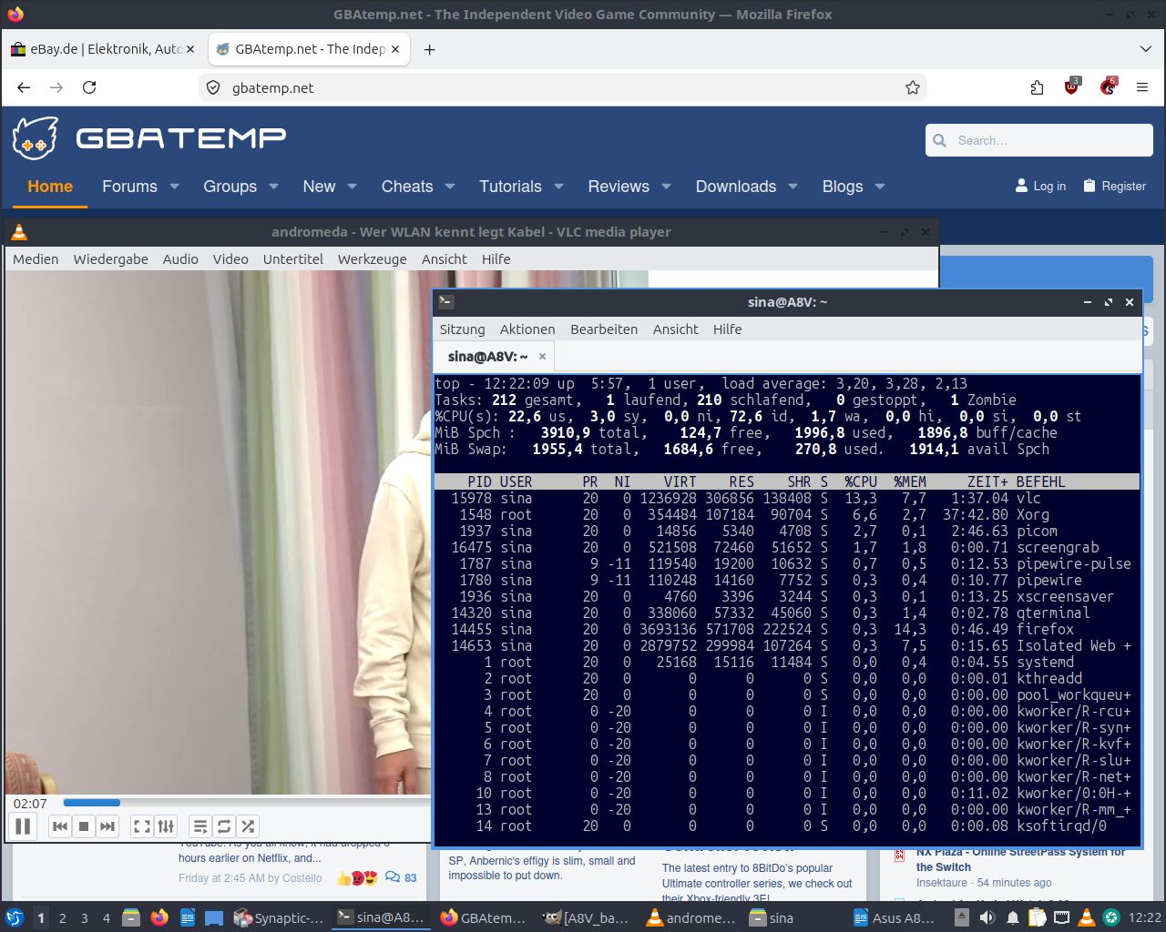

This system is somewhat usable for web browsing with content filters. Office work, basic image editing and local videos are surprisingly good. For those activities, it's genuinely functional — slow, but not unusable and it can keep many things open at once (under Windows 7 I regularly ran into out of memory and swap usage which is a deathblow without SSD)
Everything else is off-limits: streaming video in browsers, gaming, and anything requiring GPU acceleration. The hardware limitations are real and unbridgeable without accepting security risks (proprietary drivers for an ancient GPU on outdated OSs like Lubuntu 16.04 or Windows 7).

Now it’s time to install an operating system. Since the last entry I decided to ditch Windows 7 completely. It is unsupported and unbearably slow without an SSD. I needed the 2TB WD Raid Edition from first attempt in a more modern PC. This left me with a Western Digital Caviar Blue (500GB) as main HDD. Installed Lubuntu 26.04.1 – a very recent OS.This HDD offers too little storage room and /home is speed limited by encryption. A situation demanding more storage space. A kind of scratchpad. A place for replaceable and non-personal data (like downloaded Linux images, software packages or video lessons… whatever). Goal: maximum performance and storage while maintaining the rule of using only heavily outdated hardware.
- Manually create LUKS container for /home using Twofish and create ext4 file system inside
- Copy existing home directory
- Add partition (UUID) to /etc/crypttab and /etc/fstab
- Activate zram instead of real swap file/partition to minimize leaking unencrypted data
- Create software RAID with mdadm and add it to fstab

Main question: How good does browsing the web work? Answer: It depends. Running Firefox at defaults with all the bells an whistles just opening websites as intended either becomes a torturous patience test or outright fails. But with uBlock Origin taking care of ads and NoScript only selectively allowing scripts (try finding bare minimum for each site) browsing is okay. News sites, webmailers, forums. Shopping sites like eBay or Amazon are also usable although I won’t log in or even buy things. Sorry, the security level of this system is so much below my standards that I can’t justify logging into any important accounts.Video Streaming:
Nope! With a bit of luck YouTube will run when choosing 360p and using tiny window player (not full screen). Heavy stuttering regardless. Might be possible to find information from a video tutorial but enjoying entertaining content is impossible.Office Work:

Mostly works, with caveats. I'm confident about MPEG-1 and MPEG-2 files – these are ancient codecs and software decoding handles them fine. Playing a retail DVD in VLC did not even put stress on the single-core Athlon. The most widespread codec, H.264, was the question mark. I hoped lower resolution H.264 videos (720p and below) might play in VLC… and I was pleasantly surprised to see CPU-based decoding working. I just opened a talk from media.ccc.de and even full-hd video played without problems. I have to repeat that with a more demanding file (action movie at insanely high bitrate – source a Blu-Ray disc). I will not try H.265 → For heaven’s sake, NO!
