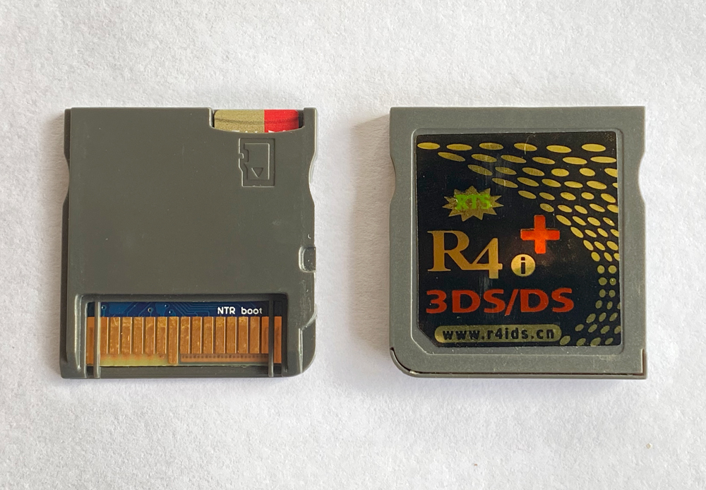

Show photos of both sides of the cart. Good photos. You can also show photos of the printed circuit board.
Real R4i Gold 3DS Plus (from r4ids.cn, which kernel you are trying to run on your cart) has no problems with blacklists.
By the way, is this a recent purchase?
This cart (real R4i Gold 3DS Plus from r4ids.cn) has been out of production for several years.
But not so long ago on Aliexpress (and not only) a batch of defective carts was on sale.
Only the "N" mode (NTRboot loader) worked there. And the "D" mode, i.e. "normal flashcard" mode - didn't work. That's why they were defective.
This was actually stated in the product description tho, but anyway. Who after all reads descriptions nowadays.
Thanks please see front and back image attached of flashcard. Not a recent purchase at least 3-4 years old now. Ran well for years on v11.15 but when the NDS updated to v11.16 it stopped working.
