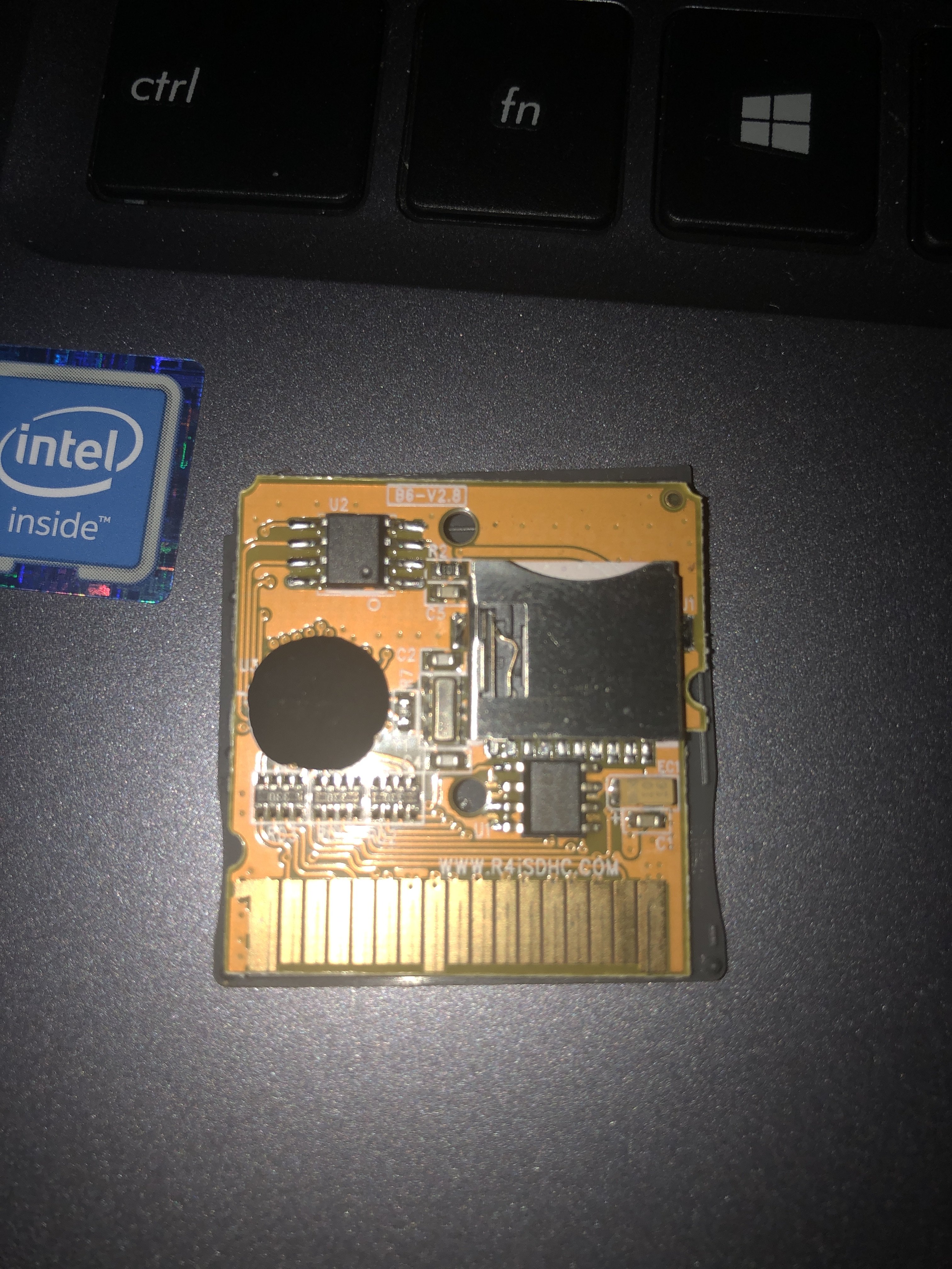

Here’s the inside of the card! I really hope this helps! I’m beginning to lose hope 😅😅

Hmm, I think that looks like it's one of the recent ones, are you sure the card slot is actually working correctly? If other carts work it could maybe just be bad contact on the flashcard and cleaning it or putting a bit of paper behind it may help.
Maybe the r4isdhc.com Silver RTS Lite NEW firmware update is right for that, but I'm not confident on that so I wouldn't recommend running it unless someone can confirm that, I've let @lifehackerhansol (who manages that repo) know about this on Discord so maybe he'll know better than me what exactly this cart would need.
If the card slot is dead you could always just install TWiLight Menu++ and just copy your games and saves over and play that way.

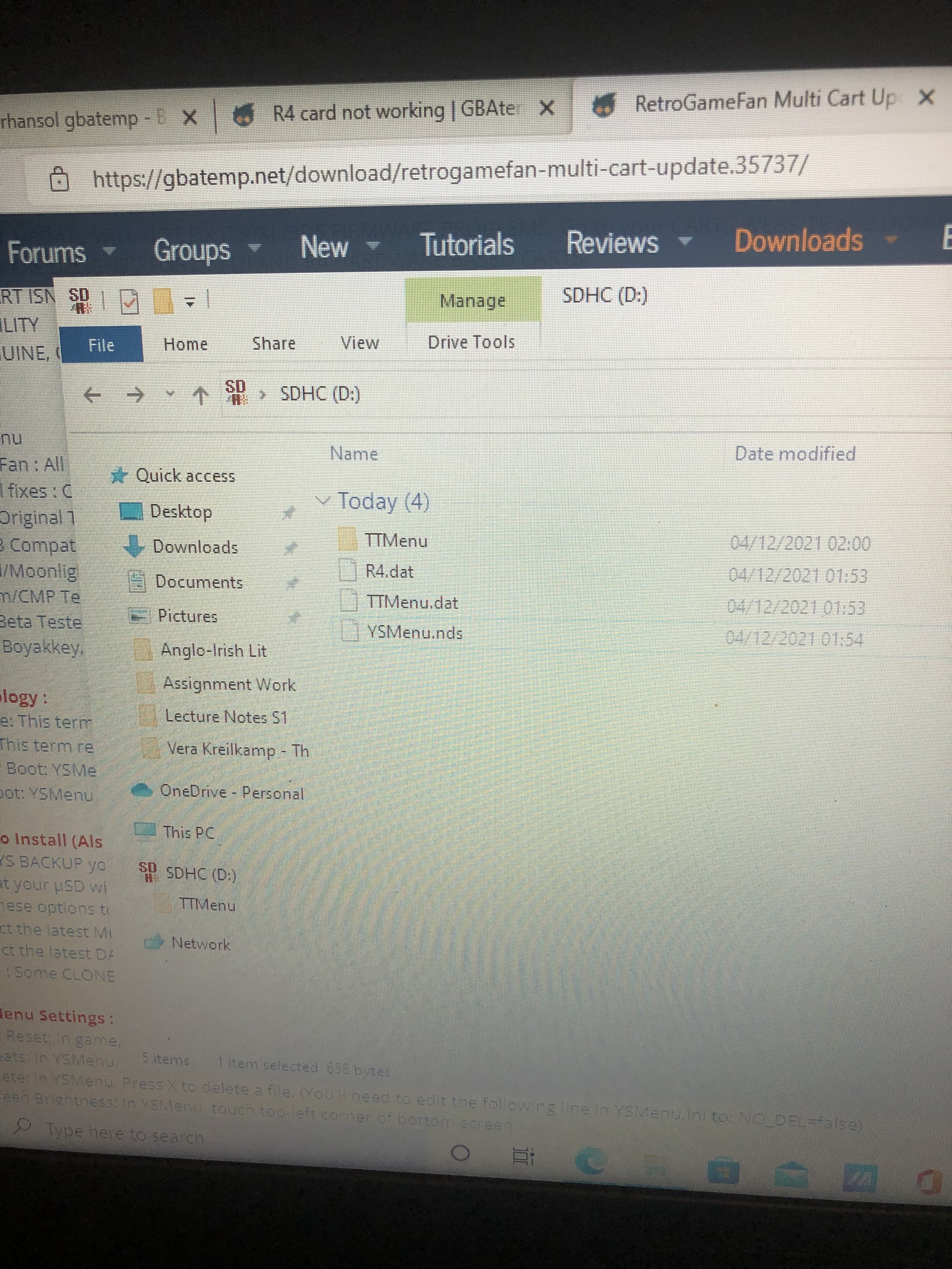

Ok so I followed this, and still nothing.. I think the card may be gone 😩 I’ve uploaded what the card contained after to see if I did it right.. and what my dsi showed.. also attached what was one it before (I backed this all up)

Try giving the card some cleaning on the pins. As well, the usual Nintendo trick of blowing in the slot (because that always works for some reason.)
It seems to me that at the very least the files are placed correctly. So that is not the problem.
