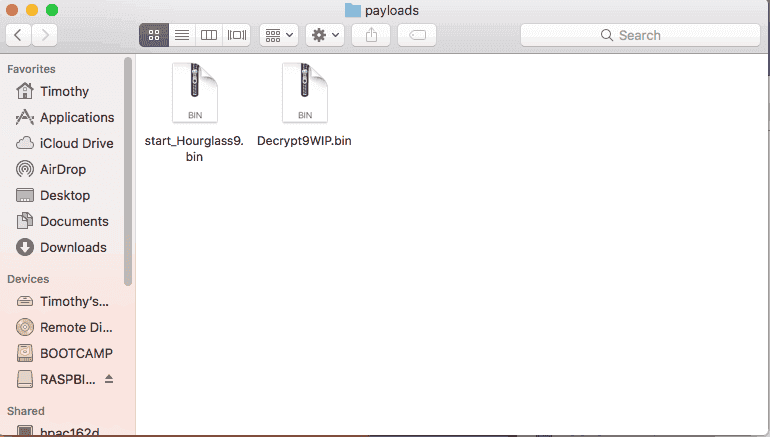

  14. BurningDesire
    BurningDesire GBAtemp Psycho!
    4,965
    5,844
    Jan 27, 2015
    Behind a screen reading news
    So like this? but renamed to x_NAME.bin
  15. metroid maniac
    metroid maniac An idiot with an opinion
    1,800
    720
    May 16, 2009
    Yep, just stick "x_" at the front of the name to map it to x on boot.
    I advise making backups of the NAND with a9lh and also the OTP before uninstalling a9lh.
    BurningDesire likes this.
