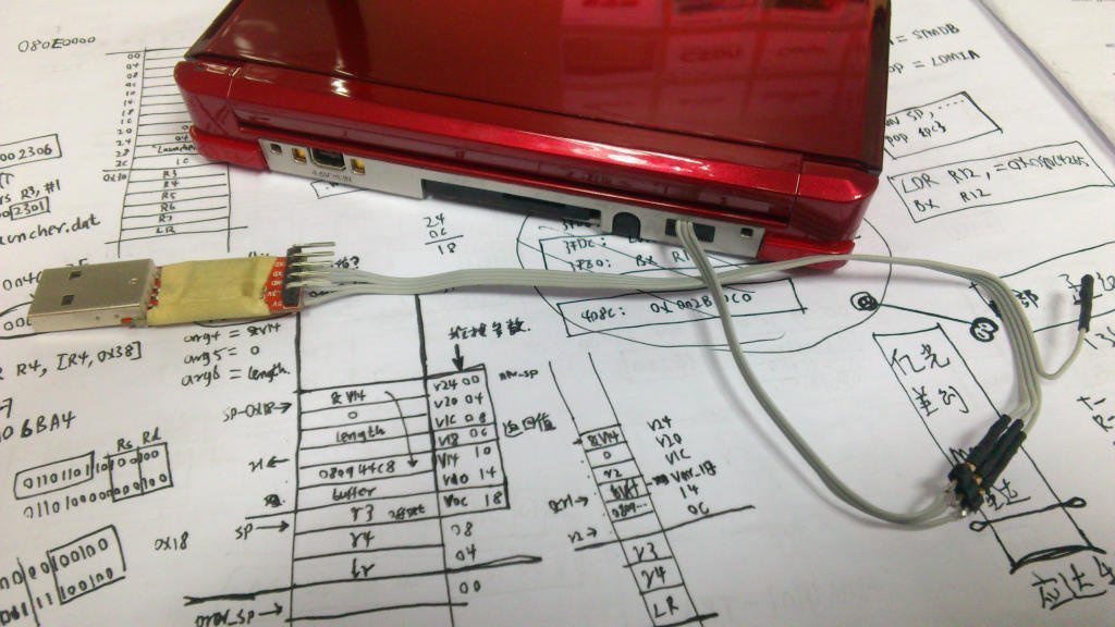

yes, signal come from ir module.
In fact, this module can be used to connect to another ir serial device.
Reactions: pelago
Do you have a circuit to show and More documentation?
I would like to dive deeper in this If you could PM me your work? I'm currently building a diy circle pad but my IR tranciever broke down so this would acctually work better.
