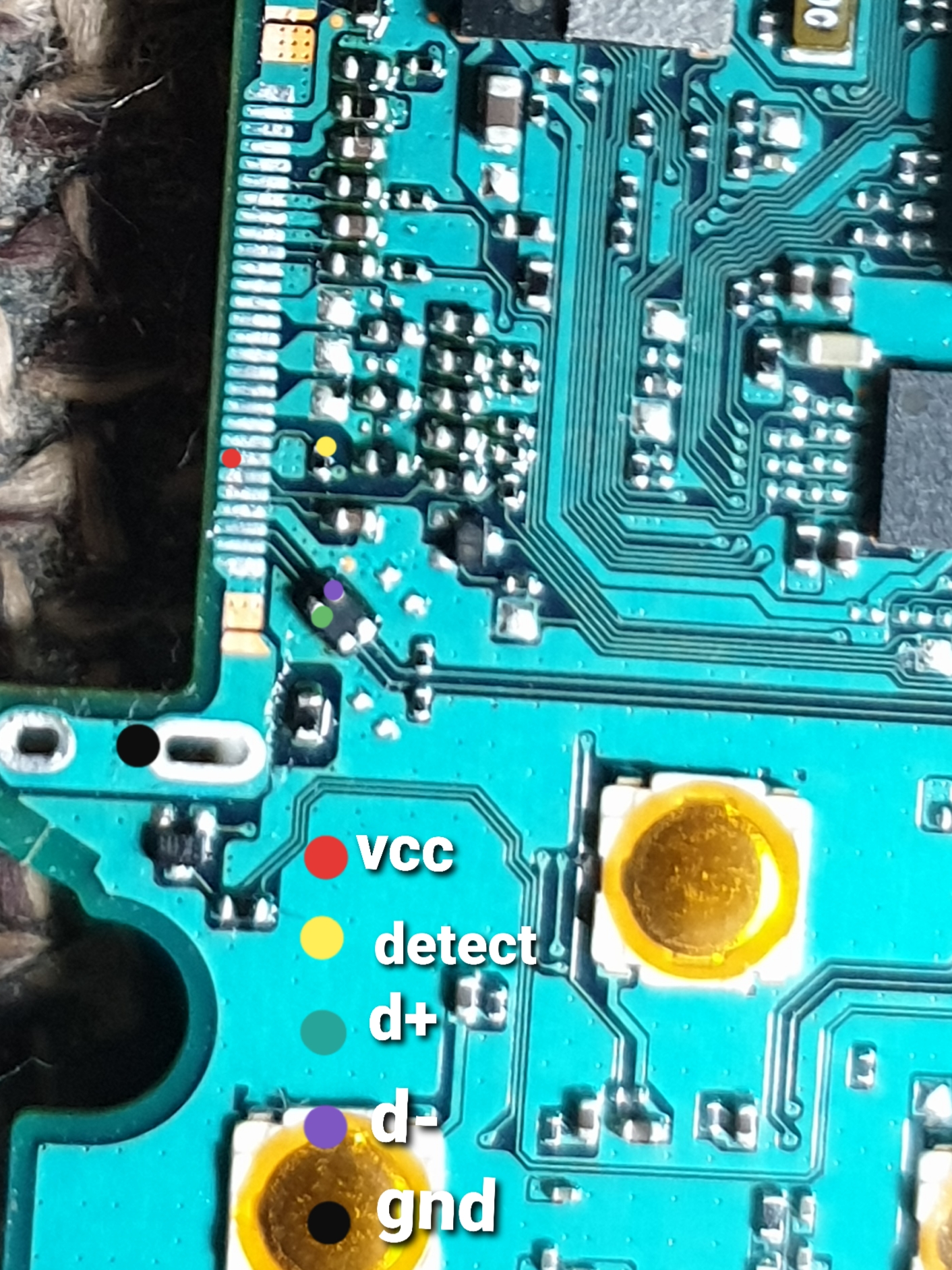

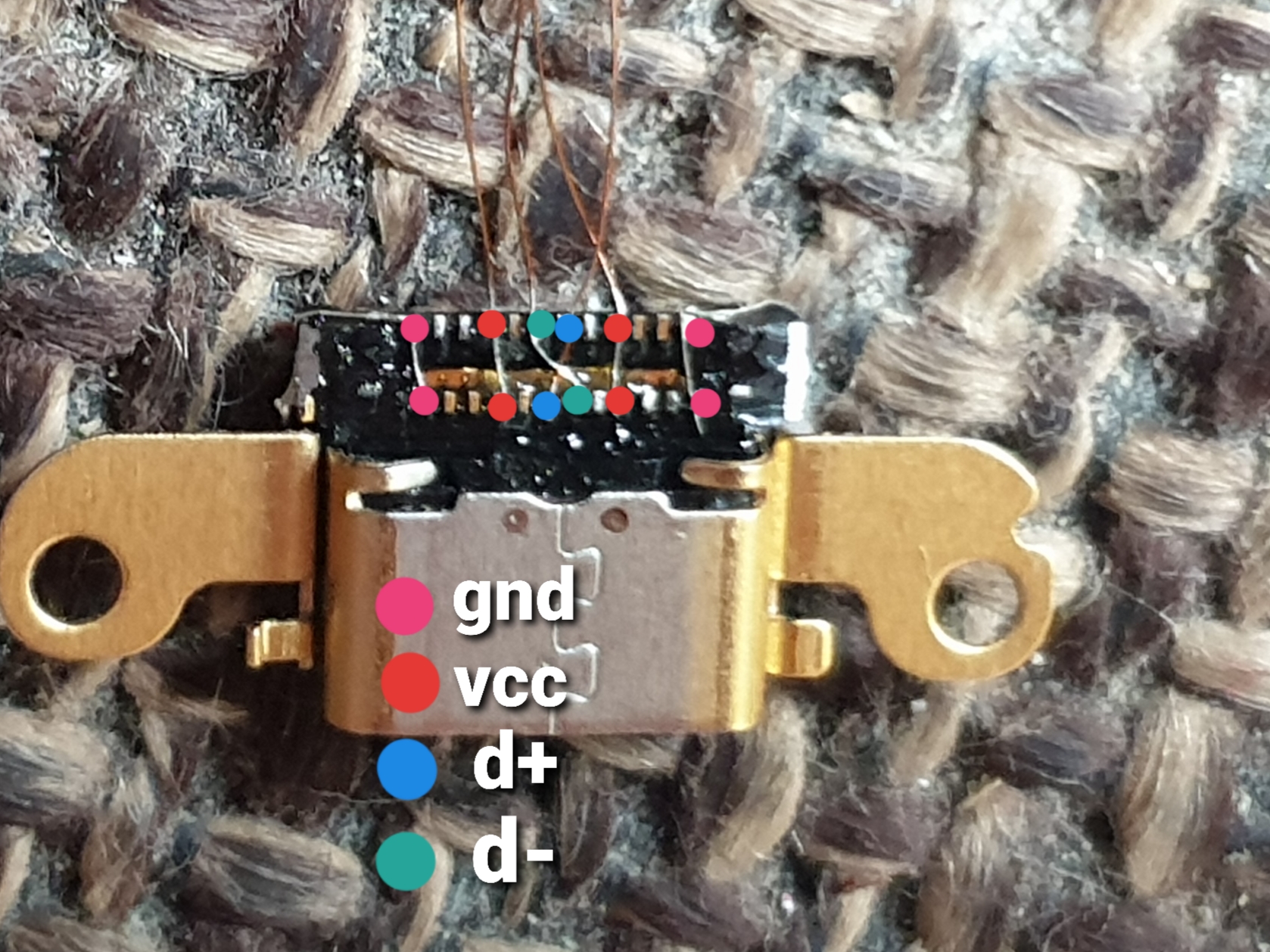

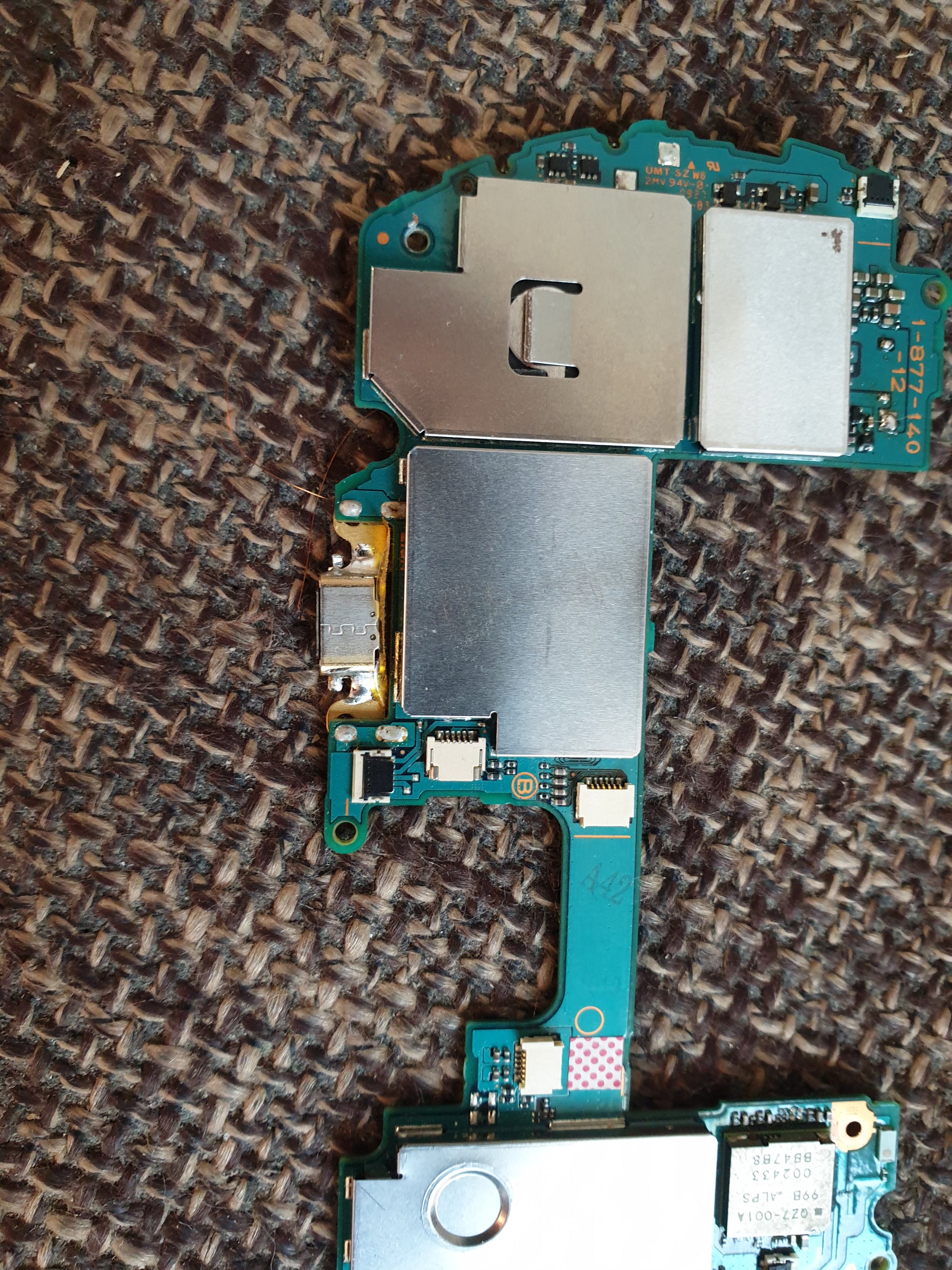

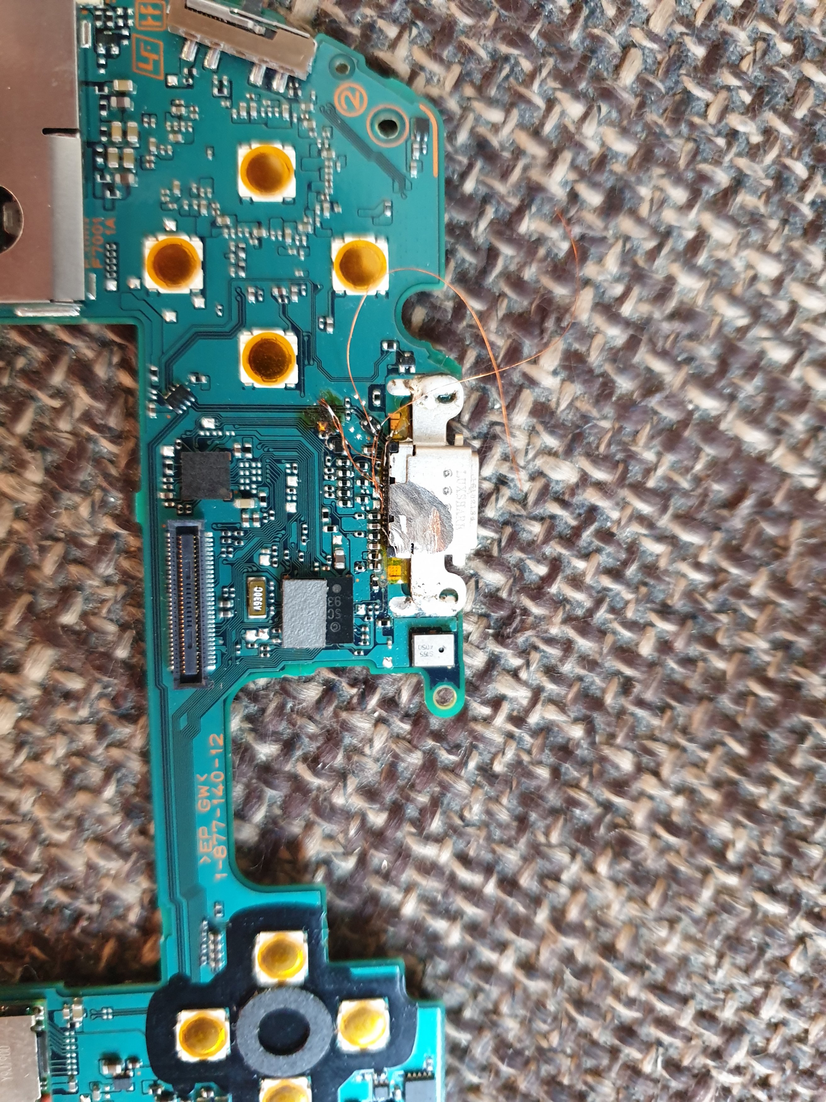

Maybe its be useful for someone. Needed - dremel, soldering iron, tiny wires (lacquered), middle soldering skills, xiaomi mi note 2 connector, and imagination ofc.
Points vcc and detect will be shorted.
Maybe i mixed up d+ and d- point on photo - if you see "unknow device" just swap data wires - its simple.

Would it still work without bridging the detect and vcc? Mind explaining why that's important? I did it and it works but now it can't detect va cables and I wonder if that could be the cause

I did this, thanks for the info. I can no longer use va cables to connect to the tv tho and I suspect it's because of bridging the detect and vcc pins. Do you know why this could be?

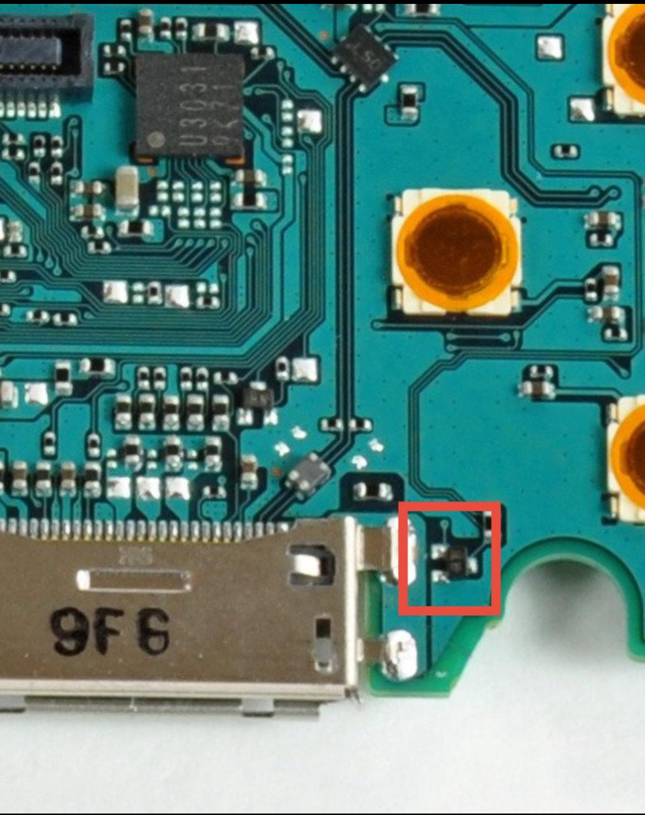

Hey there! Thanks for sharing this thread! I know it’s been a while since you posted this message, but I was wondering if you had a high
resolution image of this area of the motherboard?
I’m trying to identify a component’s ID number, and I’m missing this component from my motherboard. I’m pretty sure it’s a transistor, and I’d love to know the ID number so I can replace it.
