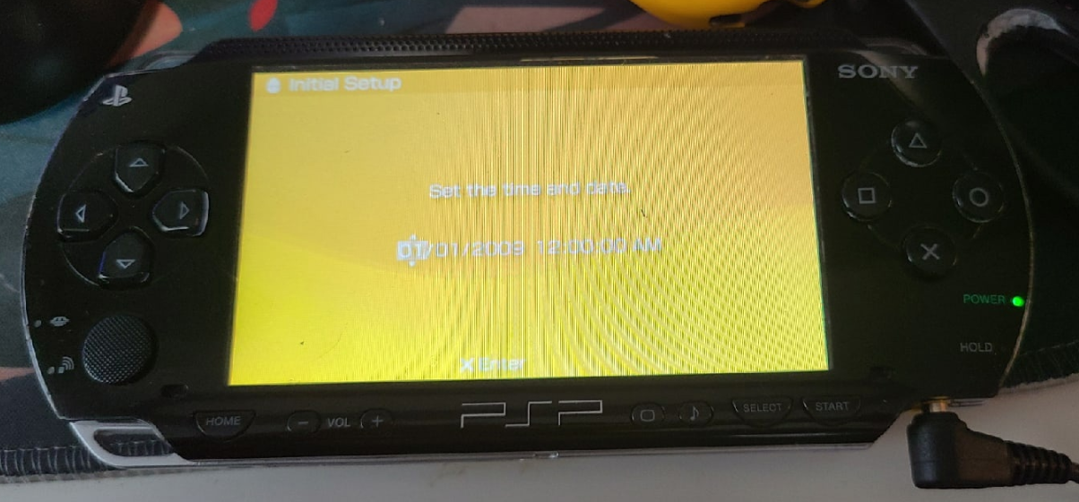

So my psp acts super weird. If I tear it apart, and leave for some time, then I accemble it and boot it will boot to the screen, but none of buttons work. I can see it's not frozen flashing animation on 01 is played. Then if I turn it off it won't turn on back. Doesn't react to Pandora battery or pandora + mmstick. (didn't try to get pandora + stick on that rare boots, cos manage to boot it like 3 times so far)
Anybody knows or have any idea what can be wrong with it? In the bricked state it charges batteries and power goes through mobo checked + from charger to minus on mobo and charger.
UPD: So basically if i hold power button without battery for long time. I can boot it again with power. And buttons work for a bit, i managed to install cfw with pandora. But didn't help so buttons work for like 10 sec or so. So mobo fried? or anyone aware what can cause that?
