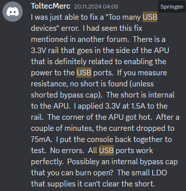

Hi, I have a console with this on start up - Too Many USB device connected even nothing is connected to the console. There is no power to the USB ports so I can't get controller to connect. I've replaced all power chips alsp the USB C controller but still same problem. Does anybody know if Southbridge chip replacing will do something? On the PS4 the southbridge control the USB ports but I'm seeing that on PS5 the connection is direct to the APU. Anybody with similar problem?

At your own risk..

Check if you have a short on the usb port power lines somewhere.
I presume that the power draw on the USB port is measured and it mistakenly thinks you plugged in a whole bunch of USB devices drawing more current than you are supposed to.
