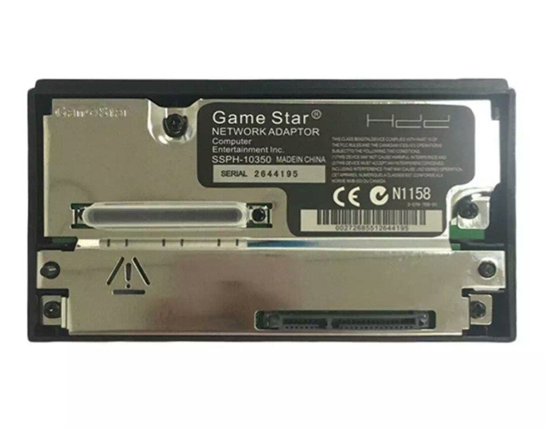

Oh man. It sounds more complicated than i thought. Umm this is the network adapter i plan to buy. Its built so SATA can go in instead of IDE HDD.
So lets say i decided to format that 80gb external HDD using a PC. Then how do i put games on it? I mean, i wanna put games on it on the PC if possible so when i put the HDD to network adapter, it will be awhile before i take it out again. Is that even possible?

Most likely this is the Chinese knockoff version as the original network adapter with the LAN port is very rare and hard to come by and they are a bit pricey, also the original one only supports IDE HDD which can be modded to accept SATA HDD.
The one in the picture looks like mine, it's SATA and doesn't have LAN, the port is there but has nice yellow sticker covering it saying there is NO LAN port.
As for installing games to the HDD, I use WinHIIP program on the PC, as long as you still have the PS2 ISO's, it's just a simple few mouse clicks and the game will start to install on the HDD, as others has already mentioned, just use a HDD (SATA) to USB adapter to connect to the PC so you can transfer the games across using the app.

So that chinese knockoff SATA network adapter is reliable? I mean, you have one sir. So that means, its safe to buy these things? I will either use winhiip or HDL_Dump, as long as i can play without any choppy jumpy cutscenes, i am good.
My PS2 was collecting dust for a couple of years and that's when the HDD caught my attention recently, I read some reviews/tutorials/youtube about these and I just purchased the cheapest one possible on ebay.
It pretty much worked as intended, booting PS2 games from the HDD :) Installed it a few months ago and haven't had any issues, yep you can use any of those two apps, though I have not used HDL_Dump so I can't comment on this, but WinHIIP worked fine.

I can vouch for the cheap Chinese sata adapters being good - I've been using one I bought off of Ali-Express for a couple of years with no problems (and I regularly remove and replace the drive to hook it up to my pc).
