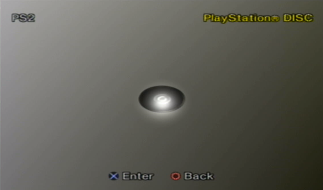

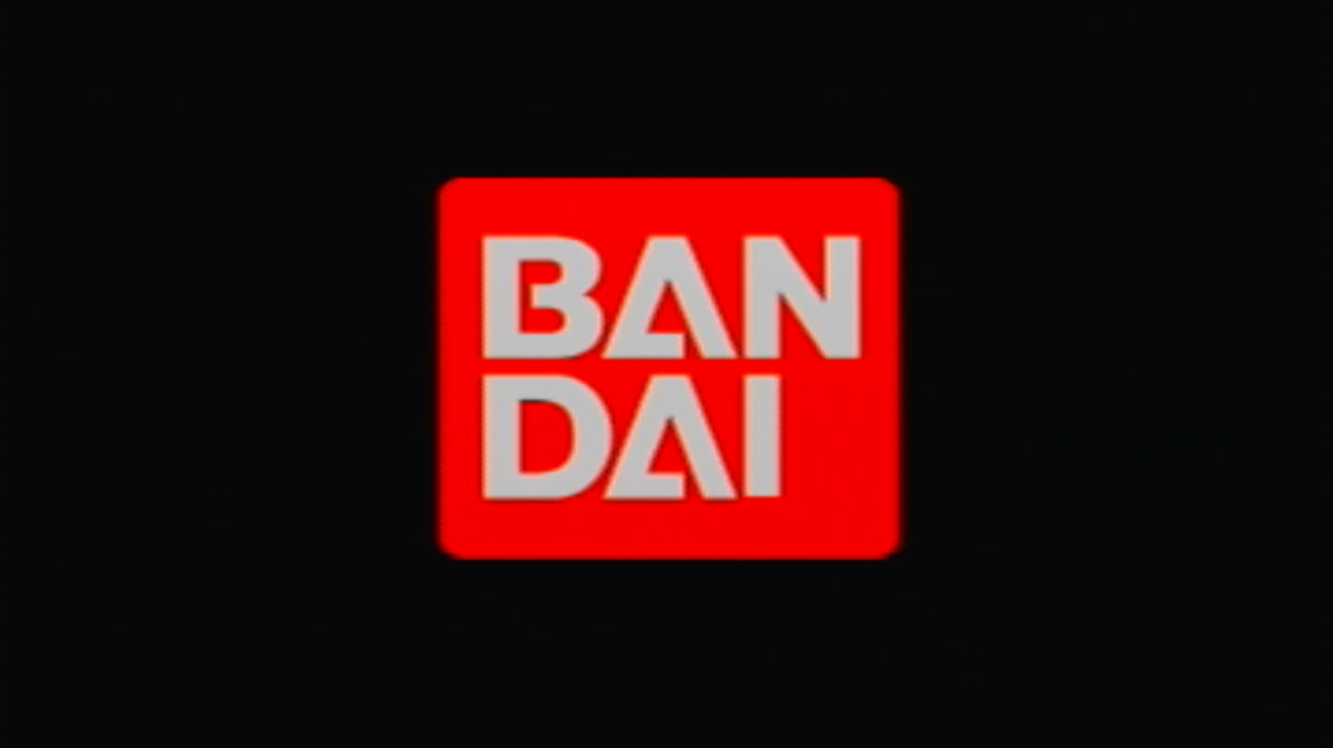

I switched to Dex 77000 and am running both NTSC-J and NTSC-U DVD-based games with no problems. Thanks :)
Edit: Tried DVD playback (testing because it's meant to be region free anyway) to be greeted with a "DVD Player is not setup" error message, which ultimately boots me back to the OSD if I try to load a disc anyway. Is this expected behavior? Seems like it shouldn't happen on Deckard-based systems, but it does.
Edit 2: Switched to DTL-77001 and DVD playback on same-region DVDs is a go again. Will try out of region in a moment and follow up.
Edit 3: See attached file. Interesting... It may have always done this, but I don't really remember nor entirely care to test further. I've got a drive in my PC for watching out of region discs anyway.
Edit 4 (Final update): The solution linked here was able to unlock DVD playback for out-of-region discs perfectly.
