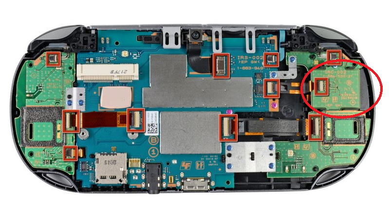

Yeah so I completely took this out of my system, didn't touch the wireless card:
There might be a way to do it through some system tweaks although I may have not changed the right things when using the registry editor.

Yeap :) I also have question for you... since near marked module there is some flex cable - Is it possible that this is connection to mother board that could be disconnected to not remove the whole board.
