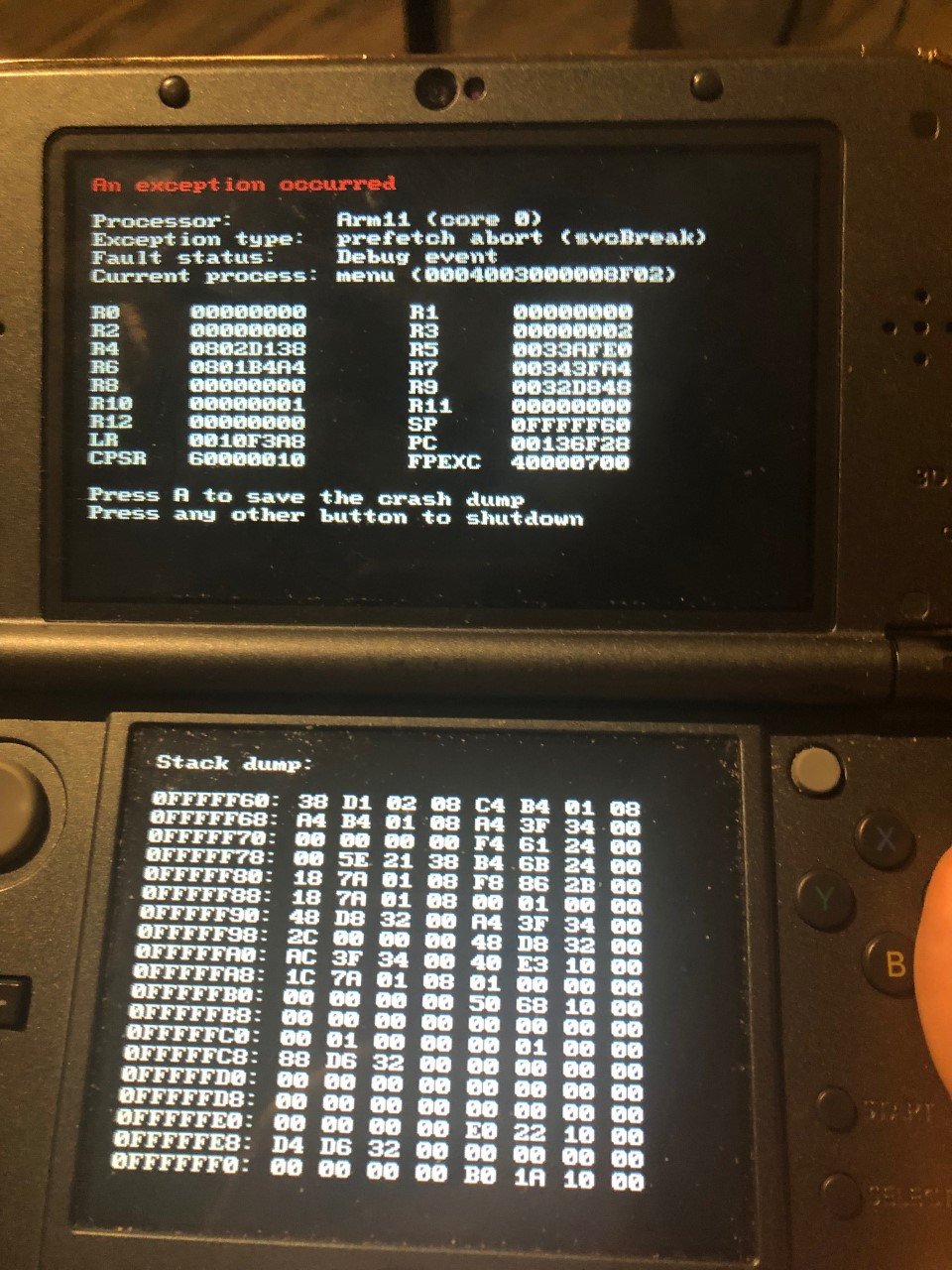

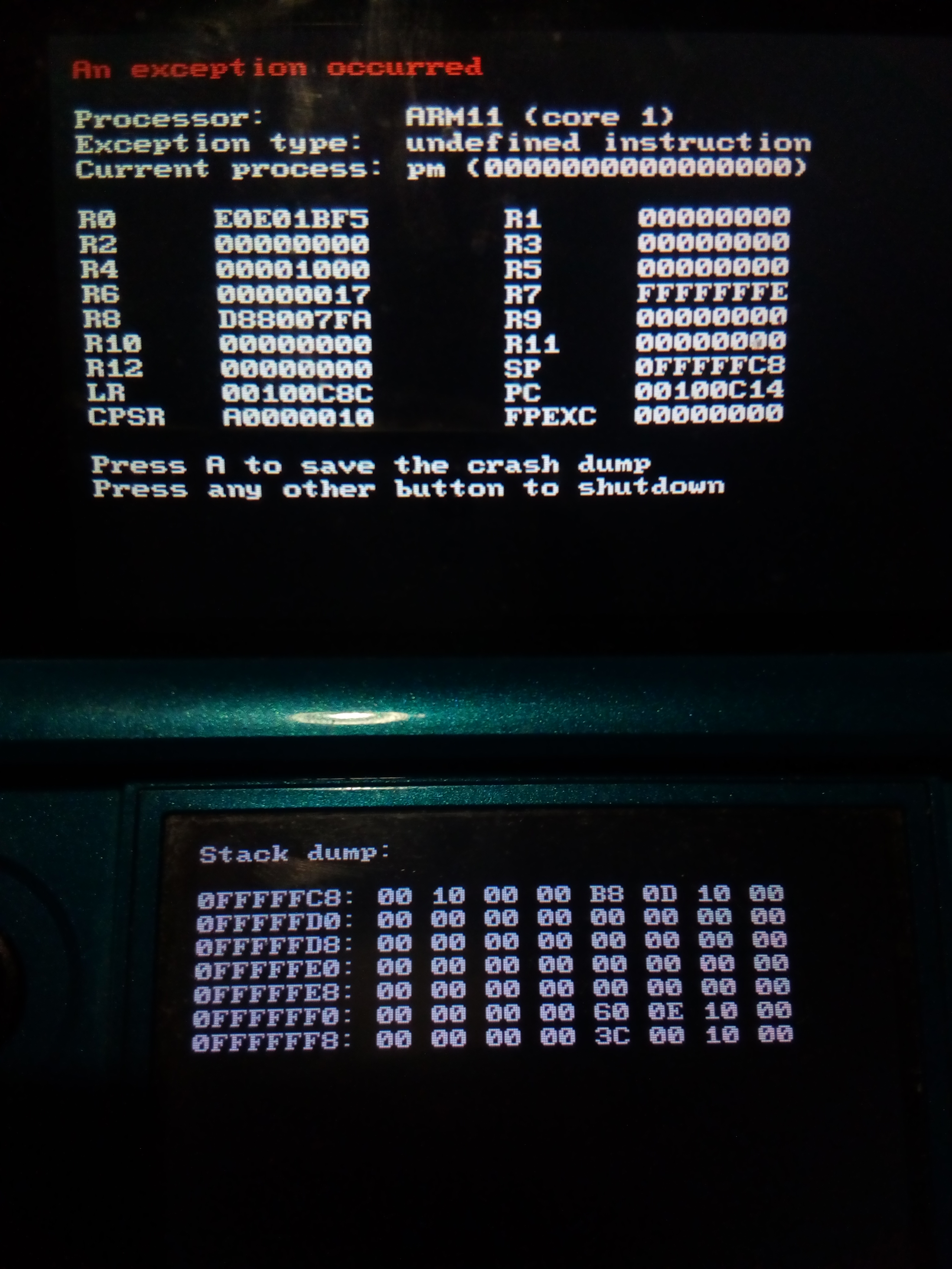

It says things like unexpected instruction and prefex error abort or something along those lines
Specific error messages/screenshots would be helpful, as well as what applications/games/circumstances are causing the crashes
Sometimes it is immediately after booting into Home Screen. One of the main apps that causes it is ace attorney trilogy. I will try and get pictures.
Here are some photos of similar errors I found online and a video of what the 3ds is doing
You were asked for specific error messages, not "similar errors"! Small differences can mean entirely different things when it comes to diagnosing issues such as this!
Those images are VERY different things. PM is a error for the DS firm. and the other means something different from that. You cannot go by similar as they are all likely different.

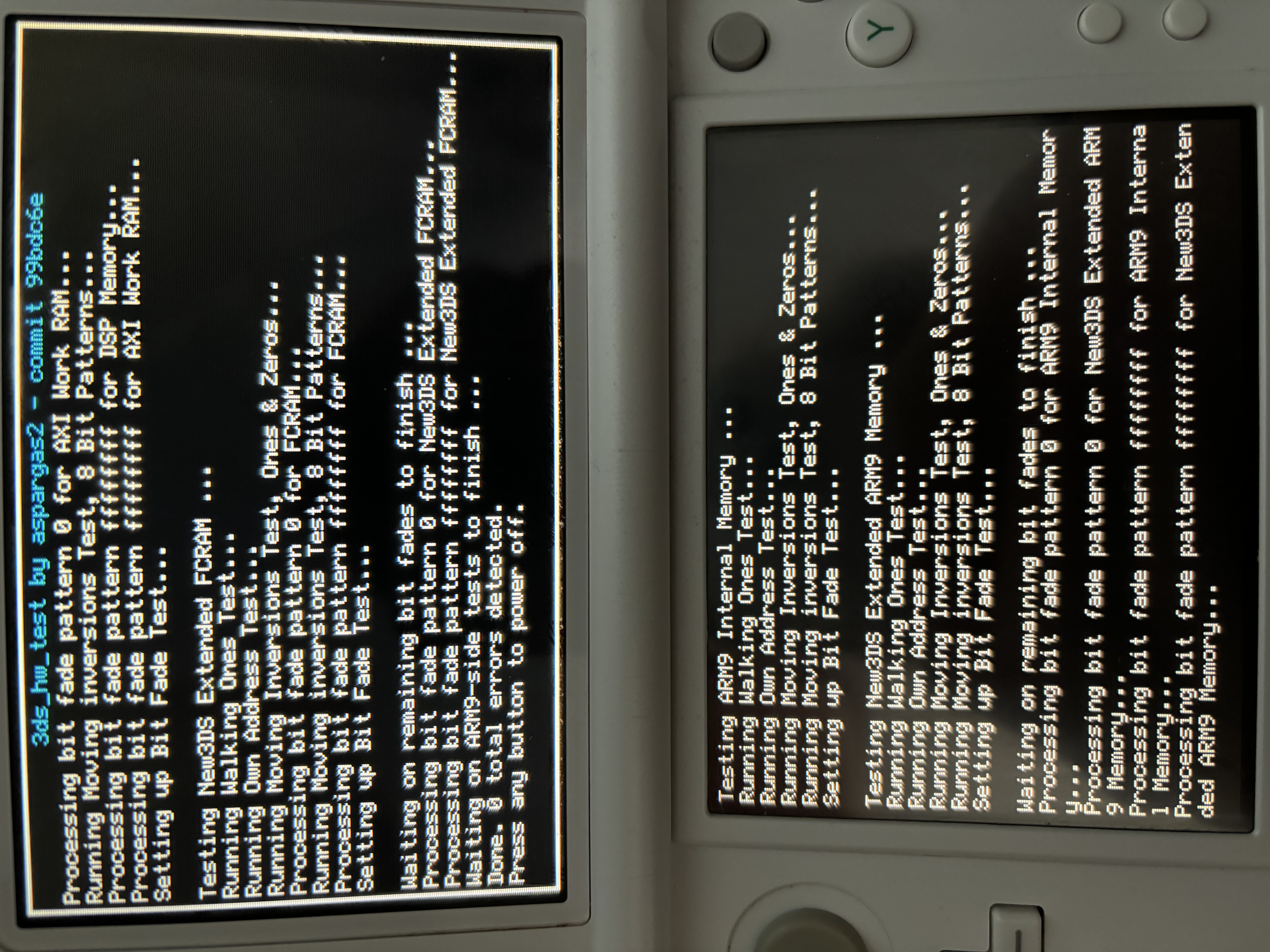

= Please run a hardware (memory) test. ………………………… =
= https://github.com/aspargas2/3ds_hw_test/releases =
I will try doing this to the 3ds. I couldn’t post my errors as it was working at that time, but when it does do them I will post a photo. Would the crash dumps be useful as I have saved quite a few of them?
I have the results. It says 0 errors detected
the results say 0 errors detected. I will attach the picture.
also, the problems with the cfw seem to have stopped. Now the only problems is that sometimes when I turn it on the touchscreen and circle pad will be acting strange.
