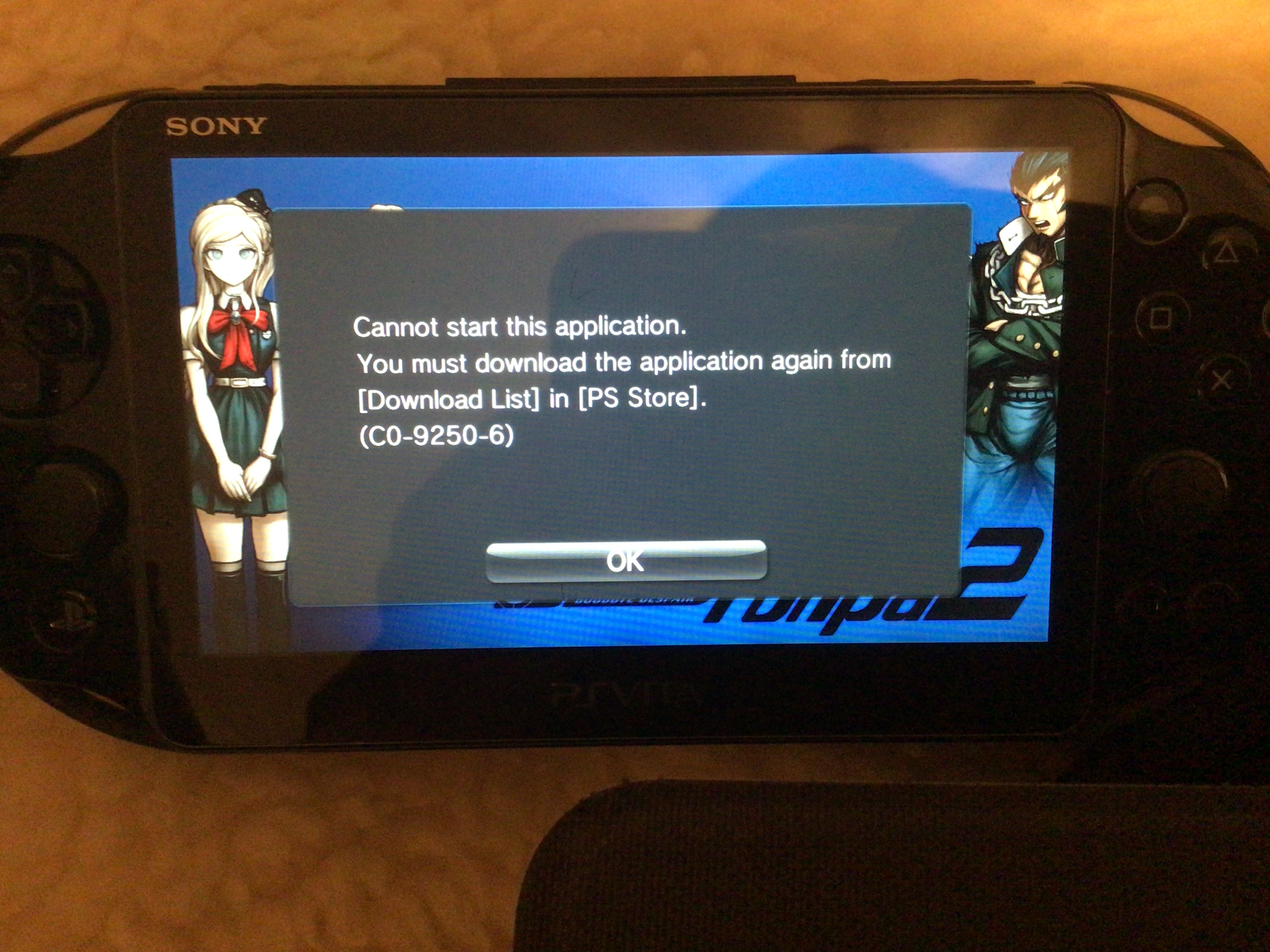

So, I bought a version 3.0 sd2vita since Sony memory cards are ridiculously expensive, and I’ve been using it for a day or two, when some of the apps and games started having problems reading the files on it. I tried to open terraria when an error popped up, that I should reinstall the game from the download list. Now, I’m using pkgj to download my games, so I went there, and it said that NoNpDrm is missing. This is when I realized what was happening, since I only installed NoNpDrm on the microSd card I was using, and not onto the vita itself. I tried to open a few other games, all showed the same error, but curiously enough, when I checked vita shell, all the game files were there. I formatted the memory card and loaded all the content back on, the error still continued happening, even after a reboot. What is strange, is that my GBA emulator was able to read the GBA games on the micro SD, unlike any other app except vita shell. This made me unsure of what the problem was.

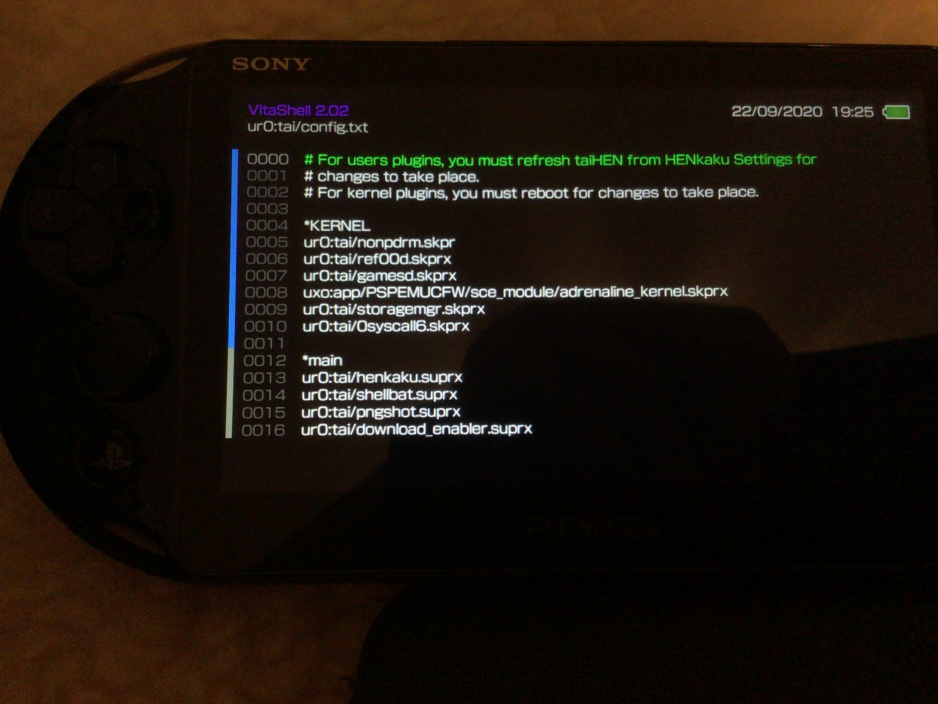

Here’s the config.txt and the error message I get when I try to open any game.

you have storage manager and gamesd.skprx. you only need one or the other. you also have ref00d and 0syscall6. you also need one or the other.
0syscall6 is probably the superior of the two. also, you should install yamt, which is superior to storage manager and gamesd. it installs to boot_config.txt, so it's quite a bit faster. I use the lite version, which has mass storage and ux0. I think the full version might have more.

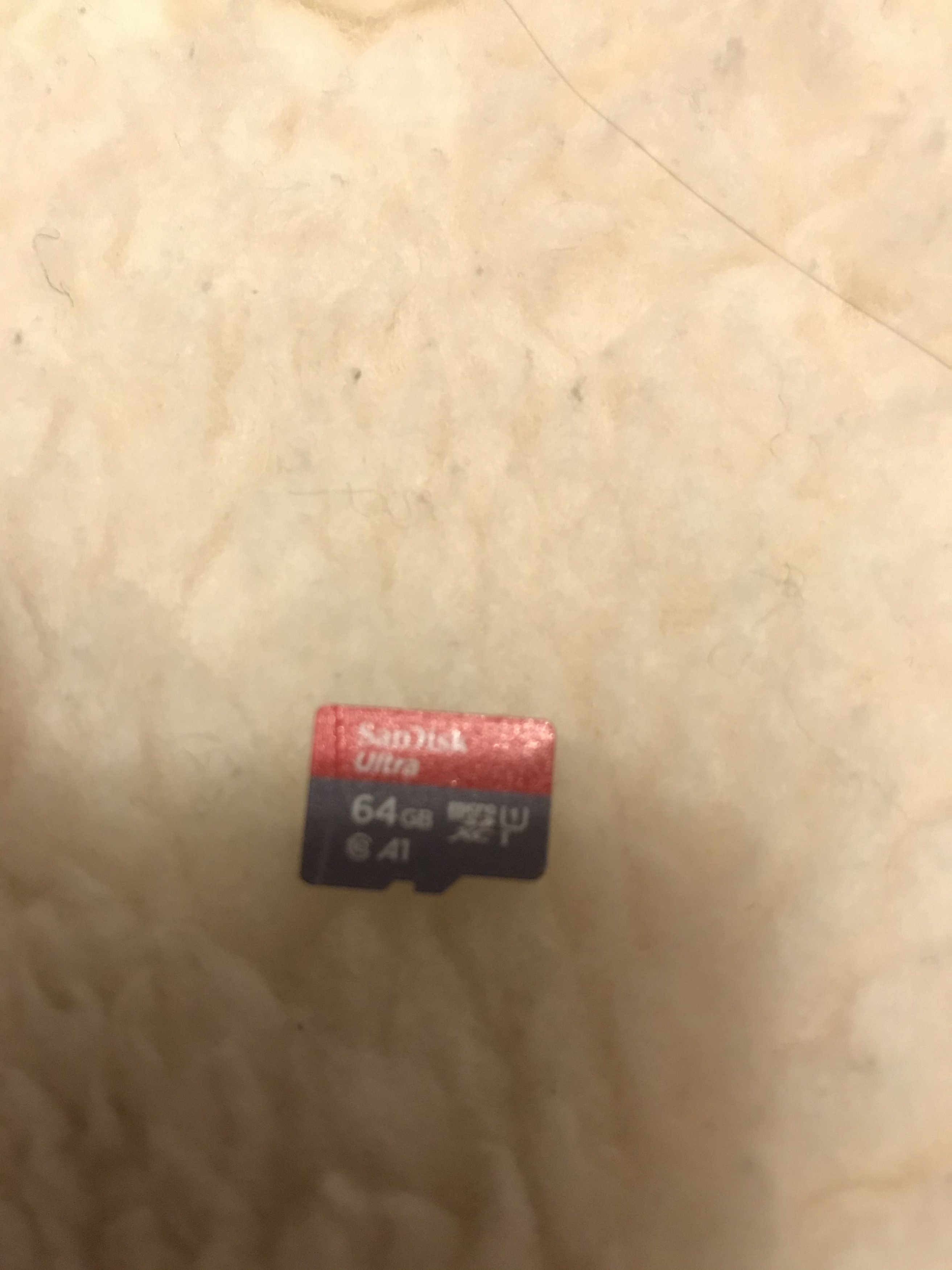

What is the brand of the memory? I just bough one off brand that as listed as 128gb and it appeared as 128 but upon a H2TESTW it turned out the card was 32gb.
This is the SD card:
It’s 64 GB like it says. I’m going to try to get rid of the unneeded files and I’ll try out the new adapter once it arrives, so after that I’ll know where the problem is.
Tried removing some of the things I didn’t need, sadly it didn’t work, but I’ll try to reinstall ref00d and gamesd, I’ll see if that works. If it doesn’t I’ll just wait for the new adapter and see, but maybe I’ll just reinstall most of the skprx files that I had. Thanks for the help so far!
I suggest putting gamesd or storage manager first in the list of kernel plugins. then, place nonpdrm.
Reactions: Eiiru
Thanks, I’ll try that!
Hey guys! The problem is fixed! I edited the config.txt and reinstalled all plugins and now it works just fine! Thanks for all the help
