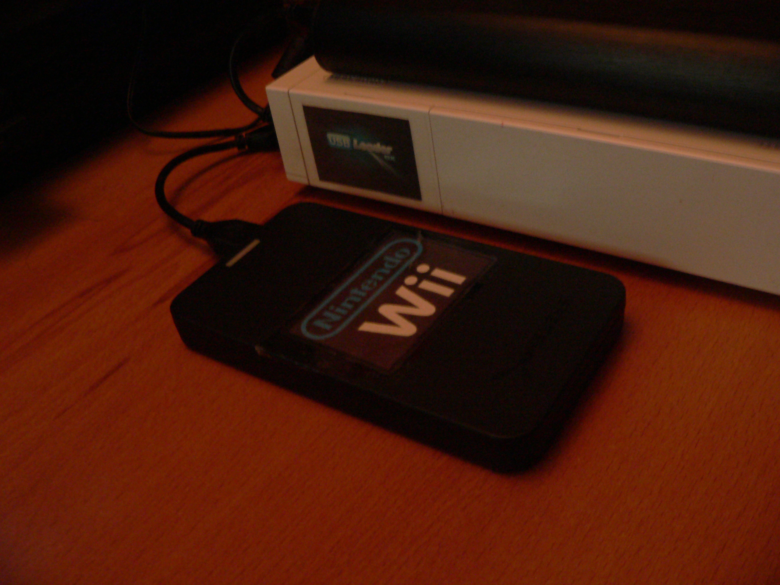

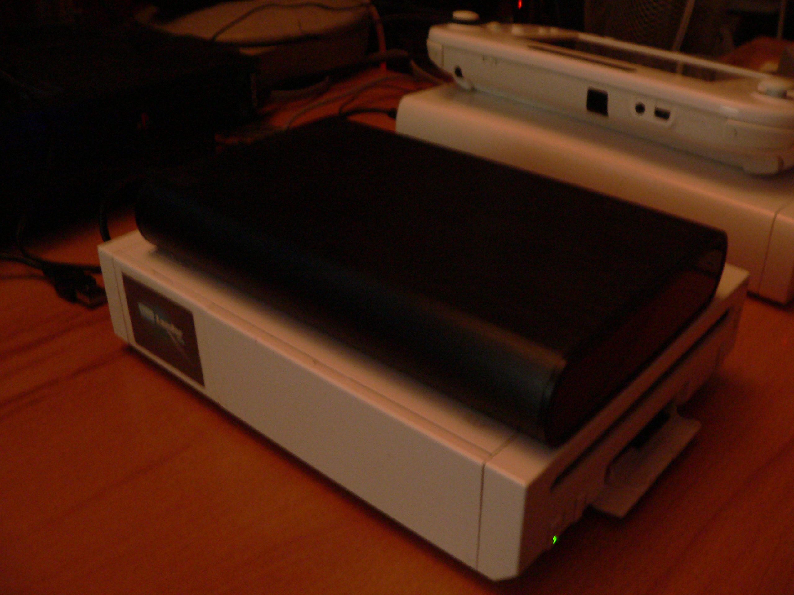

Report for @DacoTaco
Yes as Expected,it has to do with the Enclosure (controller).
This One works normal:
This one has the 10 Second "Penalty"::D
Thank you.:)
