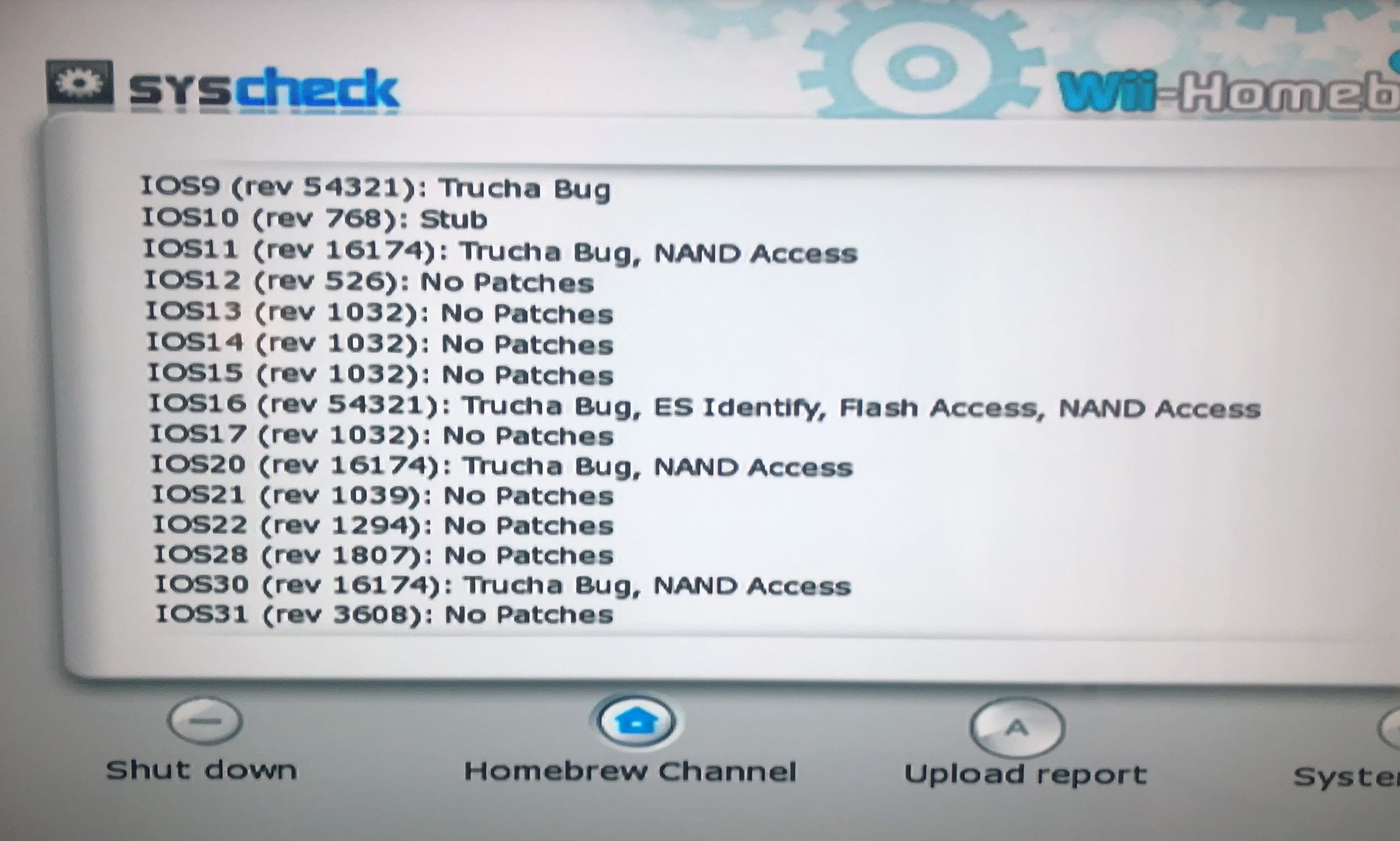

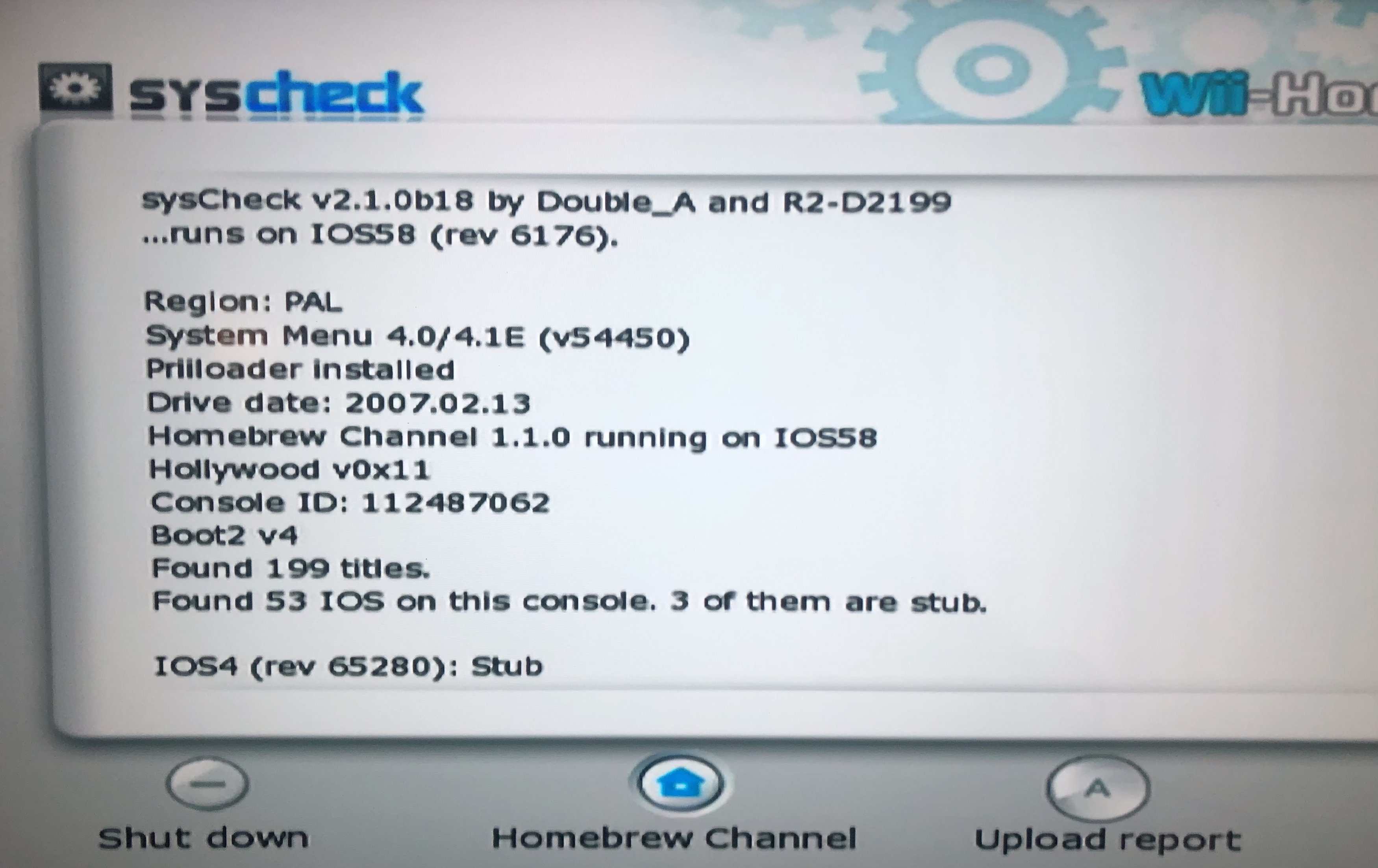

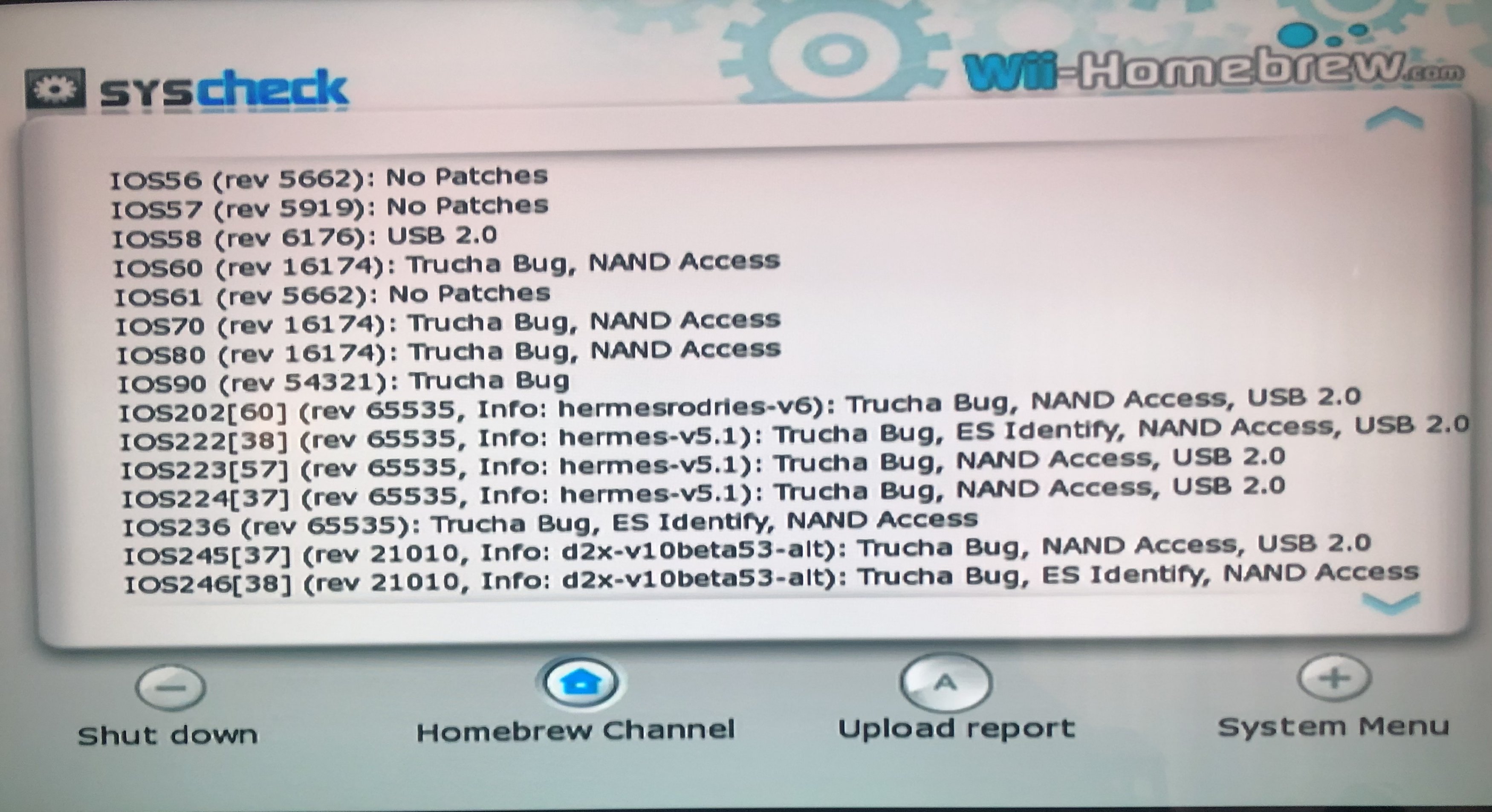

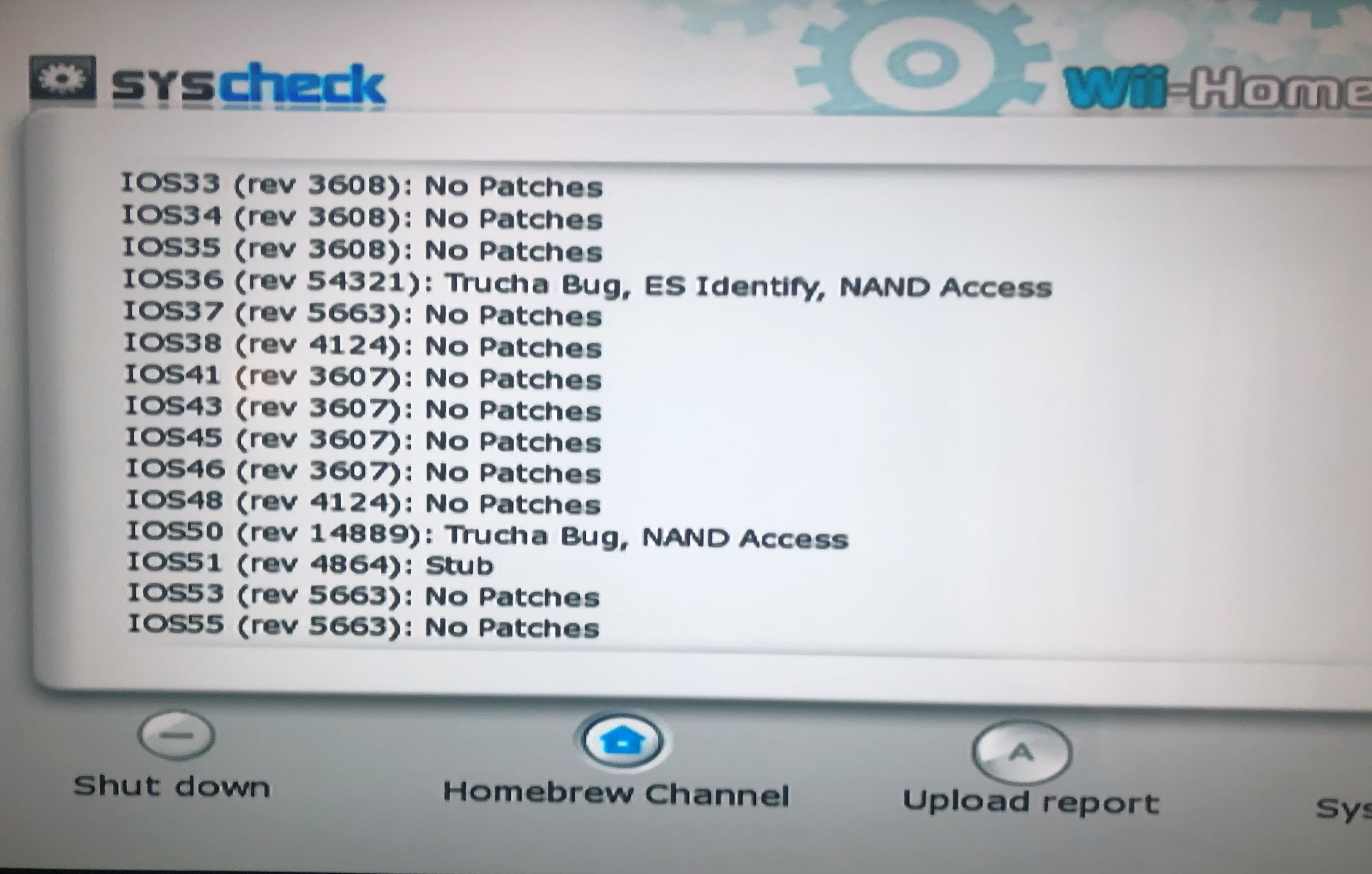

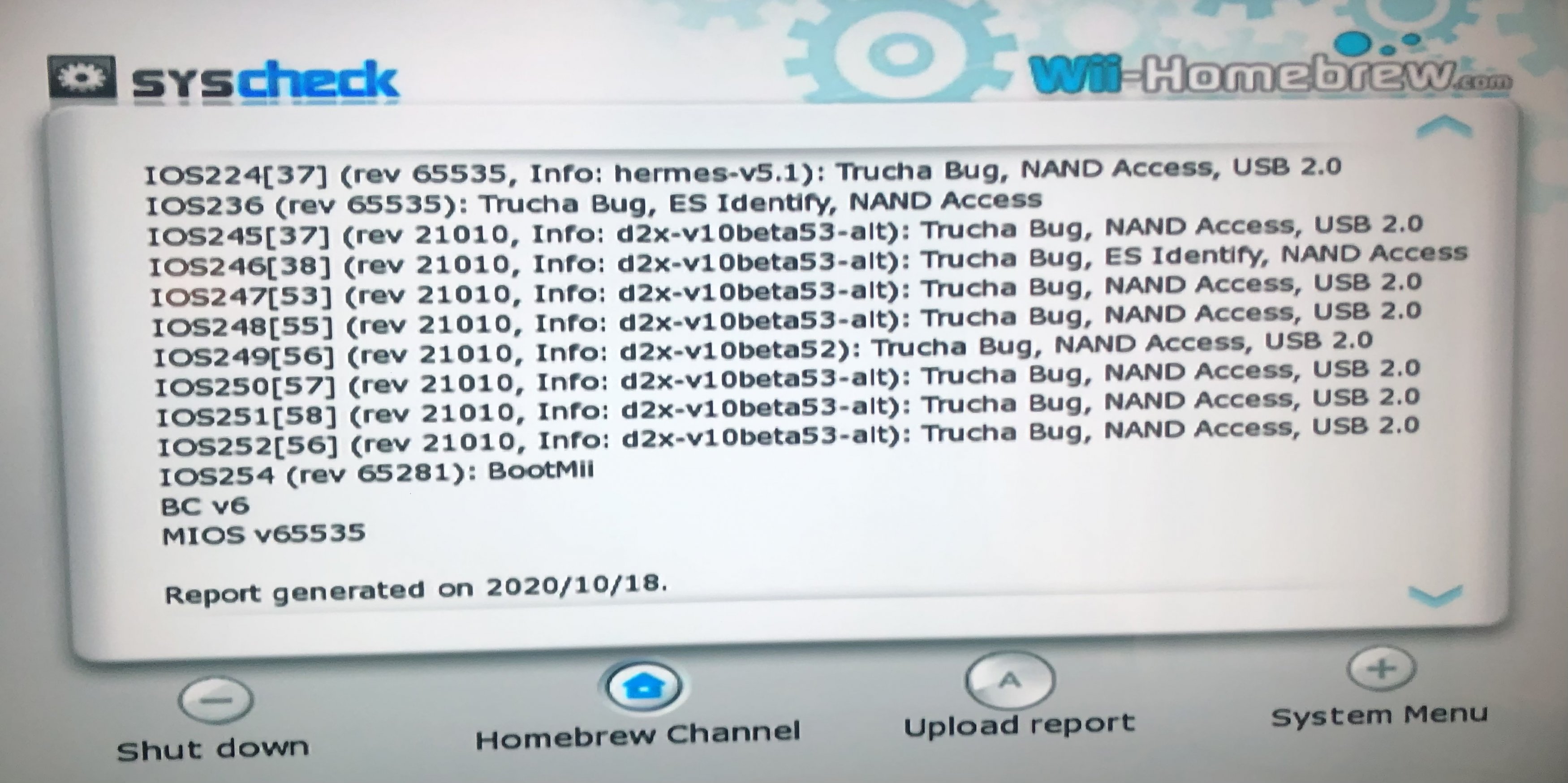

mind posting a syscheck?
i suspect its refusing to install due to something like DarkCorp or the unofficial system menu version you installed.
Unfortunately I wasn't able to write to the FAT partition! Not on my HD and not on several SD-cards.
So here I go with some screengraps.....

ye, priiloader is refusing to install on the modded system menu.
you need to install a good, vanilla system menu to install priiloader.

Or maybe another possibility is an older version of the HBC that doesn't support ahbprot?
Edit: nvm, didn't see the above post. I note that the version of the HBC isn't the latest, but it should still be new enough for it to not be the issue (I think)
