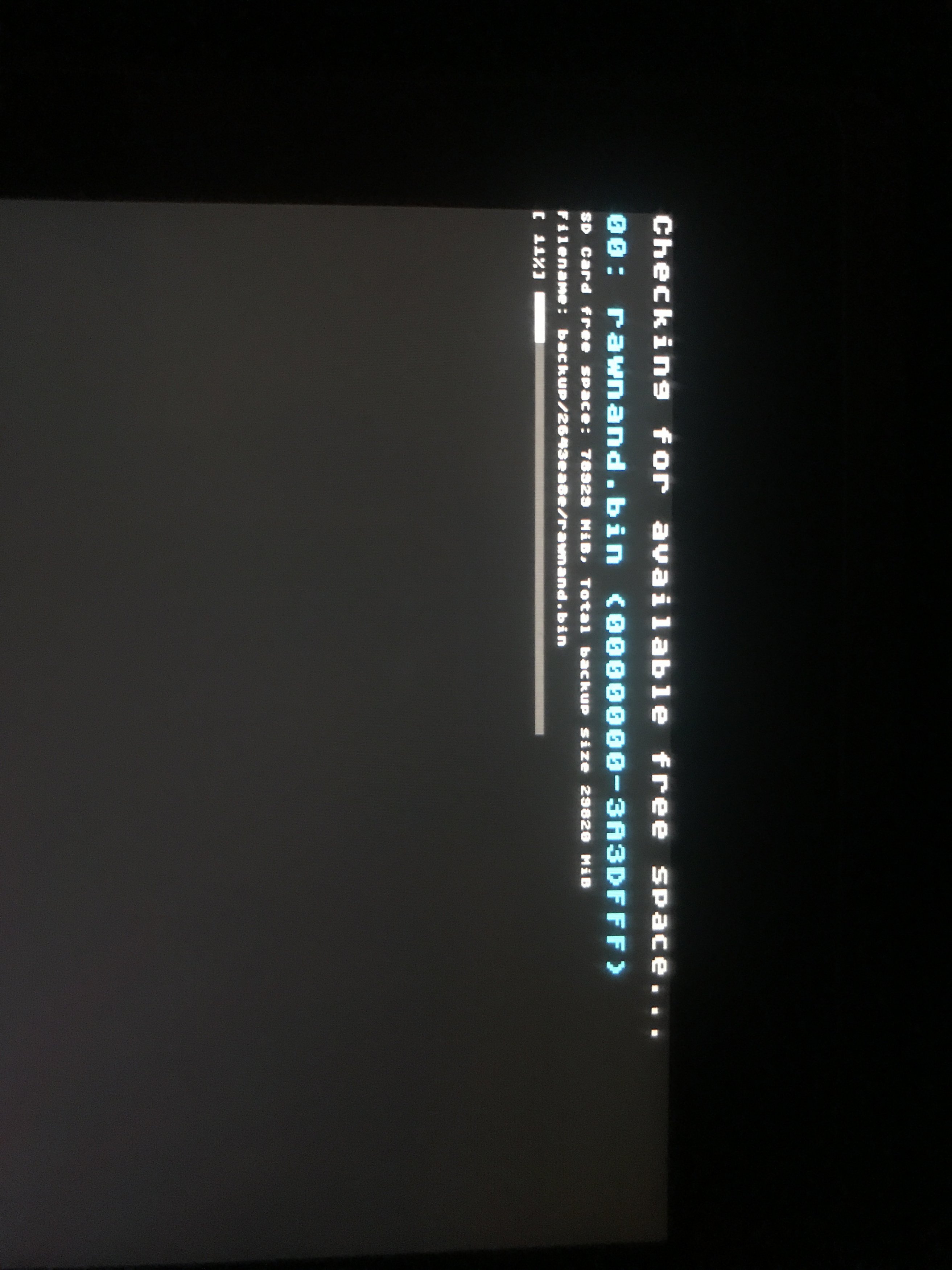

I’ve managed to get the Keys.txt file backed up but I’m working on backing up the eMMC RAW GPP. I have more than 32GB storage so I should be fine. Not sure if it’s stuck or the process takes a very long time but I’m leaving the switch on the dock overnight night and I’ll check to see if it backed up the eMMC RAW GPP. Hopefully I’m on the right path!
yeah it takes around an hour to do the backup normally iirc

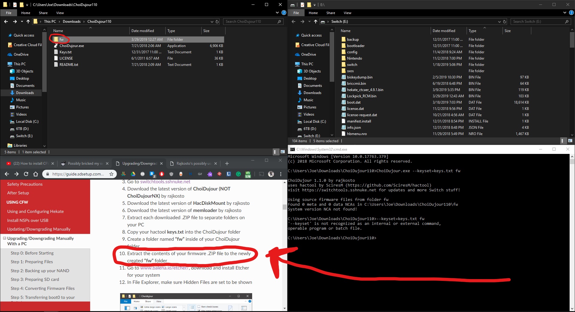

So I'm not sure how to use choidujour and it didn't seem to do what it described. I have nothing in the "fw" folder. it says to put the "firmware .ZIP file to the newly created fw folder." I dont know what files i need to put in. So far ive gotten the Keys.txt file, and ive backed up the eMMC RAW GPP.
Also not sure of what to do because I use SXOS and no other types of CFW
I guess what im trying to say is im not sure what to put in the "fw" folder
Ooooooohhhhhhh... I think i mightve found what i needed from the "dark" site. For fw
Ummmm so ive tried using OFW versions 6.1.0, 6.2.0, 7.0.0, 7.0.1 and all of them don't work and they fail to match the "keys." It says failed to execute script ChoiDujour
ive also used keys.txt files from both the biskey and lockpick methods and neither work
So far I have created an "NX-6.1.0_exfat" folder which contains the firmware update. I kept seeing people are supposed to use their own keys.txt file but mine clearly didn't work. So I found someone online who posted their keys and "fw" folder and people on the forum said it worked. It worked for me and I was able to make a 6.1.0 firmware update with choidujour. all I had to do was replace the TSEC key with my own set of numbers. Right now I'm at STEP 5 of the guide but nothing shows up in device manager under "disk drives even after i hit ums_boot0.ini in the memloader.bin payload. This guide is very difficult
