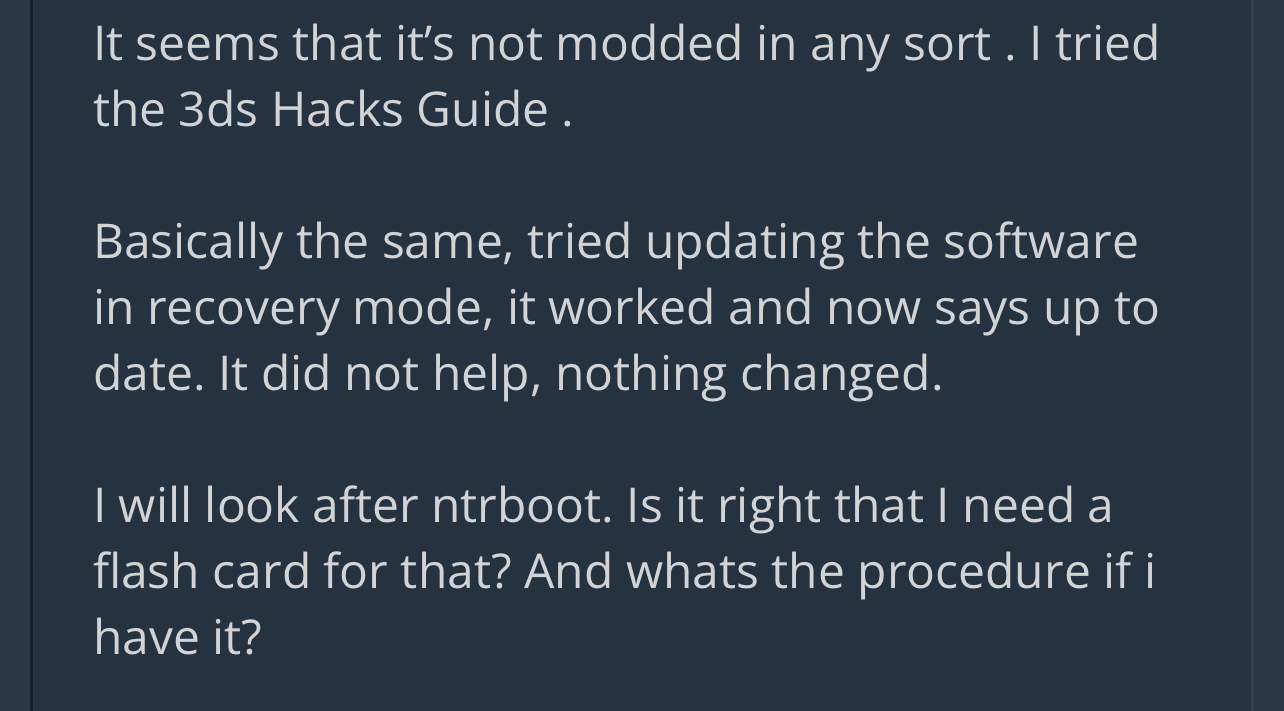

I know its been a while, but I have the same issue. Did you get it to work? Maybe I can fix mine too.
I am not sure if my 3ds is modded so I guess not? I tried to mod it but the problem is it isn’t creating the 3ds folder on the sd card because it won’t start
In order to check anything we need access to homebrew/CFW tools.
For an unmodded console this leaves ntrboot.

It says there are forbidden keywords, trying it this way
