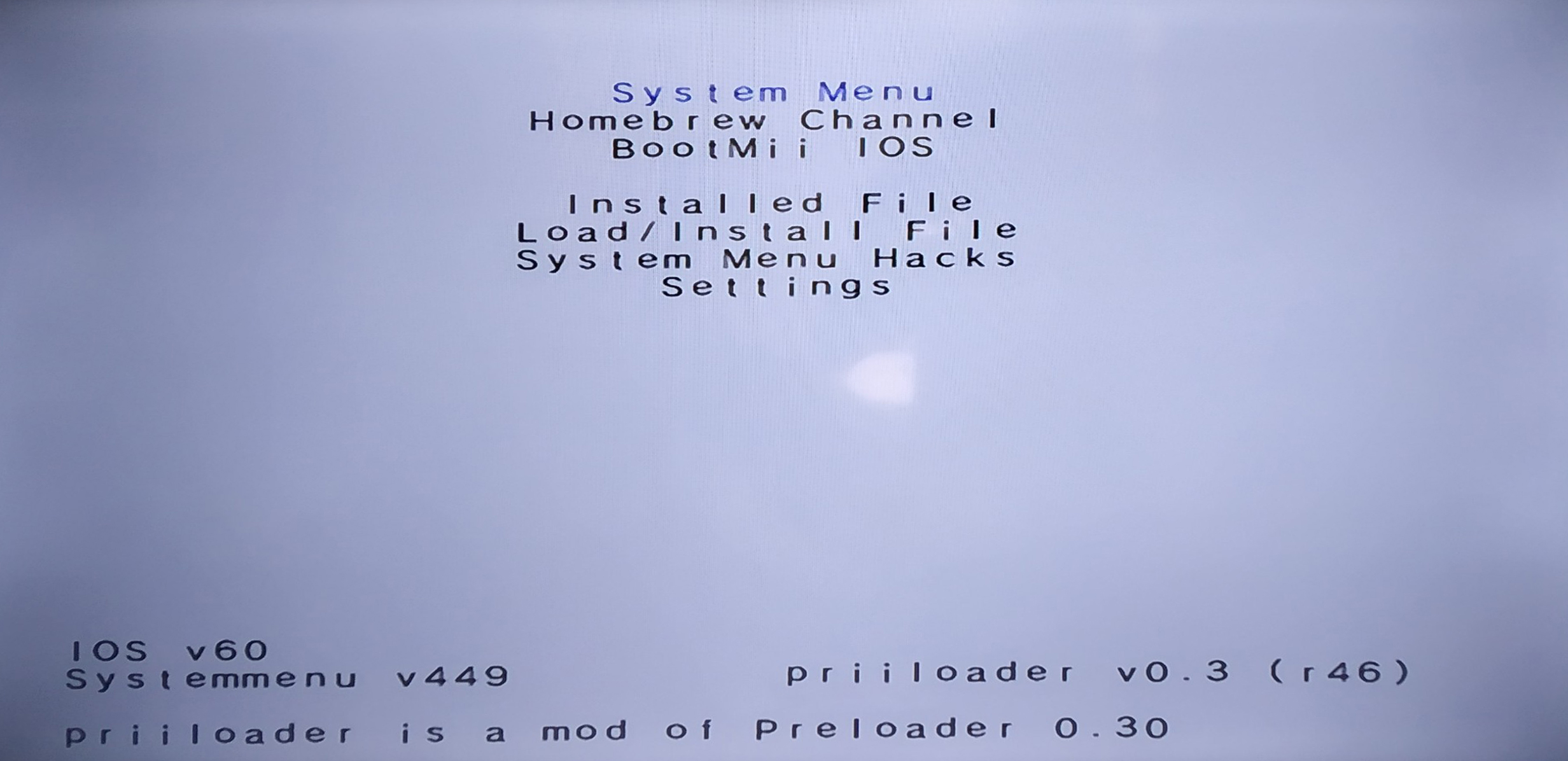

dear all.
my Wii have a big problem, please help
i turn on Wii, and this screen display (attached file), i try press any button on console and wiimote but nothing result
please help me and my kids
thanks,
You can try a USB keyboard. I'm not sure what version support for it was added to priiloader. Unfortunately older versions of priiloader basically only work if u have a synced wiimote. This is why I advise against changing the autoboot setting from system menu.
Hmmm,if your console has bootmii installed to boot2 u can bypass priiloader. Try inserting an SD card with sd:/bootmii and if installed as boot2 it will load a different menu which you can navigate using the power and reset buttons on the front of the console. http://static.hackmii.com/bootmii_sd_files.zip
Unfortunately if u try booting the system menu from bootmii it will take u to priiloader first. Bootmii will allow u to launch the HBC though, or restore a nand backup, or launch a couple other things. Unfortunately if u boot into the HBC I think u still won't be able to get to the system menu and sync a remote without a gamecube controller

Hello.:)
I am afraid,there is no Chance.....
Wii Button Support and USB Keyboard Support added only in the latest v0.9 Betas...
...that is this unfortunately "without GameCube Controller" no Chance Case we have all talked about in the last Years....:(
We can only hoping,that BootMii/boot2 is installed and is working.:)
Good luck and
Thank you.:)
