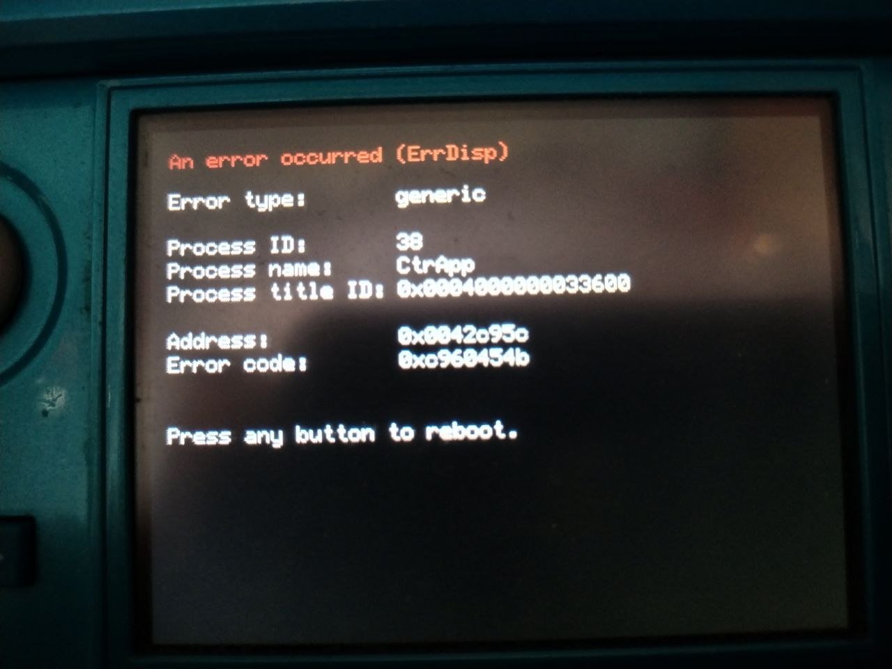

This error comes when i play my ds for 10-15 minutes. I checked process title Id and its pointing on some system xorpads file. Please help i guess i need to deal with my SD card
That's the game itself crashing. This error happens with any game?
Most likely a bad/corrupted SD card. You can try running Check Disk to check for corruption (for a more in depth scan run chkdsk /F /R /X SD: in command prompt, replacing SD: with the correct drive letter), that might be enough to fix it.
Yes, this error happened for any game. So cheking for corruption didnt find any of them but i guess it worked cuz my ds worked for an hour without any crashes so thank you
