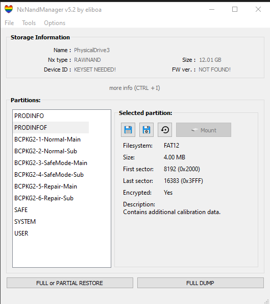

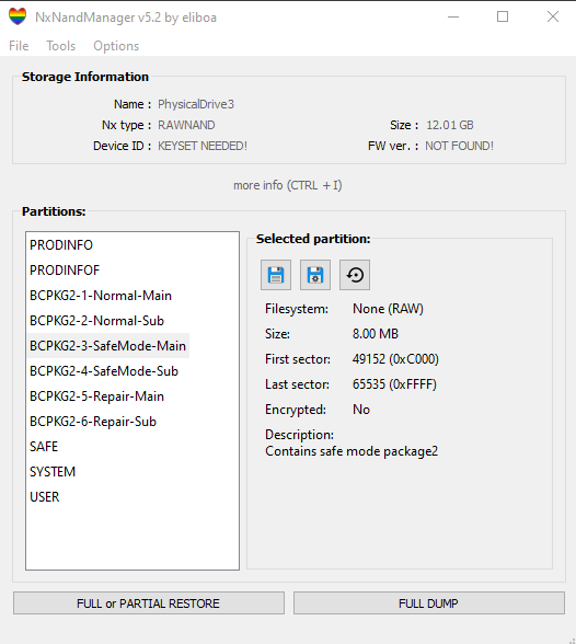

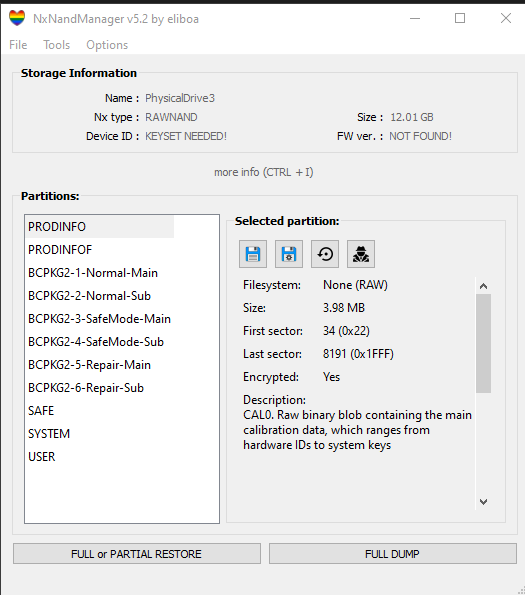

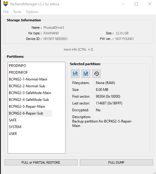

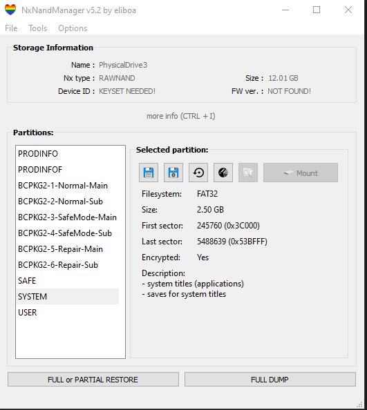

Here it is. The problem is mostly nand based tho.
Lets no mix up things here.
the SD Card, is no the main issue here.
if you see the Console screen shoot shows the main storage EMMC as only 9.3 GB free, sadly HOS do not show TOTAL EMMC size.

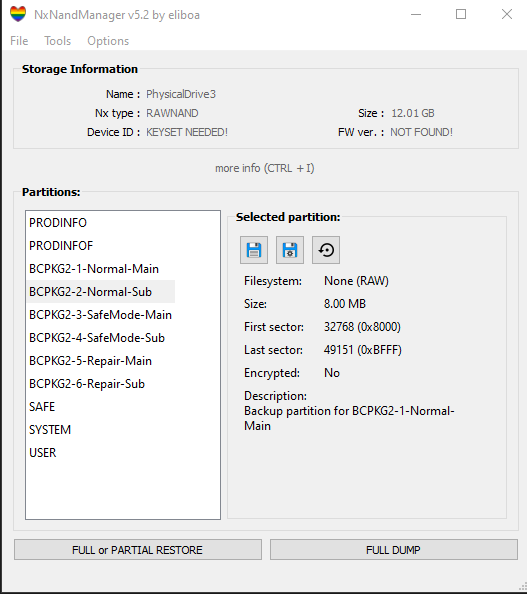

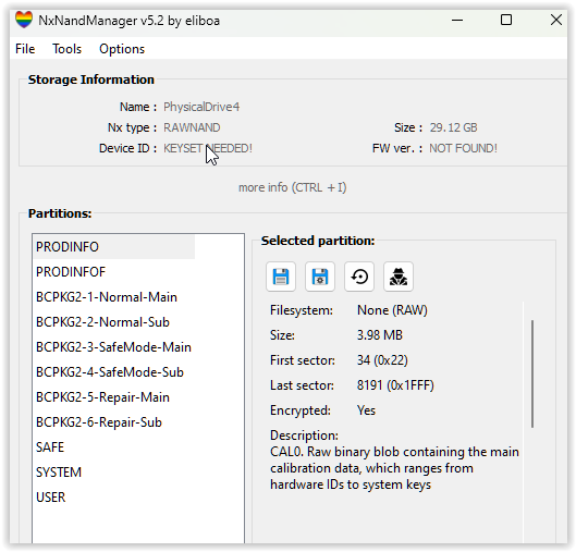

can you boot on Hekate and mount the eMMC, going to the tab «tools» then selecting the button «USB Tools» and then selecting «eMMC RAW GPP» and please connect the console to PC and let see the usb disk pressented to windows, should be something like:
(mine is V1 so only have 32GB eMMC)
After that run NXNandManager https://github.com/eliboa/NxNandManager and select open drive:
select your console
share this same screenshots with us please.

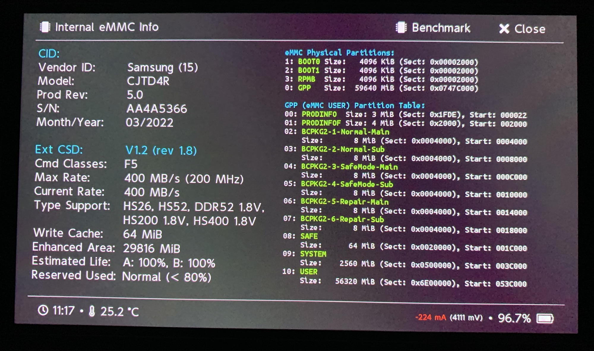

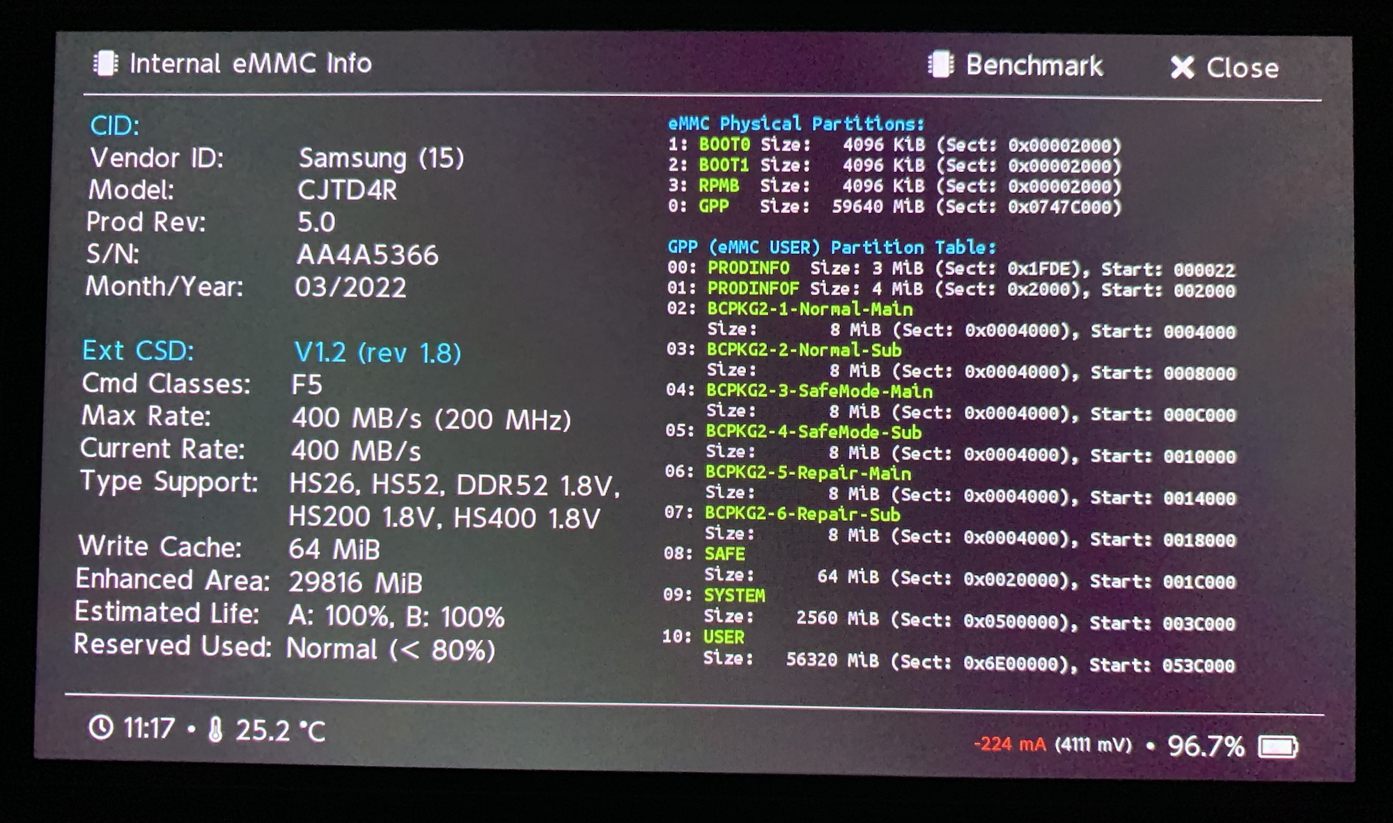

boot to hekate, go to console info, emmc and take a screenshot, like this one:
probably you messed up your emmc gpp partition table by restoring a 12GB emunand backup into emmc before. You can mount the raw emmc via usb and expand the user partition in nxnandmanager
  • Love
Reactions: BigOnYa and impeeza

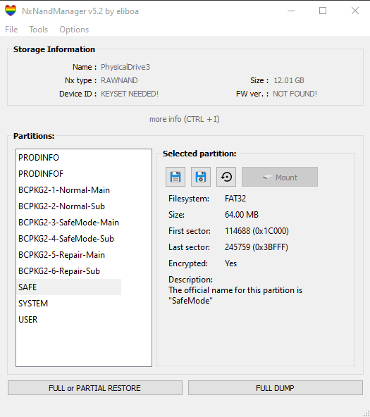

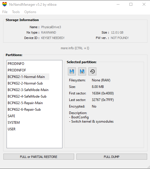

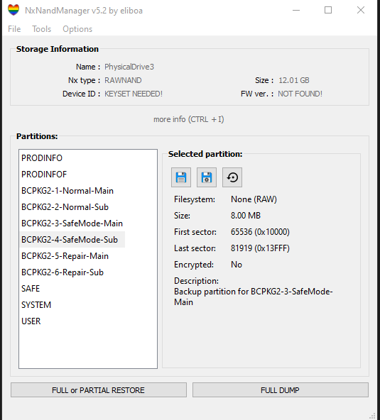

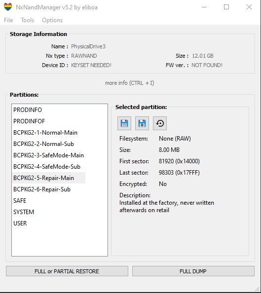

please take screenshots of each item on the left.
