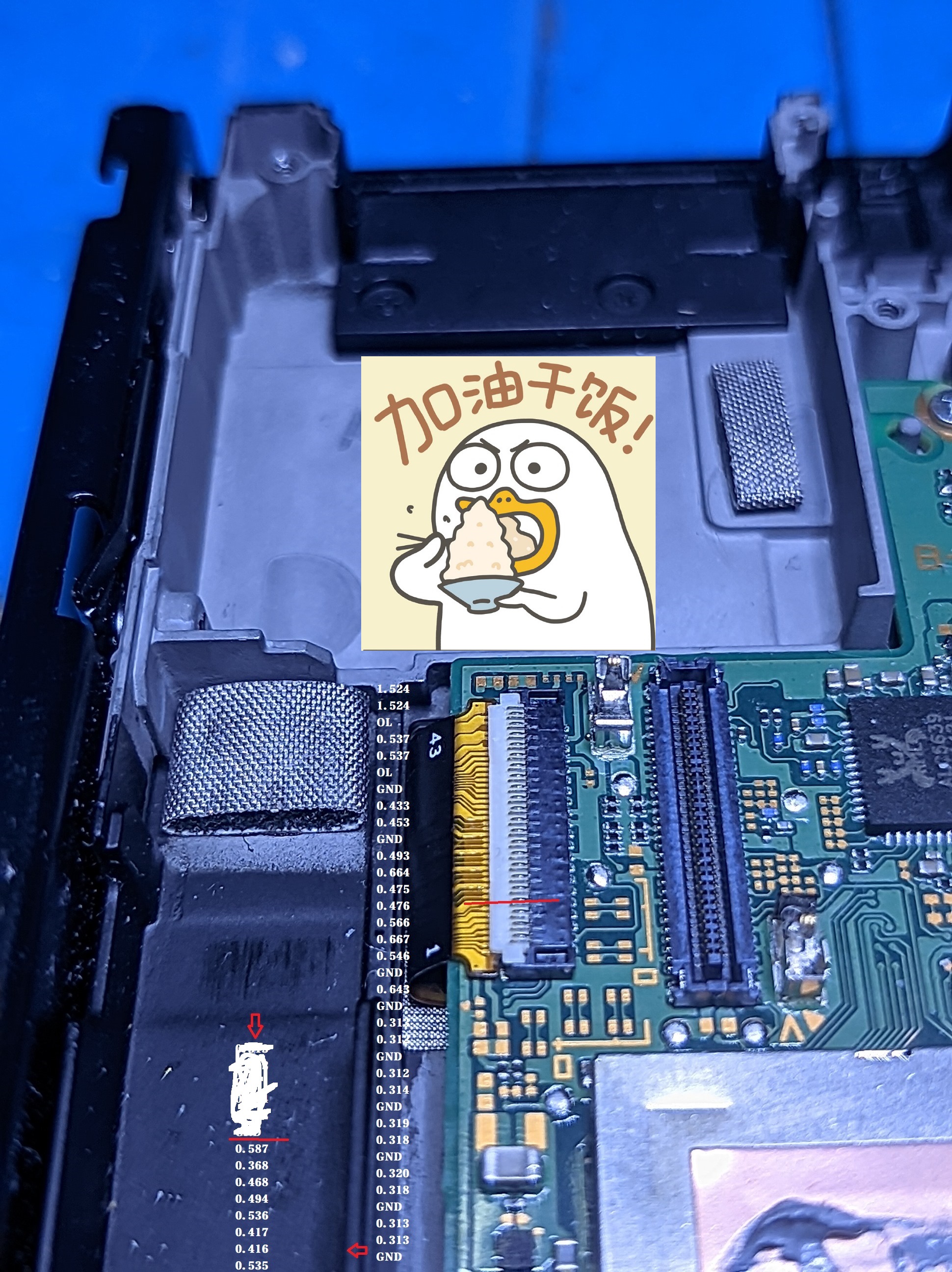

Thanks for the message, unfortunately this doesn't seem to be the issue I'm having the pins in the connector are straight and working, I've replaced the FPC connector twice, once from the donor and the second time to a brand new connector but still no display, I've tried with both original and known good screen after each replacement, and both times the touch screen works but no display
since you tested with know good screen and new connector still same issue, you prob should check connector pins diode reading if any bad.
for reference:
