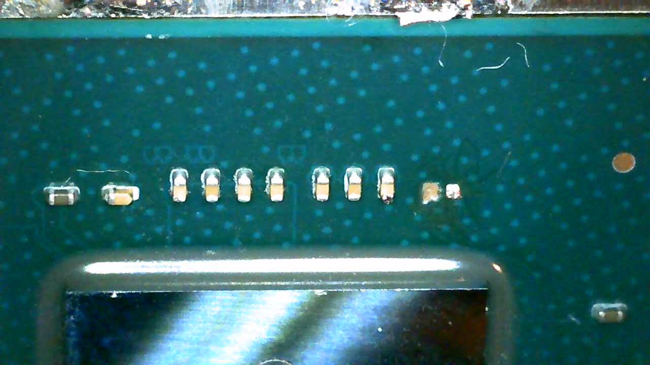

i tried to install on the nintendo oled the rp2040 and unfurtunetelly the pad of the capacitor move out and noe the nintendo not turn on
someone knows how to fix this issue?

Seems you knock out a capacitor and even rip off the pad, so unless you are a very skilled welder and be able to restore the trace of the cap and replace the cap you get yourself a brick.
does any temper knows if this cap damage can be repaired?
Reactions: Fritss
sp2 CAP is broken as well but pads still there. The switch is able to turn on without those 2 caps, so you need to find out something else why now it does not turn on before you solve these 2caps
