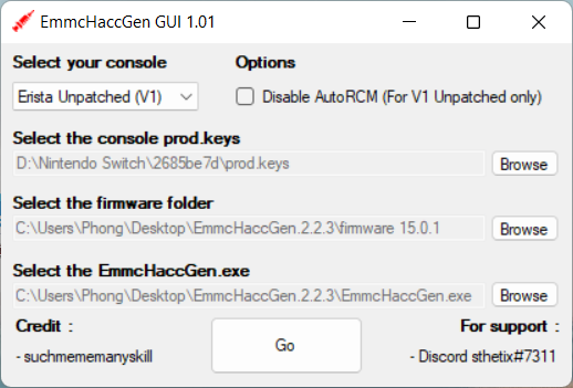

For HDD bad sector repair software, I don't know. But did you try emuhacmmc to generate a new NAND restore with your prodinfo.bin? I think it should work.
