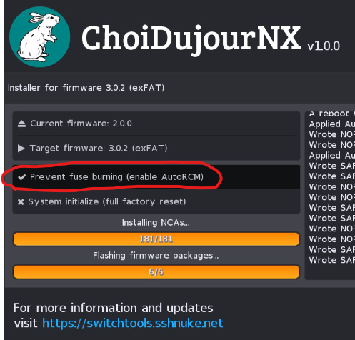

If so be careful trying certain rcm apps. You have been warned.
Yup!
There was an homebrew called ChoiDujourNX that we used back when there was only Erista and some ppl used it on Marikos and ended up with a V2 console in AutoRCM with no easy way of removing it.
Eventually it was sorted out and along acme Daybreak and now it's just sun and flowers :P
Now Hekate also doesn't allow you to set AutoRCM for patched consoles.
Reactions: Donnie-Burger
Yup!
Choi messed up boot. But yeah some apps brick mariko aulu in rcm attempts.
Reactions: mvmiranda
That also! :D
There was a tiny checkbox at the very end of Choi that was used to "install" AutoRCM and if it was left checked in a Mariko console, BAM, you'd be in a though situation :)
That also! :D
So was it actually triggering RCM or messing up boot 0/1 or both?
