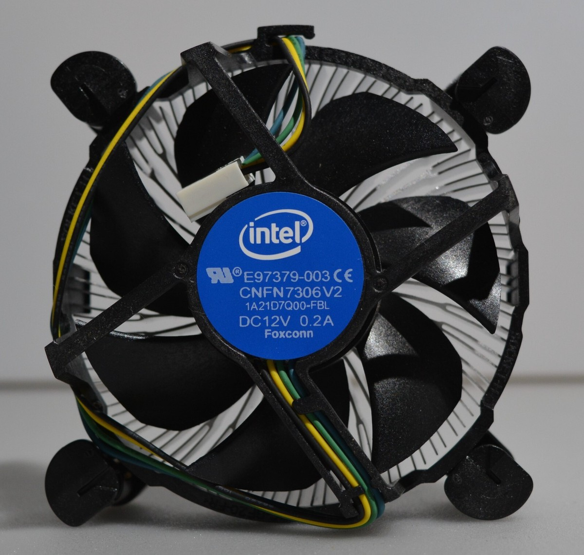

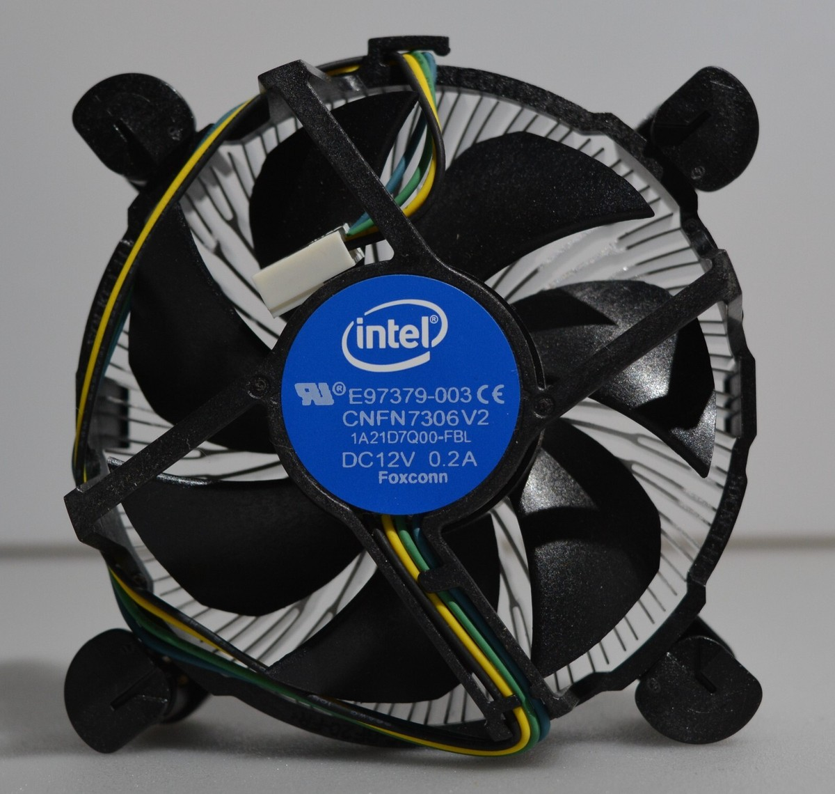

What cooler is it? What's the airflow like in the case itself?
This post will have to be merged as I have just now seen this but I am actually unsure of the cooler due to it being pre-built. it seems to be an OEM cooler
This is the closest I could find.

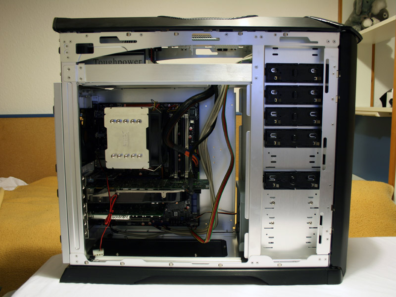

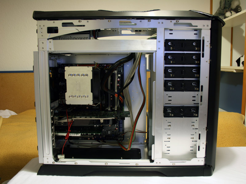

the case looks like this (not my picture but gives a basic idea of it's air flow)
There is one fan to the left (which is pictured) and one on the top of the case, however it is dead. the GPU's fan is loaded at the bottom of the card so it blows hot air away from the CPU. So the only 4 fans are the CPU, the one on the left which sucks air in iirc and the GPUs fans which are away from it.

Probably better off changing your only intake fan into an exhaust fan. I mean it’s good to add fresh air inside but with no fan to extract it, it’s just being heated up to circulate inside. The stock intel heat sink and fan is also not very adequate for more than just general computer use. Any cpu intensive game will cause it to exceed it’s usefulness.
Reactions: Skv0ra
Well firstly, it sounds like you have no actual airflow in that case. One fan might draw in air, but the GPU fans aren't dumping all the air out of the case, most of that air is being dumped right back into the case, and if the fan that's meant to be moving air out is dead then you're likely roasting the inside of that case. Replacing the failed fan should help some things.
You also likely have one of the shittier Intel stock coolers, they used to put copper slugs in them years ago which made them more than adequate for any of their CPUs, but at some point they opted for just full aluminum and now they suck for anything but light office use. Replace the cooler, pretty much any $30+ air cooler will work infinitely better than the Intel stock cooler. Don't bother with liquid cooling, unless you plan on high OCs there's no point wasting money on liquid cooling when any modern tower cooler will work just as good.

That case is a coolermaster case and should be able to mount 4 more fans as there is supposed to be a door that holds the four (4) fans to the side of the case. That is why you see two (2) notches on the silver side of the case located to the right. I own one of the case but it isn't as good shape as the picture.
If you are in the market for a cheaper air cooler, I would wholeheartedly recommend the Thermalright Assassin X. It's under $20 and just works. I have one in my second rig (More or less a home lab), and it never gets above 66 °c on a 9700k under full load
