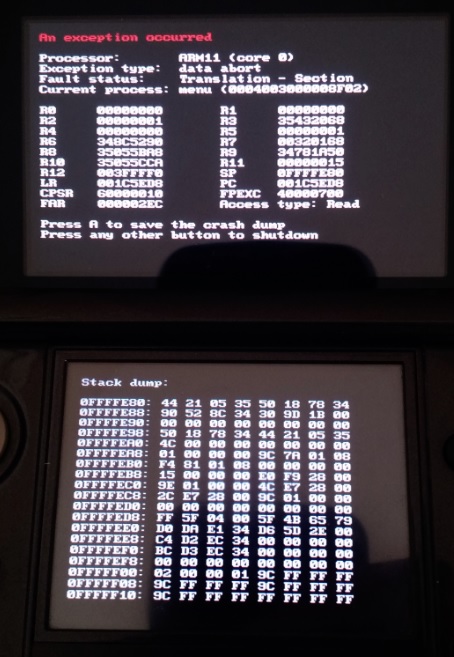

I've been following the A9LH to B9S guide, and have hit a point where my 3DS is crashing when I power it on. The last step I took was to install B9S, and then configured Luma. I lost control of the situation from there. For starters, I have attached a picture of the crash info. Apologies in advance for any basic information I missed.

From the looks of it,It seems the menu process (Home menu) is acting up. Your only choice is a nand backup
Maybe try clearing/deleting your ext data first before doing a nand backup :
Clear Home Menu extdata
  1. Power off your device
  2. Insert your SD card into your computer
  3. Navigate to the /Nintendo 3DS/<32-character-id>/<32-character-id>/extdata/00000000/ folder on your SD card
  4. Delete the extdata file corresponding to your region:
    • EUR Region: 00000098
    • JPN Region: 00000082
    • USA Region: 0000008f
    • CHN Region: 000000A1
    • KOR Region: 000000A9
    • TWN Region: 000000B1
  5. Reinsert your SD card into your device
