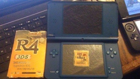

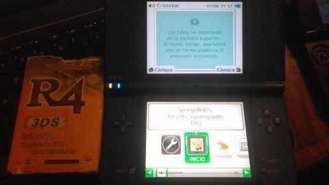

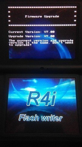

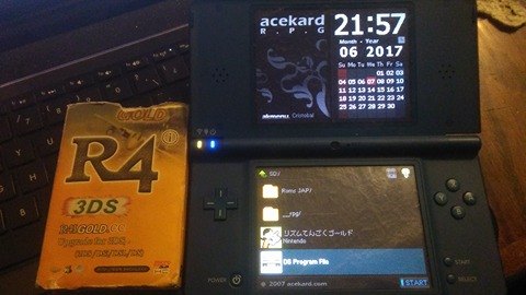

my flashcard (r4igold.cc) is capable of flashing a firmware from a .nds file to the r4
i really hope that ntrboothax is compatible with my flashcard :<
18985327_764300080361978_1187181178_n.jpg 19021520_764300087028644_549539067_n.jpg 19021556_764300137028639_1526677811_n.jpg19021755_764300157028637_28338963_n.jpg
I think it's for flashing the firmware to the flashcart using HBL on an already hacked console.
wait what? HBL? :0
i thought that when ntrboothax is released we'll need to flash the firmware from the flashcard itself....

i bought my friend's DSi XL xd
View attachment 89375 View attachment 89376 View attachment 89377View attachment 89378
wait what? HBL? :0
There's a possibility that we'll be able to use the homebrew launcher to flash the firmware apparently.
