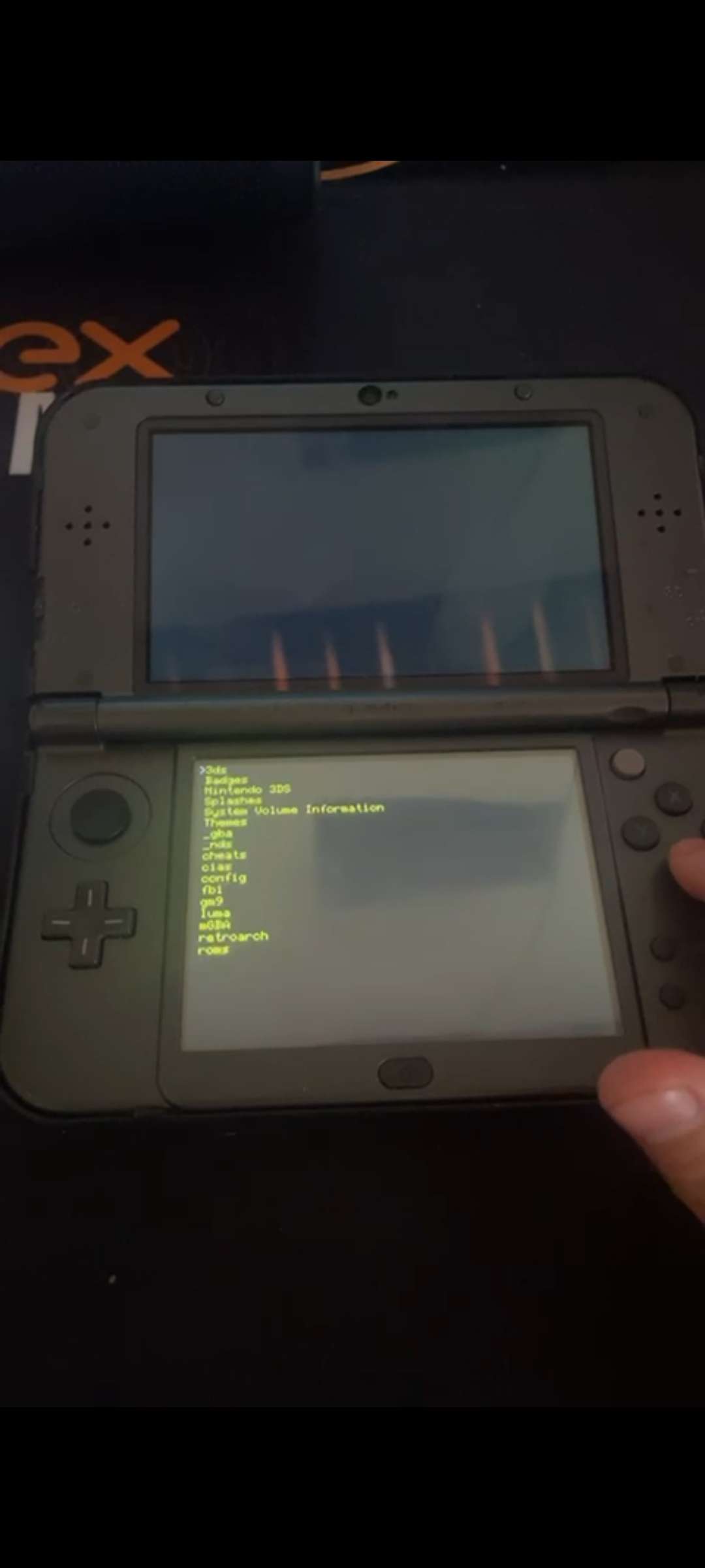

I have a weird problem with my New 3DS XL and I’m trying to figure out if anyone has seen this before.
The console boots straight into open_agb_firm every time I turn it on. It looks like it replaced the CTRNAND boot.firm, because I can’t boot into Luma or GodMode9 from the SD at all. It just ignores the SD completely.
I also tried ntrboot with an R4 that I know works (tested it on another 3DS and it boots SafeB9SInstaller just fine), but on this console it does nothing. The sleep mode is completely disabled too – closing the lid or using a magnet doesn’t do anything, probably because it’s stuck in GBA mode from open_agb_firm.
What happens without SD inserted?
If it still boots into openagbfirm... well...
There was a case where someone replaced B9S in BOOT0 with openagbfirm. Very bad idea of course. This can not happen accidentally as it requires confirming a random button sequence while GodMode9 turns the screen red for warning.
Not going into standby mode is normal during this GBA mode.
This is fixable with ntrboot because ntr cart is checked before reading the NAND when holding the button combo+magnet. Take an empty, FAT32 formatted SD and follow the guide:
https://3ds.hacks.guide/installing-boot9strap-(ntrboot).html
