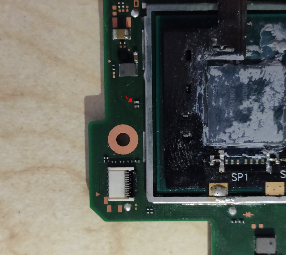

It's usually the wifi chip is dying. I just worked on an OLED switch with this error code several weeks ago, had to reflow the wireless chip to fix the problem. Reflow it first, if that doesn't solve the issue you probably need to replace it. You need to get one used, removed from working motherboard (brand new chips won't work as they need to be programmed). Btw probably not related to you, if you tried to lift the soc shied before, try to check if you damaged those 2 smd capacitors to the left of the soc. If they are damaged you will get this error message.
