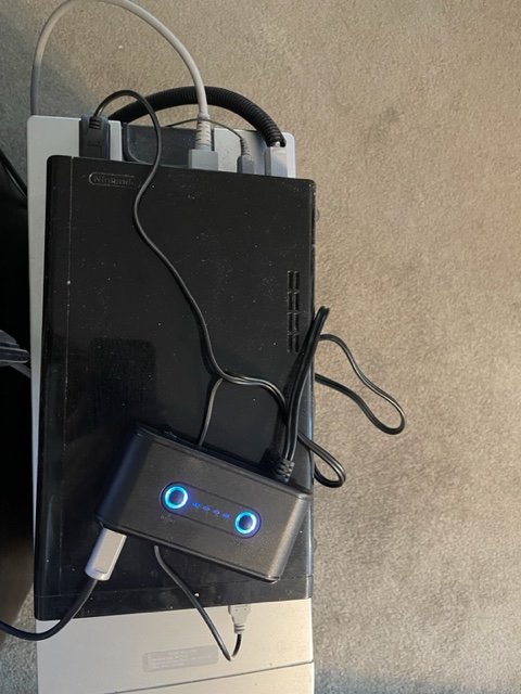

Yes the controller and adaptor are official Nintendo versions. I have both adaptor ends plugged in (data port in top back port, grey port in first front port). Native setting is off and greyed out. Controller is in first port in adaptor and I have confirmed it works with WiiU Smash game game and when working the LED above the controller port lights up. When I start Nintendont, the port LED does not come on. I even triend enabling first using the WiiU game before going into Nintendont and the LED stays lit but the controller still doesn't work.
Edit: Adaptor is third party. Is that the issue?
that is not an official adapter... the official adapters have no leds lol they are jsut black without any lights...
https://m.media-amazon.com/images/I/71M404KvsxL._SL1500_.jpg
your adapter wont work regardless of getting controllers.zip or not, its a fake/3rd party so you would need to make your very own controller.ini.
how do you even call it an official adapter with a straight face? lol did you ever even saw one? both switch or wiiu ones are just totally black no lights in any place and just say wiiu/switch on the top.

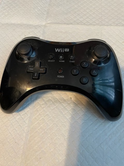

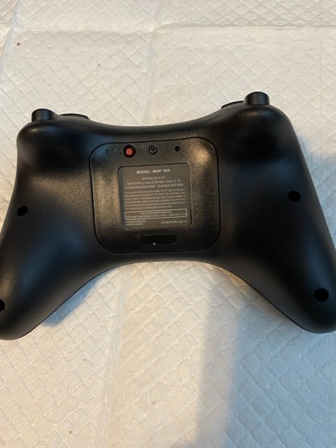

My WiiU Pro Controller doesn't have Nintendo logo stamped on on it either, but I dug out that box as well and cross-checked the model number (WUP-005) and yeah, its legit. I am not an expert at this or I wouldn't be asking for help. The Pro. controller just flashes four blue lights whether plugged into the rear USB port or not. Guessing there is a "wired" Pro controller version that I am unaware of as well. I did get a PS4 controller to work so I am sorry to blame the software for my ignorance.
just becuase a box is the same that doesnt make something official... if it doesnt say wiiu on top of the home and +/- button then its a fake controller...
so if i gave you a switch official box and putted a crappy looking chinese knockoff that doesnt say nintendo inside is it now an official switch console? because the box matched? lol
this is an official controller , also to make sure its official nintendo uses triwing screws instead of normal screws which means they only have 3 sides, if your controller has regular screws then its not made by nintendo
so yeah it cant sync with nintendont because its fake,only your gamepad works because its your only official controller it seems.
Looks to be legit. Fake label maybe? It looks like normal phillips scews. I am not a seller of this stuff, but I am not immune to getting scammed by fake shit. I guess when they learn to use Tri-Wing screws we are all fucked then.

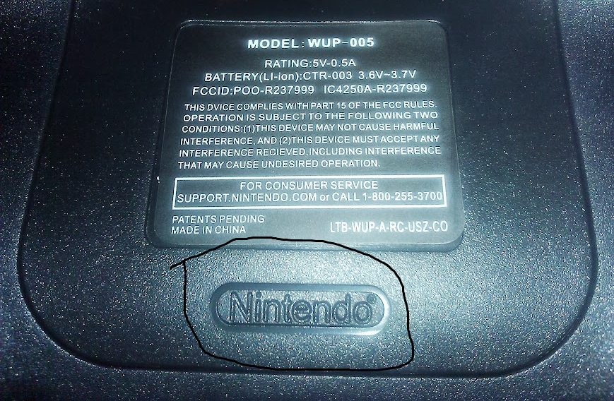

all fake controllers look legit also its missing the nintendo text under the label in the back, its 100% fake, the official ones say nintendo in the back plus triwings, the black space should say nintendo and it doesnt, there is fakes everywhere on aliexpress,ebay and such, only ones you buy yourself at retail stores are garanteed to be legit.
They got Nintendo imprint correct but couldn't spell "device" correctly, make you wonder. Been awhile since these have been available in an actual retail store. I hope the one I just ordered on Amazon is legit when it shows up later this week. Most of my older stuff was acquired second hand and I was just happy if it worked when I got it. Still cheaper than getting a Gamecube High-Def cable. Those things are outrageous. I stopped using mine when I found out how much it was worth.
