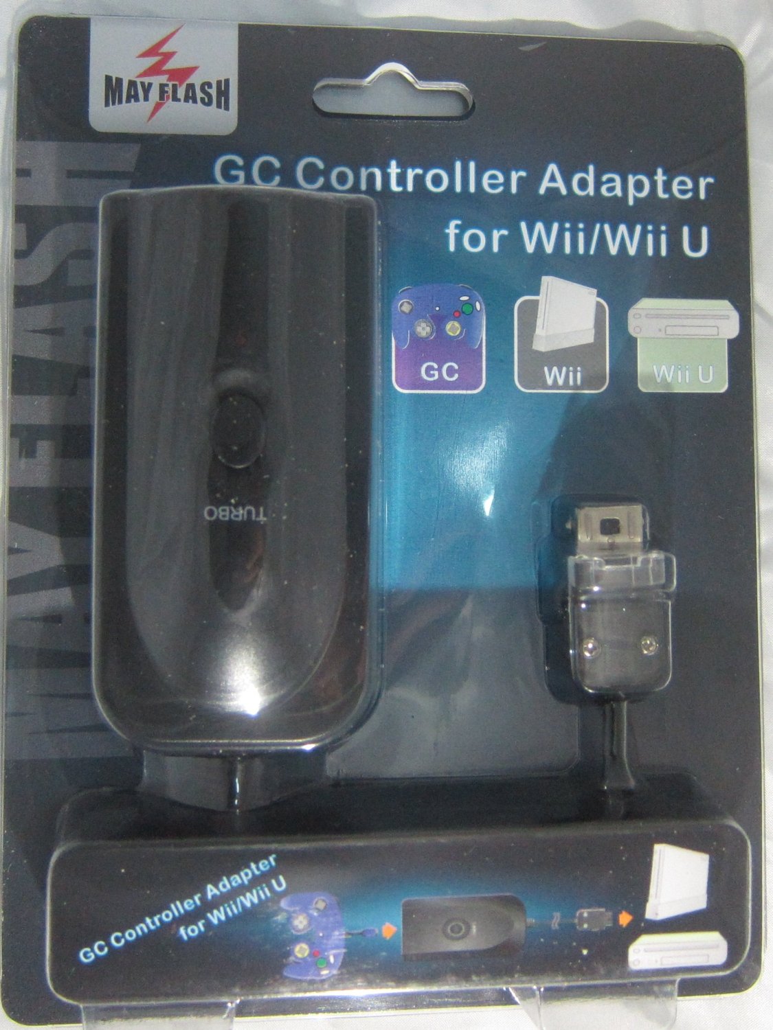

91QfeLRC5hL__SL1500_.jpg In the Repository have a configuration for this Mayflash Adapter controller ?
