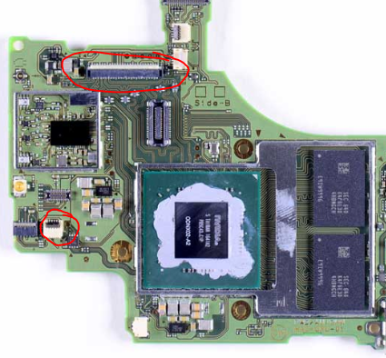

He damaged the LCD connector. It's a very fragile connector - I have personally damaged several. While it can be fixed, it's not for beginners.

Check back-light connection and LCD pins.
No matter how experienced you are with other electronics repair, there is always chance to bent pins in LCD connector due to terrible angle and tension by LCD cable, especially if you never worked with switch before.
If connectors are good, than most likely he damaged an LCD ribbon.
Does the screen lights up? if not take very bright light source and point on the screen, is there any image?
Nothing should rattle inside, probably your fiend didn't put rubber seal between touch and LCD because it's very tough one, try to move console side to side and see if LCD position changing(that will prove by theory)

For sure it will be the connector socket on the mainboard. At least one of connector's pin is bent.
You will need of a microscope or a good magnifying glass to see which one is/are bent.
But usually it will take less time to replace it by a new connector instead of trying to straighten the faulty pin(s)

Firstly i wouldn't guess, open a console and check.
Usually in LCD connector top row of pins get messt-up first, it's very easy to verify when LCD cable plugged in.
Check from the side where cable goes in, you will see row of pins if there is any inconsistency... connector needs replacement...

Backlight connector very hard to mess up, especially if you have some exp.
But again i wouldn't guess, mb he just forgot to plug it back in.
You have to open it up and see.
