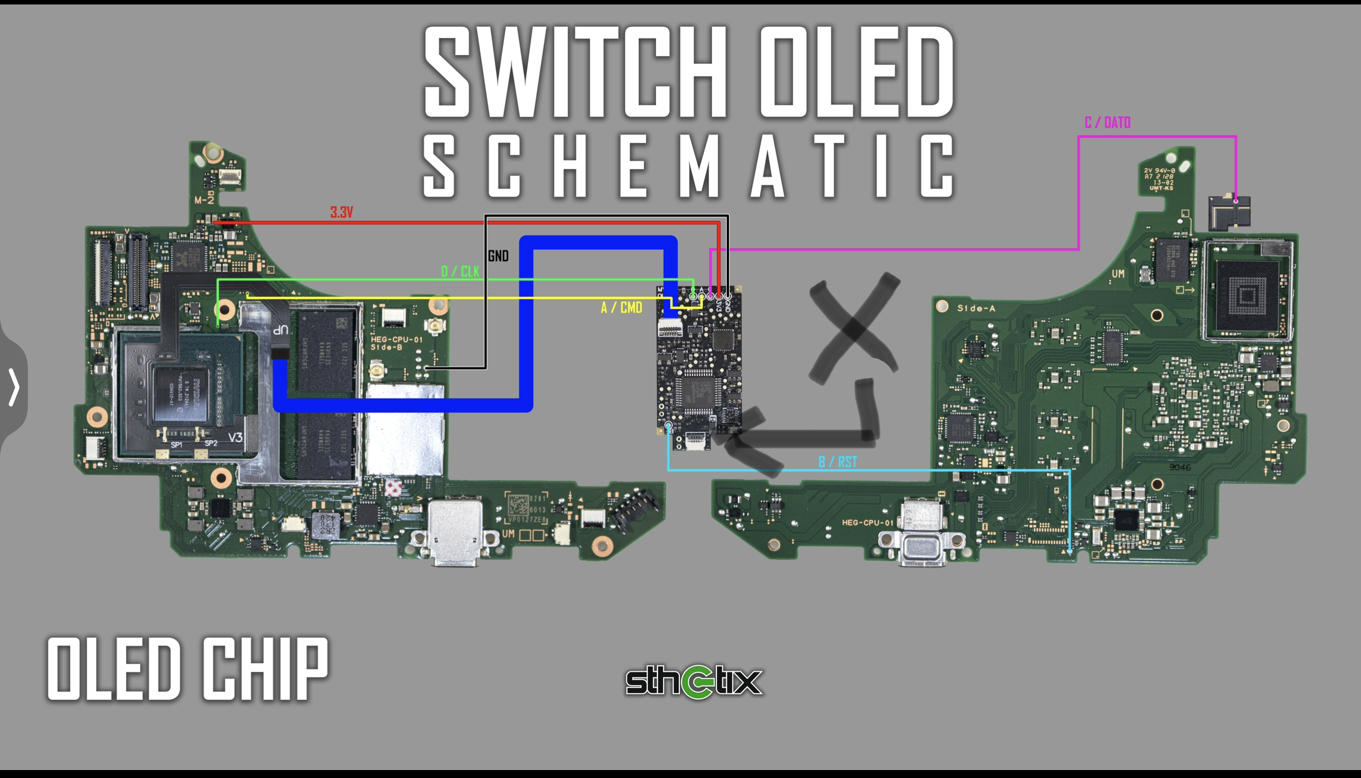

You will need to open up the back of your switch and take out the aluminum shield. There should be a USB port already attached. If not, then hopefully your installer handed you the adapter when he was done.
It needs to be plugged in to the white connecto at the bottom of the chip assembly. See attached drawing. I drew a black X with an arrow pointing to where the USB adaptor will be plugged in.
BE CAREFUL OF THE ORIENTATION OF THE USB ADAPTER.
you will break your chip if it;s upside down.
‘Send pictures if you are unsure.
Once you’ve got it plugged in, just follow the firmware upgrade steps in the firmware link above.

So I got the switch disassembled and I don't know which way to plug in the USB adapter the it says up on it is that the way I put it in?
The side saying "up" should be facing you. If you accidentally plug it in upside down it won't damage it though.
I plugged it in and it lit up and when I ran flash.bat it said No device detected! and then the lights stopped. What is going on with it and why did the lights stop?
