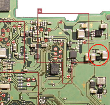

So I replaced the thermal paste and still, it has the same problem, I also checked the cable to the motherboard, reseated it.
Is the M92 chip also related to the fan? I thought it was only for the charging part.
Also the temps are max 42-43c while playing zelda
check mainboard back side if this area has any damage
