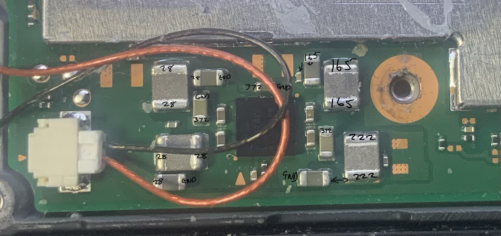

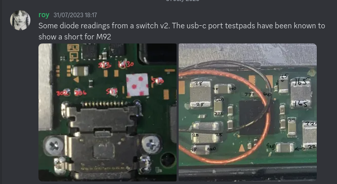

Yes multimeter is here. Do you have and instructions for me where i should start with the measurement?
This is for the Switch v1, but probably roughly the same. Poke around the M92 and P13USB.
Took them from Joey Does Tech's Discord.
Here are some for V2
  • switch-diode.zip
