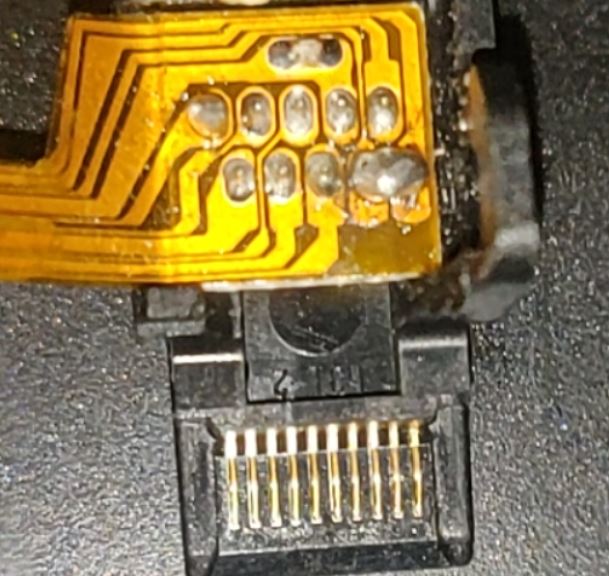

Hello,
My Switch is definitely jail breakable. I've checked the serial against the spreadsheet.
I bought a jig and attempted to use that to boot into RCM, that didn't work. So I had an extra rail and I soldered pins 9 and 10 together. But this still doesn't work. I'm using Windows 10. I'm using Tegra RCM. I've held the Power + Volume button but it just doesn't boot. If I hold the power it will boot, but not with the volume + Yeah, I formatted my SD card to FAT32 and put the atmosphere on there.

I added an image here. Could you tell me if this is an alright set up? Pins 9 and 10 soldered. Yeah, tried different USB cable, but no luck.

Not sure I never soldered any pins, I just bought a jig for $2 on Ebay. You just put it in the rail and you can enter RCM by hitting power and +.
Someone else will probably know.
The jig shorts pin 1 and 10. I did try running a wire from pin 1 to 10 but no luck there. I don't think I have to solder the actual pins (Ones at the bottom) as this will get the same result I believe.
Do you think it's the PC? I could try my laptop, but i doubt that would achieve anything.
If your screen remains black after the combo, you're in rcm. Have you installed the driver on your computer?

So it remains black. But Tegra RCM doesn't say anything like what it does in the tutorial vidoes (RCM OK) there's no way for me to inject the payload as the button isn't activated (inject payload is a light grey colour).
What driver are you referring to? No tutorial said to install one, maybe that's the problem. Could you link me it please
It's in TegraRCMGUI, settings > install driver.

That was it lol? 5 hours soldering and making sure there wans't any sloder joints. Wow, just wow. Cheers for the help dude
