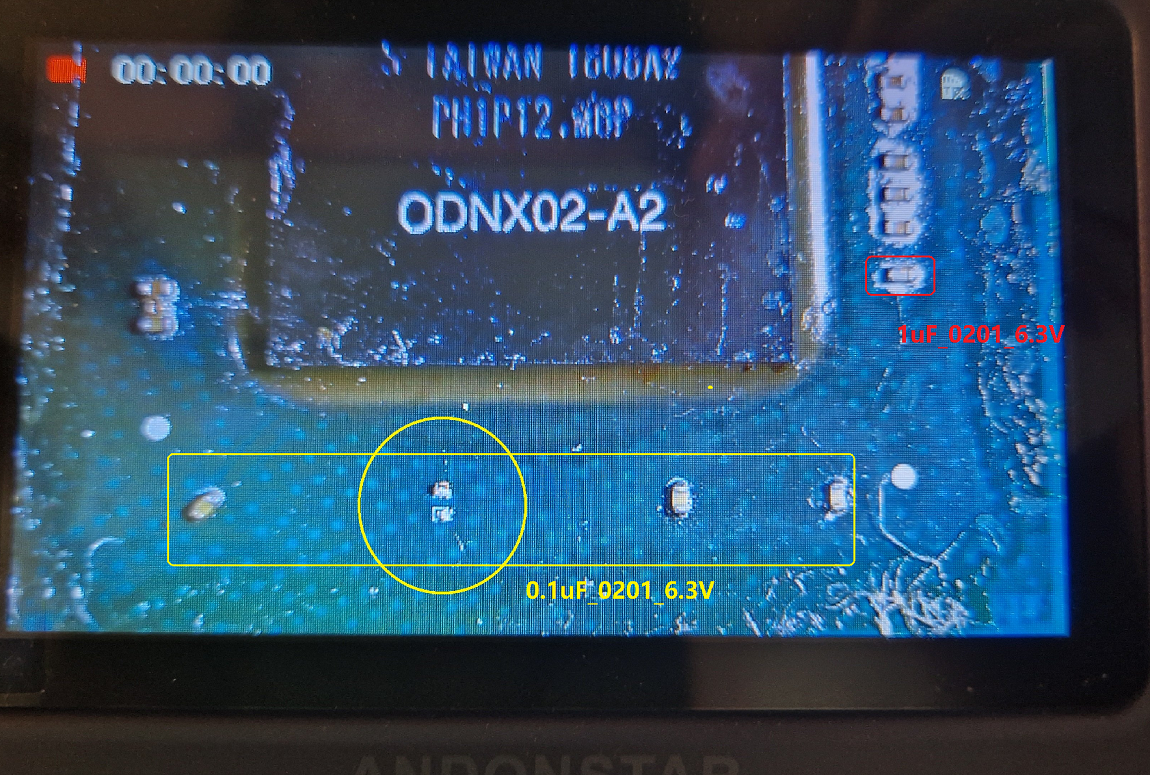

Hi there, as I was reballing a switch apu today, I somehow managed to send a cap to the ninth dimension. It is nowhere to be found.
Anyway, I really need the help of you guys to help me identify the right values for this cap.
Thanks :)
So all of those caps are the same value? Because there are some posts online stating that they are 0,1 µF and some others (like you) say it is 1 µF.
Ok, thank you. So can I just use one of the PS5 HDMI Caps? I have enough of those here. They are 100 nF @ 10 V and are also 0201 size
