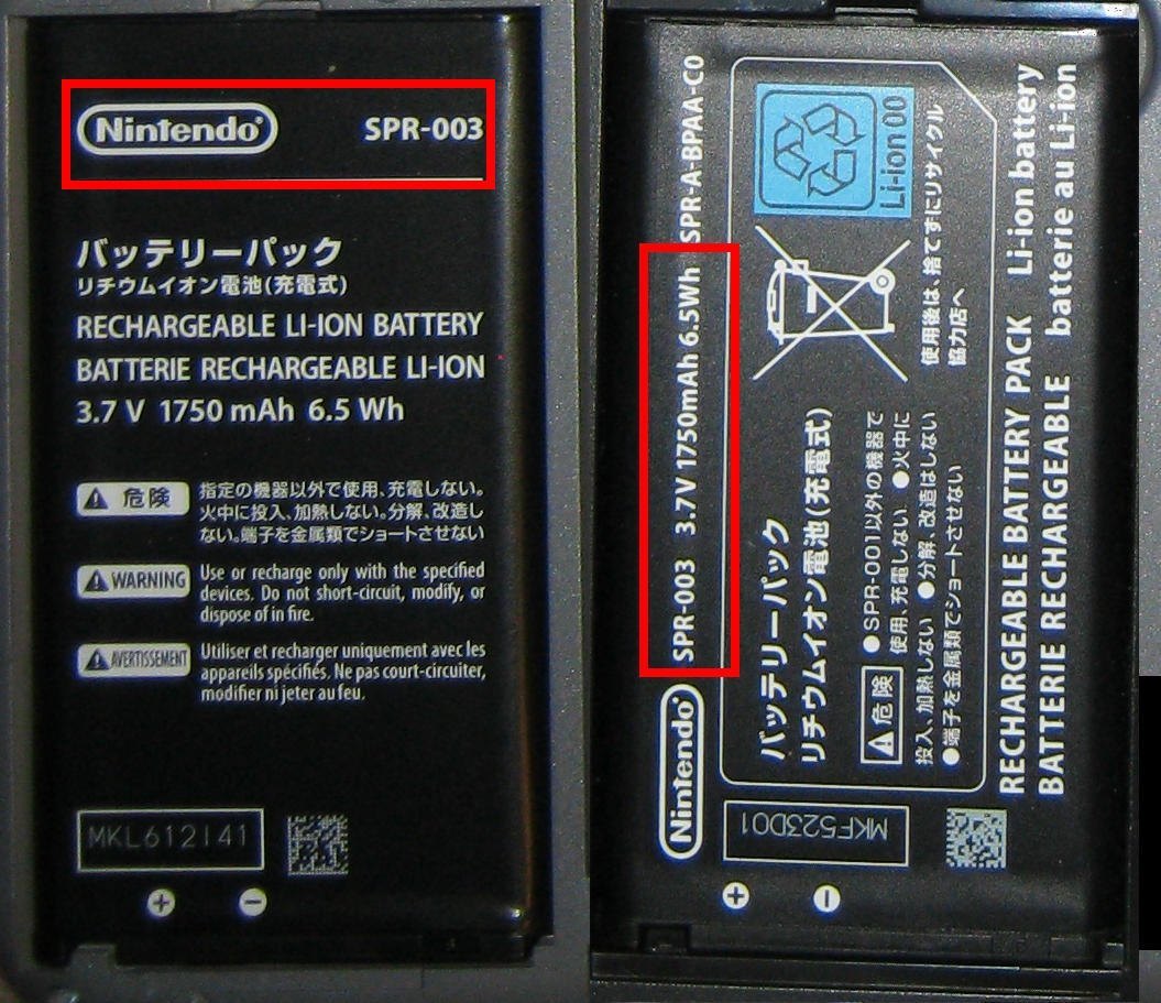

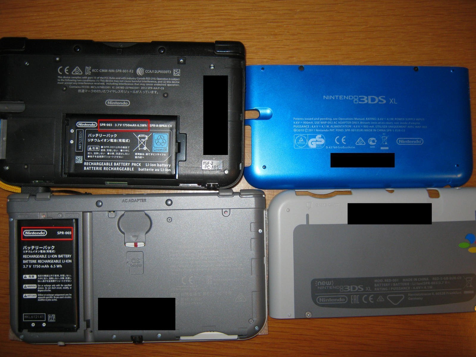

I don’t think it’s a fake. The battery on the left has printed KRT-003 on it.
KTR-001 is the New 3DS NOT XL.
Both the O3DSXL(SPR-001) and N3DSXL (RED-001) have the battery SPR-003:

@KleinesSinchen is correct that the SPR-003 shown on the right is legitimate Nintendo battery.
However @VyacheslavV95 , your new 3DS (n3DS) can't use that as correct battery modle is KTR-003. The SPR-003 is for o3DSXL and o3DSXL.

You are may be correct and may be not. Because on Nintendo Store page it says that 1750 mAh SPR-003 battery is New Nintendo 3DS XL and (old) Nintendo 3DS XL compatible unless I misunderstood something. Look carefully at my Nintendo Store page screenshot please and see it for yourself. Or is it mistake on Nintendo side? Could be too as well. I wanna make sure, because if those batteries are, by any chance, replaceable with each other, then it could be good chance for me to extend my Nintendo N3DS XL battery life without risking my money on 'overinflated capacity' battery mockups from chinese manufacturers.
P.S.: Although last is more likely, because, as I can see on KleinesSinchen photos of both batteries side-by-side, they appear to be of slightly different form and size.

Your first photo, the one on the left with the filename img_20181018_180207-jpg shows a battery named KTR-003. If this is a picture taken from your 3DS, you have a new 3DS. NOT a new 3DSXL. The battery from the shop screenshot on the right will not fit. Look at the back cover of your device. There should be written "<new> Nintendo 3DS" on it. No XL.
My batteries are the same size and fully interchangeable and both genuine Nintendo parts – because I bought both 3DS systems new and never changed the batteries. It’s just different text and different text orientation. I don’t want to open the covers again especially the new 3DSXL SNES edition, so I just moved parts of the picture. It looks bad, but you can see they are the same size and shape.
If your battery is not worn out and therefore has extremely short running time, you will probably not find a better one (with really much higher energy density).

Oh, ok... I see now... It looks like I actually bought regular New Nintendo 3DS instead of XL. That's odd. Because I clearly remember searching specifically for XL model. Seems like I was fooled by seller. Surprised I didn't noticed this earlier. If I would do so upon receiving this console in my local mail department, I could have saved myself a lot of money. Money which I feel are wasted now. Thank you guys for clearing this out. And I already ordered myself New 3DS XL Hori potective films... Such a shame. It's a really big chunk of money where I live.
