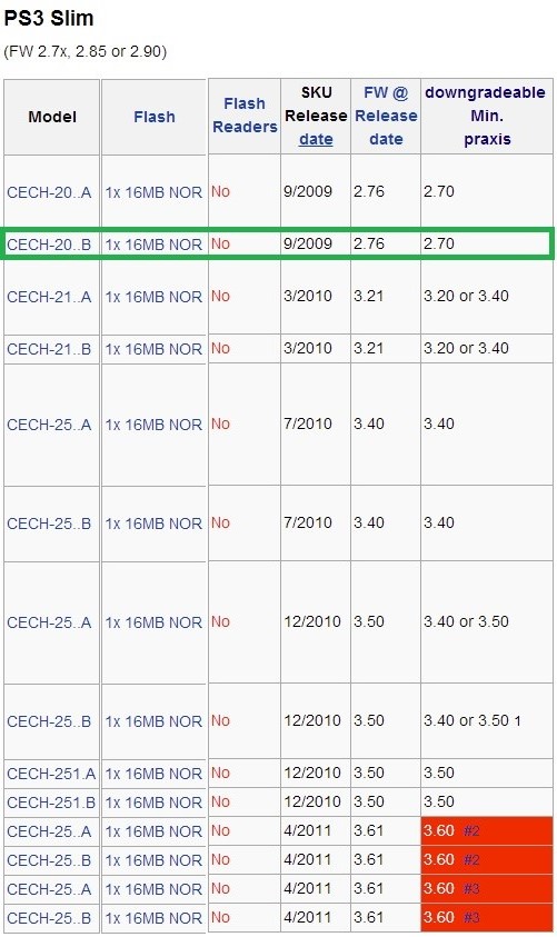

    So, I just got a PS3 Slim (CECH-20XX) which has OFW 4.81 on it. I ran the Firmware Checker, and it said I can Downgrade to 2.70 or Later. So, now I am just wondering what to do next.
    My PS3 Slim CECH-2001B.
    Every Guide I see says I would need to connect to the Internet in order to do the Hacking. So I am wondering......
    Which Method is Preferred?
    Can I get Rebug Installed in any Method?
    I take it I might need to Update to 4.84 in order to do any Method, right?
    I'm going to be needing to have a PSN already Setup, huh?

    You need to (1) update to 4.82 (or the 4.84/82 hybrid), typically via USB; (2) do the appropriate version of the PS3Xploit NOR flash writer, USB or HDD variant at your choice (which typically is done online, though you can self-host if you really want to), and (3) install, again from USB, the CFW of your choice
    Yes, the consequence of the flash writer (with the appropriate .hex file) is that the console accepts a CFW (of equal or newer system version) as update; there's no difference on whether you do the exploit on 4.82 or 4.84/82 if you want a 4.84 CFW (and once you get a CFW, you can enable the "QA flag" with an appropriate homebrew, to enable downgrades even if you return to OFW)
    You don't need a PSN account for the procedure, you may be thinking of the HAN method (which works on all consoles but gives you significantly less freedom than CFW and HEN)
