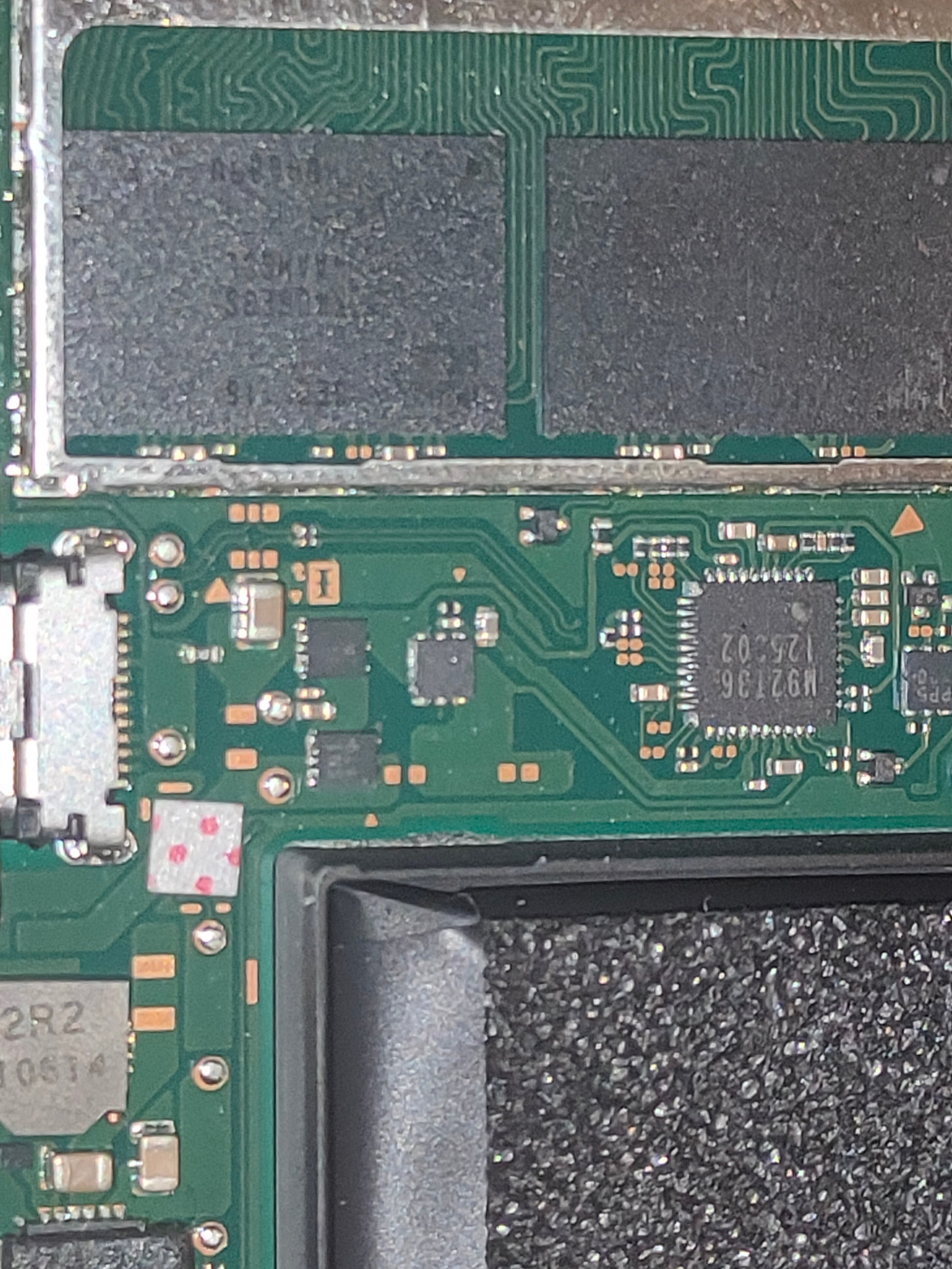

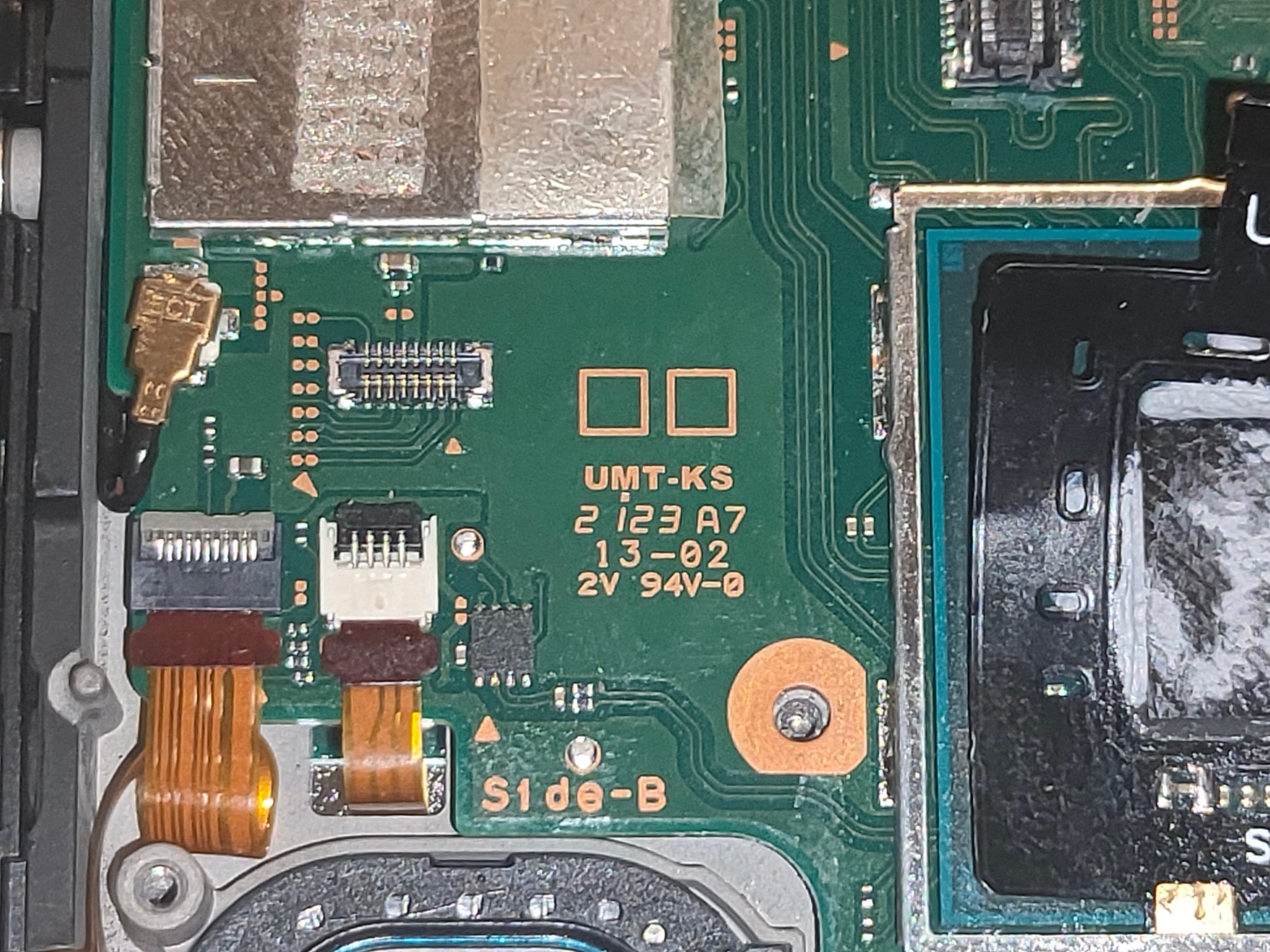

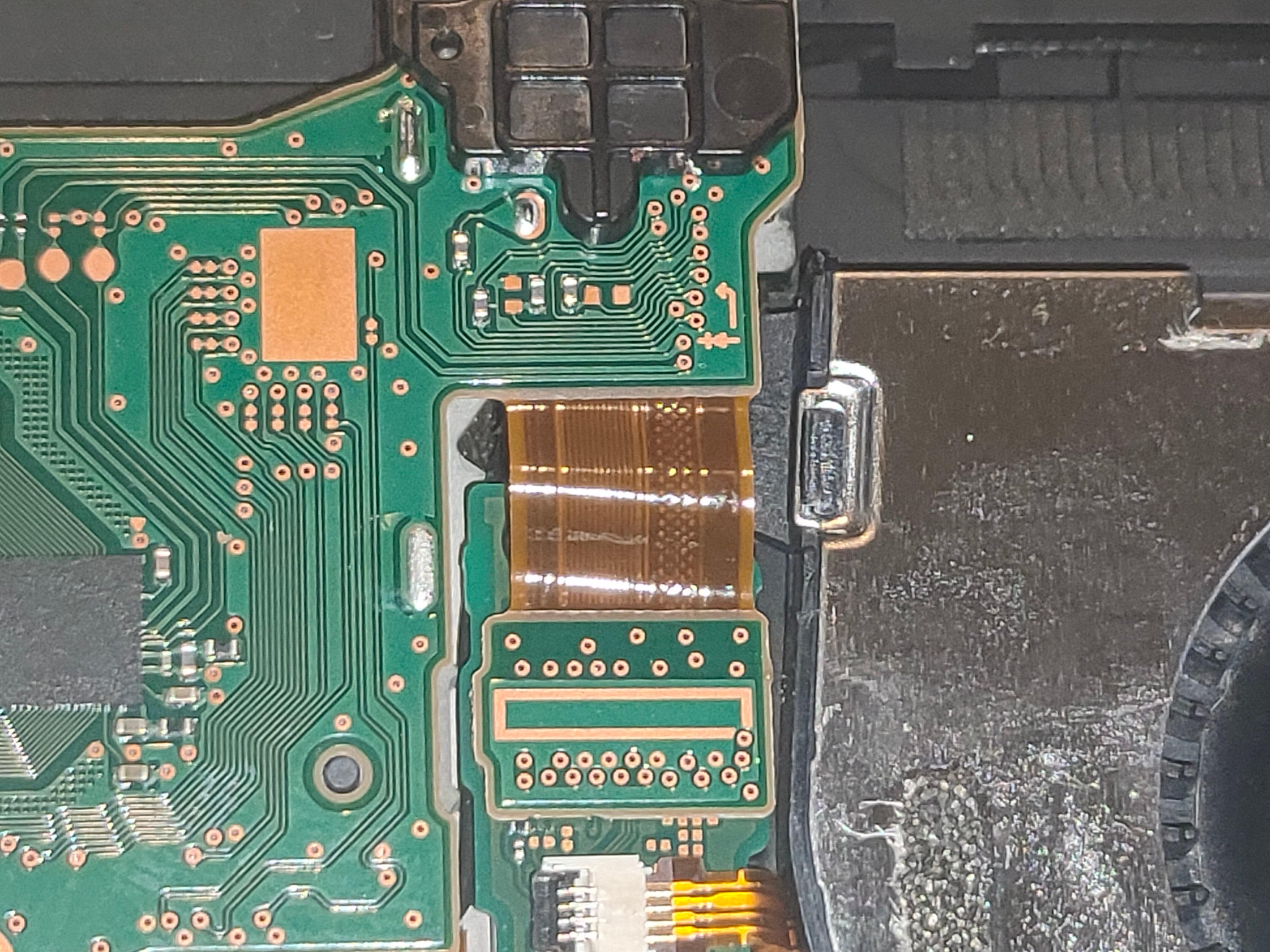

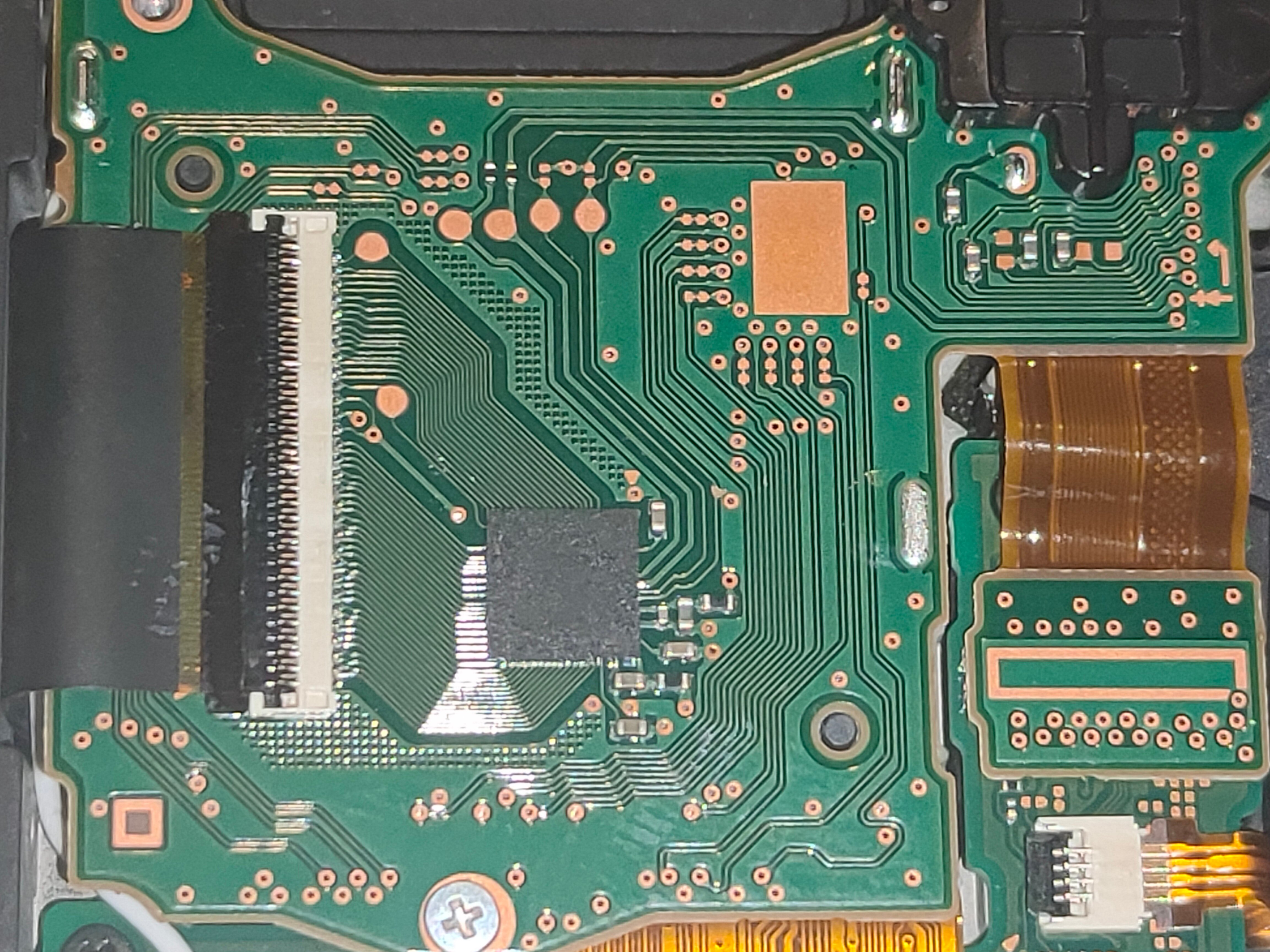

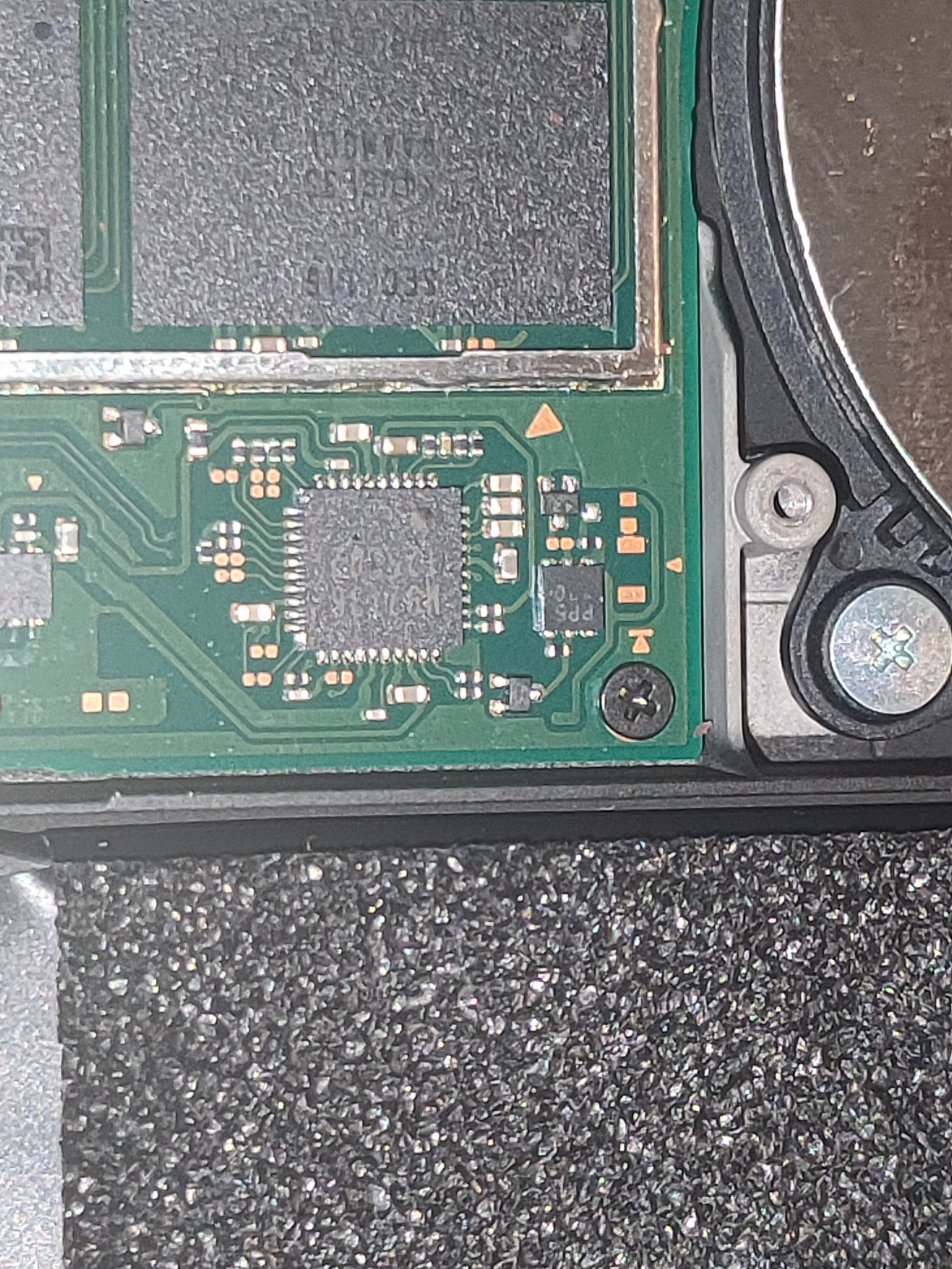

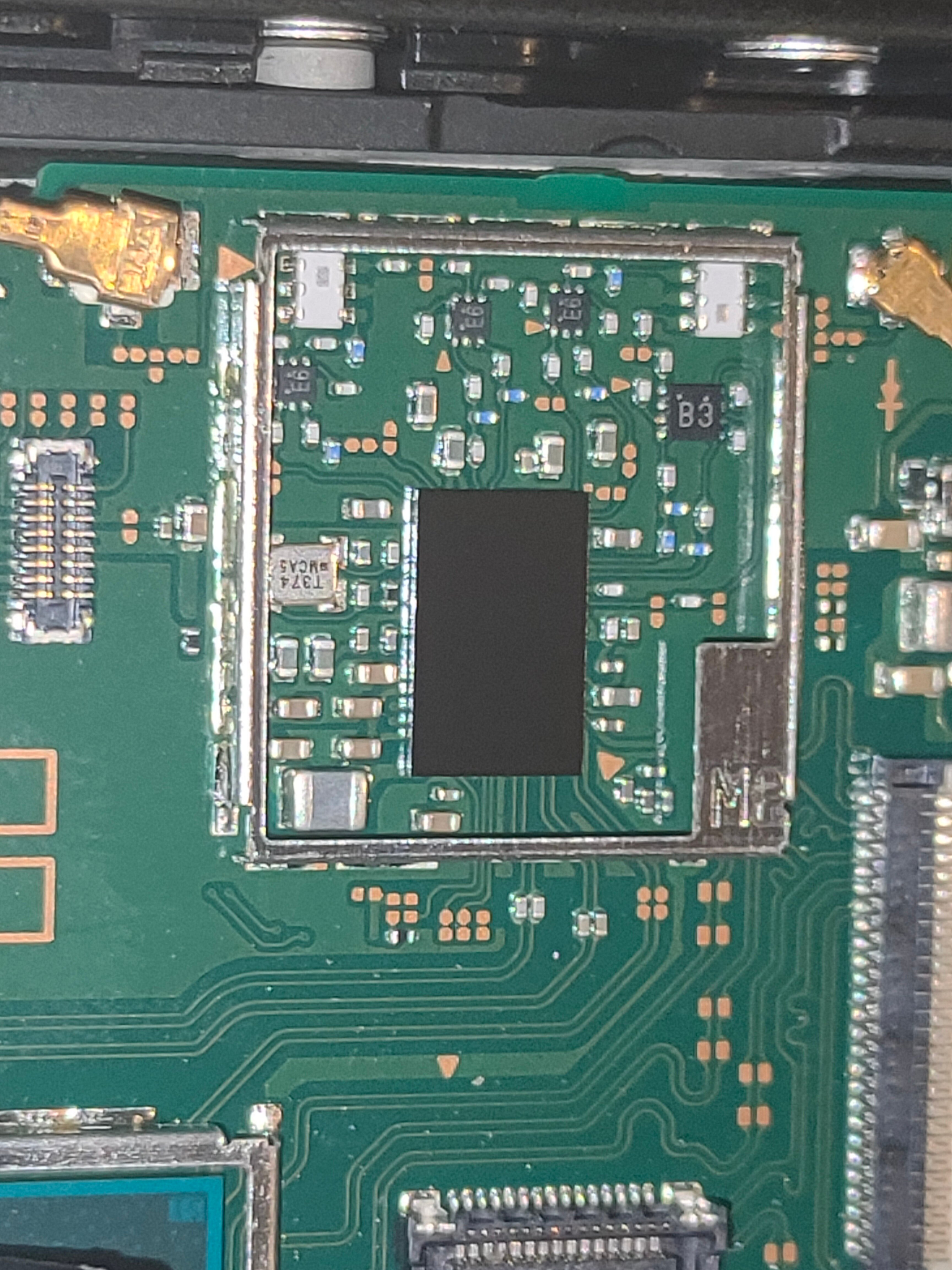

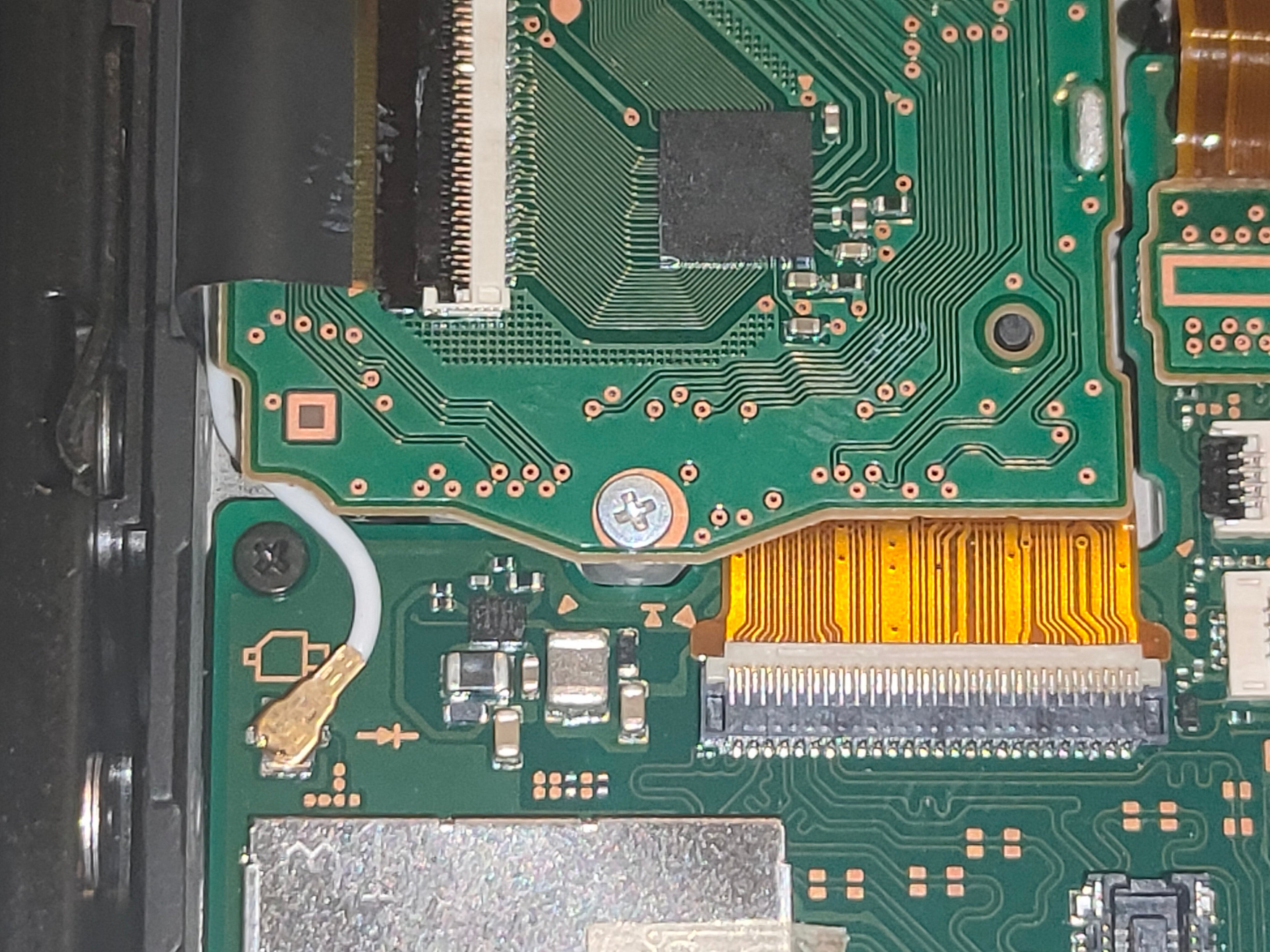

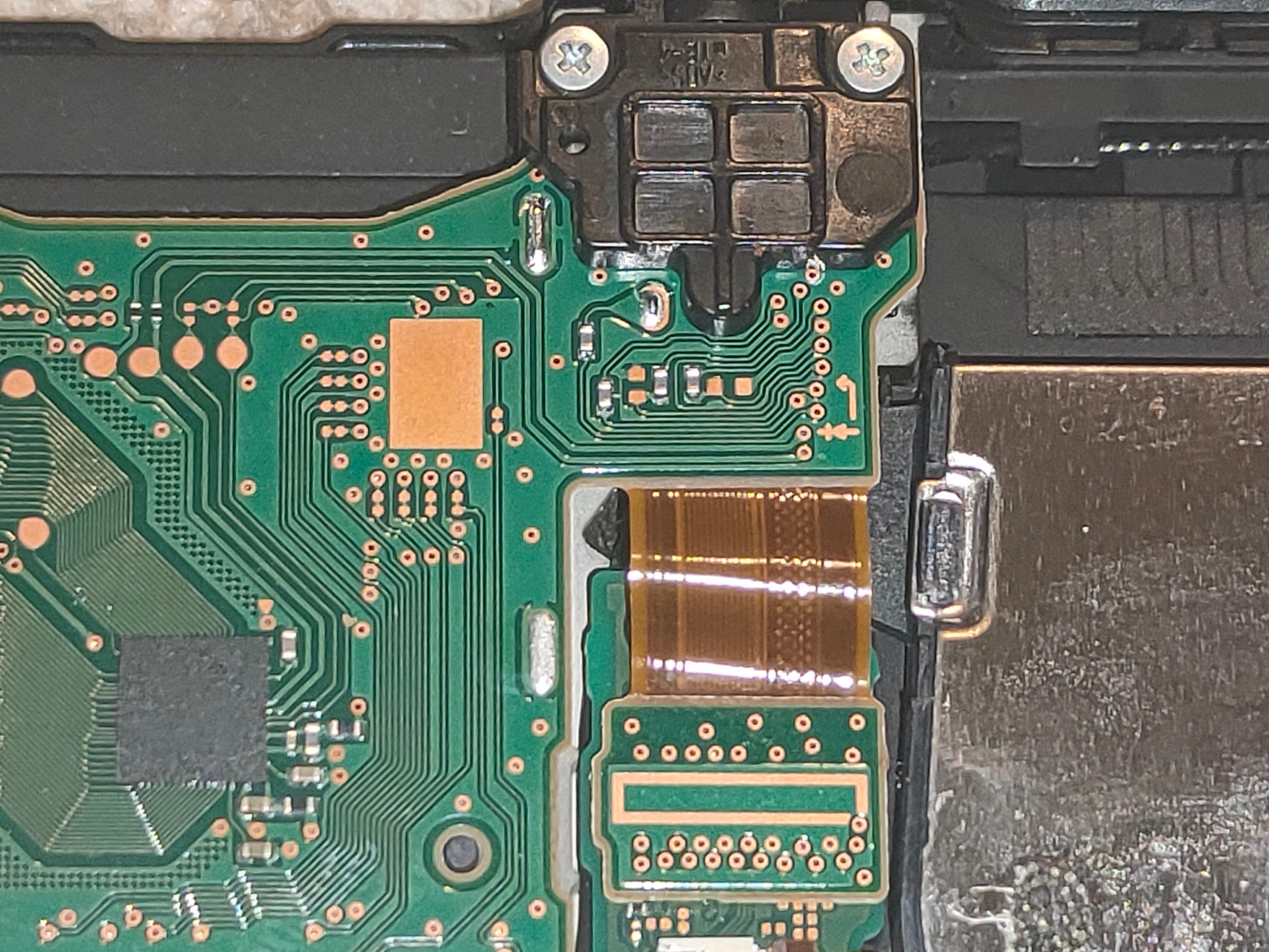

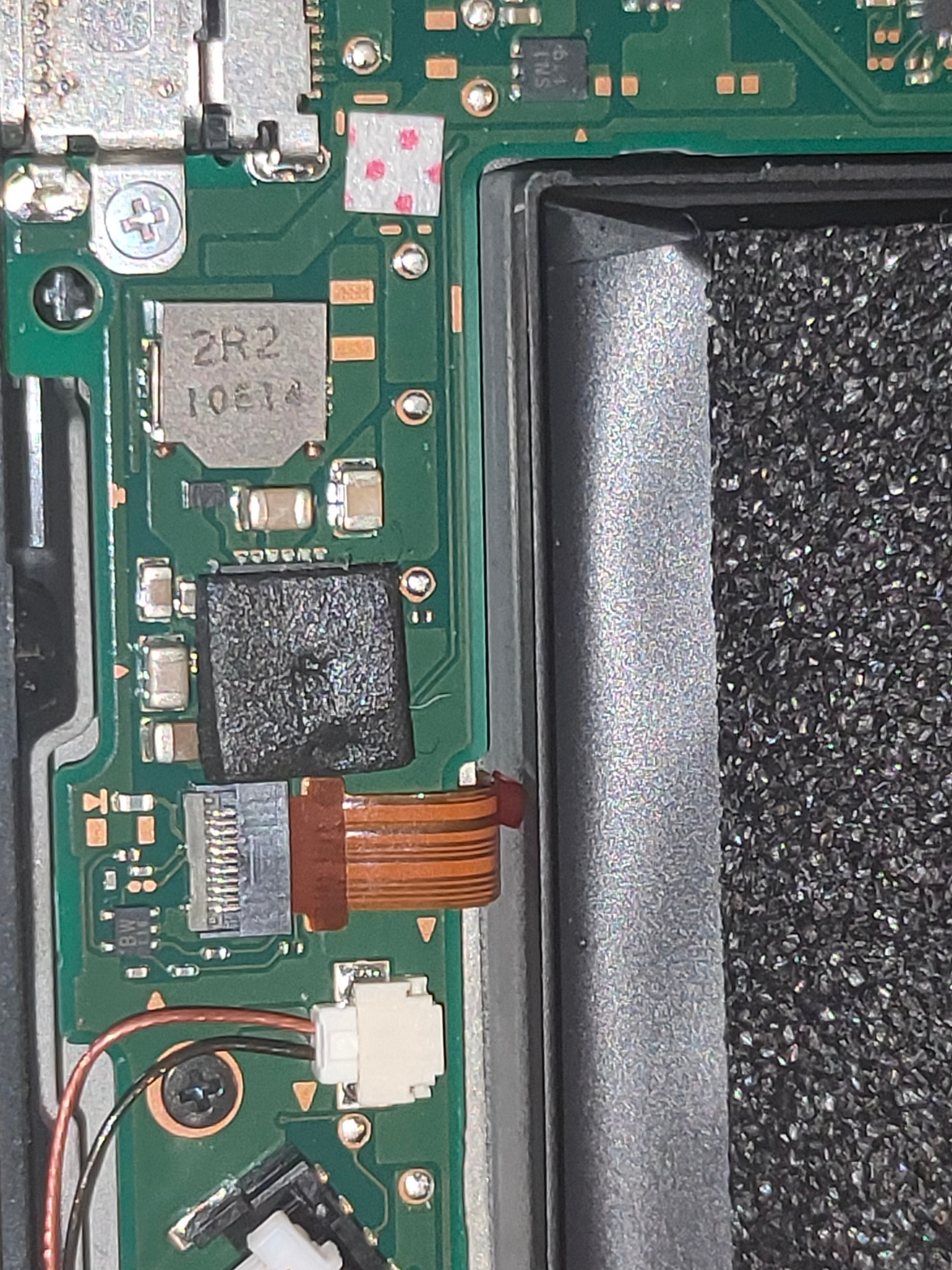

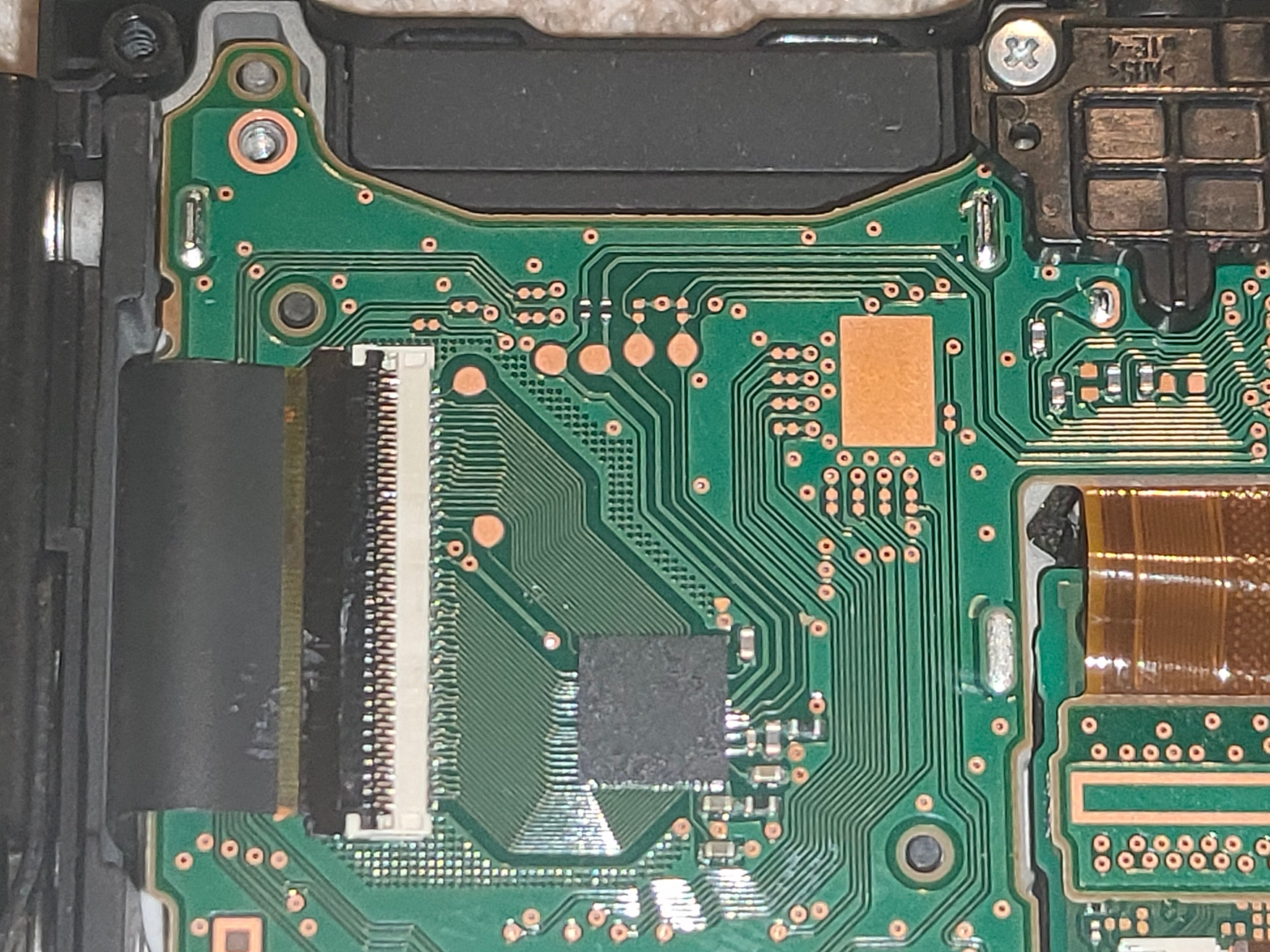

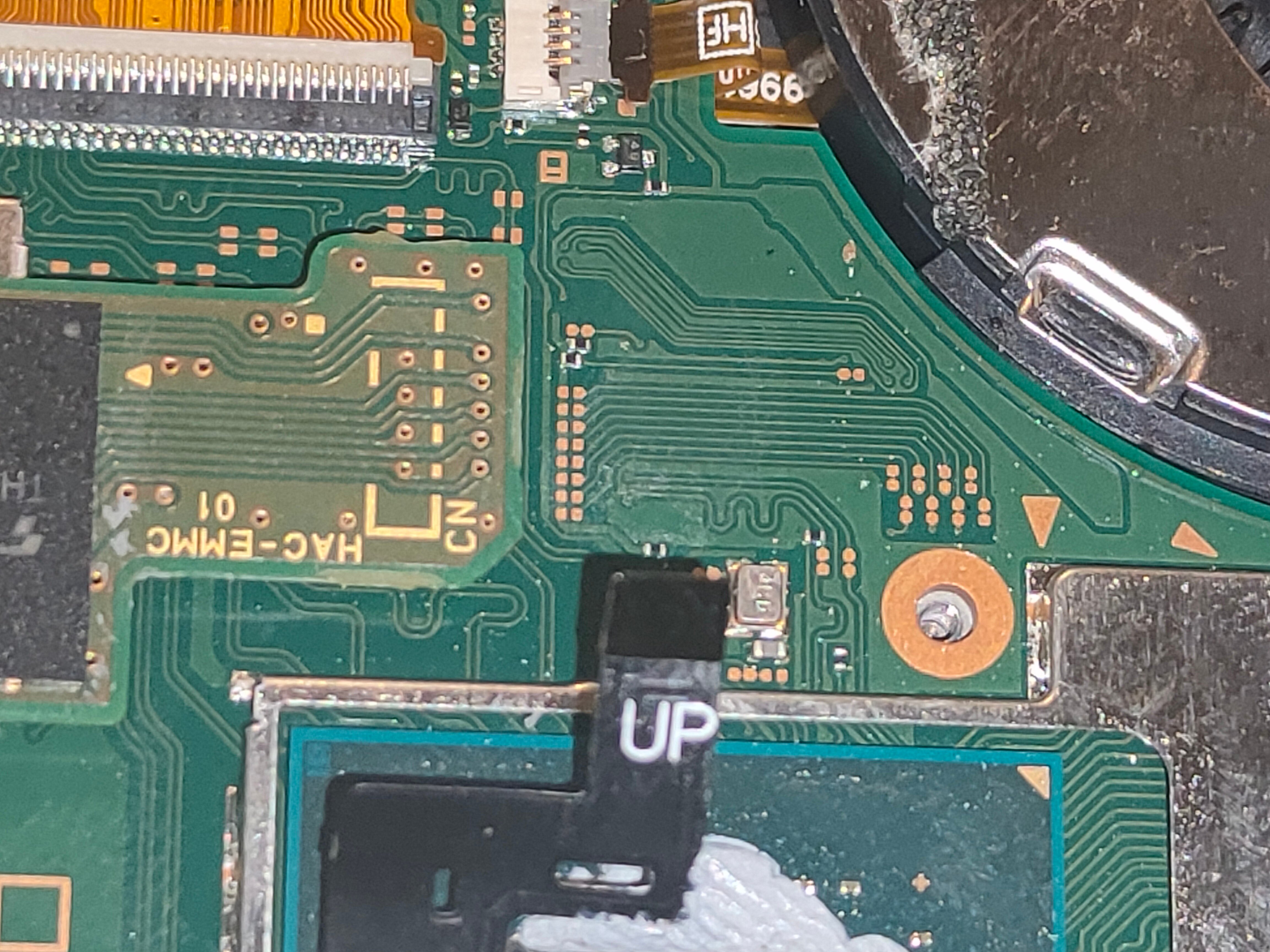

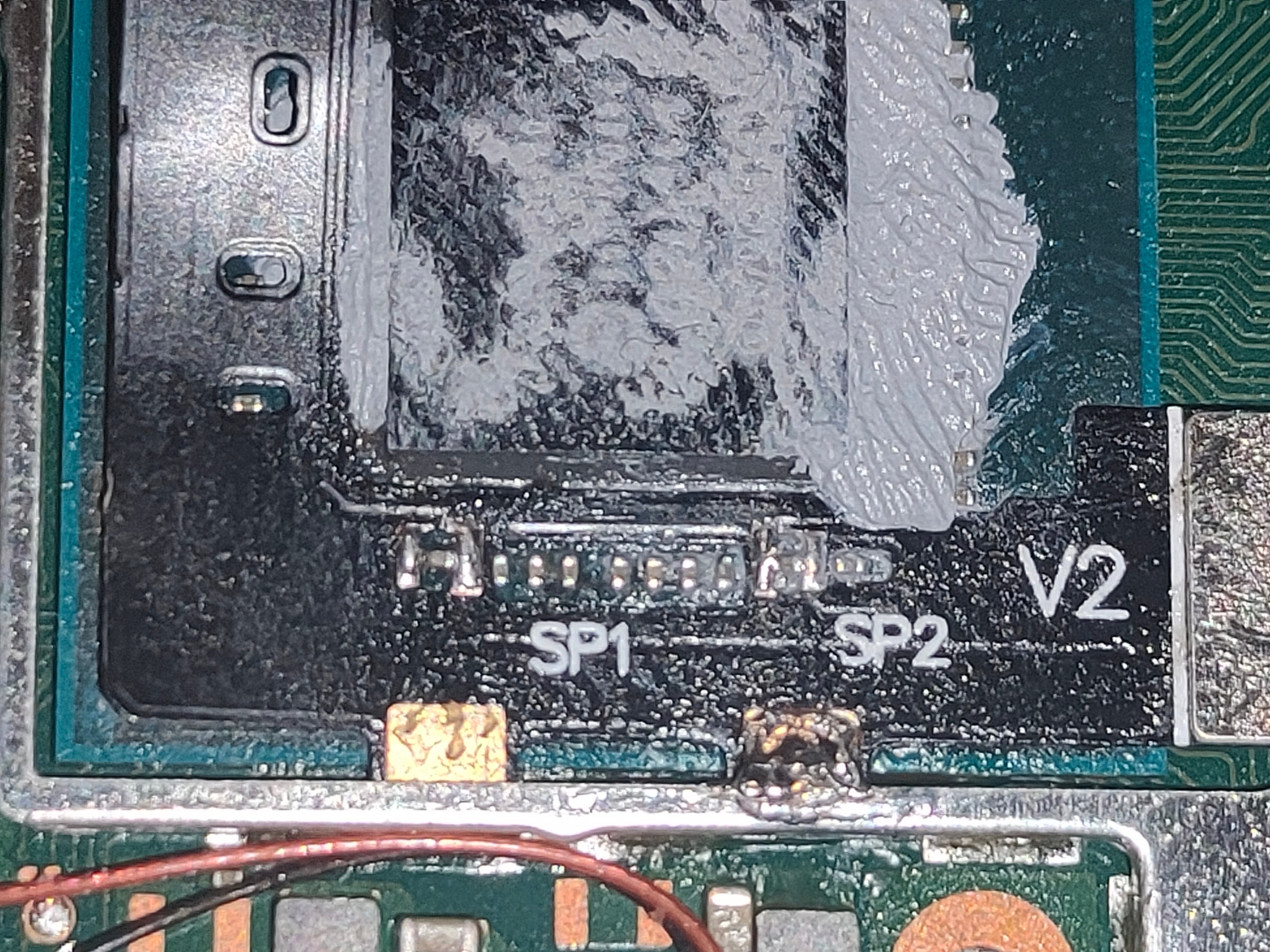

Here are some pictures. And an update:
I left it for a few hours and connected back the eMMC. It booted normally when it got to the lock screen the touchscreen, vol and power button seemed unresponsive. I removed the battery to power off. Then I powered on again, the Nintendo logo managed to show up and then black screen. I will try to update with some photos.
I measured the resistance. Across the ends of sp1,2 9.5-10.5 ohms. Sp1 right side 10 left 0.5, Sp2 right 0.5 left 10

I replied on my post with an update. I tried pushing in the ram and no change. I left it for some hours and connected the eMMC back. It booted normally on the lock screen and no touch or buttons. Turned off through battery. Then turned on again. Only the Nintendo logo and then black screen. After power on again black screen
